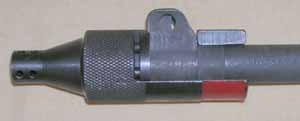

    Here is the European BFA. They have been around since the 1970's. I have several hundred of them but have severe restrictions on how they are purchased, for safety reasons.

    Quote Originally Posted by Bill Ricca View Post
    That's what mine looks like, it has a date of '54 or '58 on it and what looks to be a Danishicon crest.
    Nice to know what it actually was, never got the chance to ask my Dad.

    All were 1958, as can barely been seen.
