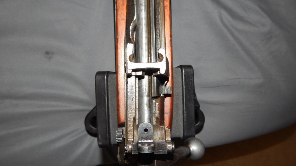

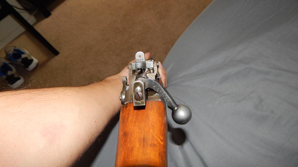

    just when i think i've asked them all, more questions make themselves apparent.
    question 1:
    down the left side of the top of the receiver on my 6/42 Fazakerley made No.4 Mk.1 is stamped "SYK"; any ideas what that means?
    question 2:
    the bolt on it matches the serial number on the left wrist band. but preceding the serial number on the bolt appears to be a Savage "S". i know Savage made barrels for the UK in the early stages of the war when the Luftwaffe was destroying factories in Englandicon (this rifle has a 2 groove barrel that is one of those), so my question is, did the US make and supply bolts too?

    Yep, Savage supplied bolts as spare/replacement parts. They were immediately recognisable as they were always (?) a pale grey finish and came in a pinky/red greased cloth wrapper which meant that they had to be rinsed in the warm trichlorethylene bath to get the thick grease off. I shoud add that this wasn't just bolts but most other parts too

    lol, even http://www.leeenfieldrifleassociation.org.uk/ can't give me a solid answer as to the "SYK" on my receiver. they said it could have been anyone at anytime.
