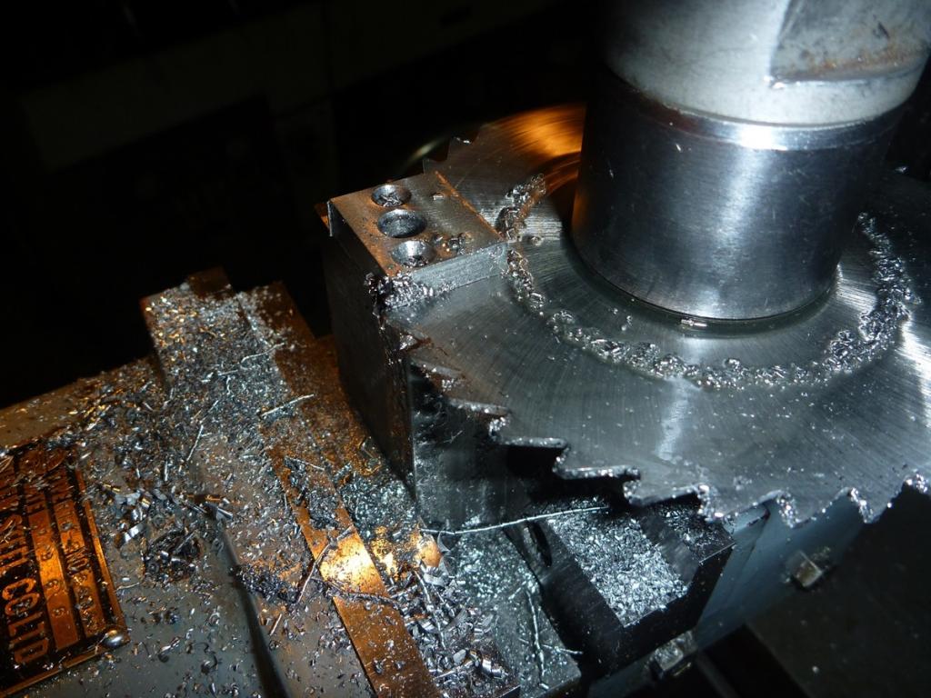

    Hi everyone,
    currently have a few projects on the go @ the moment, one of which will be something like an L42 when complete.

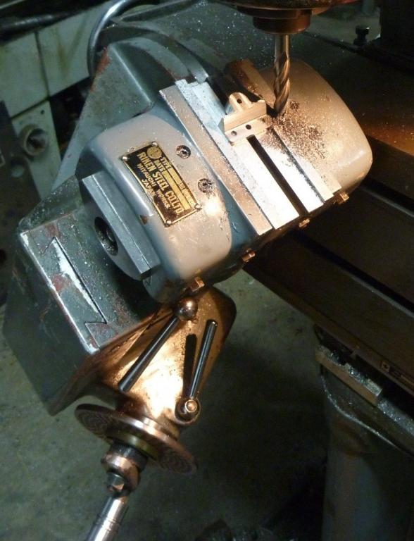

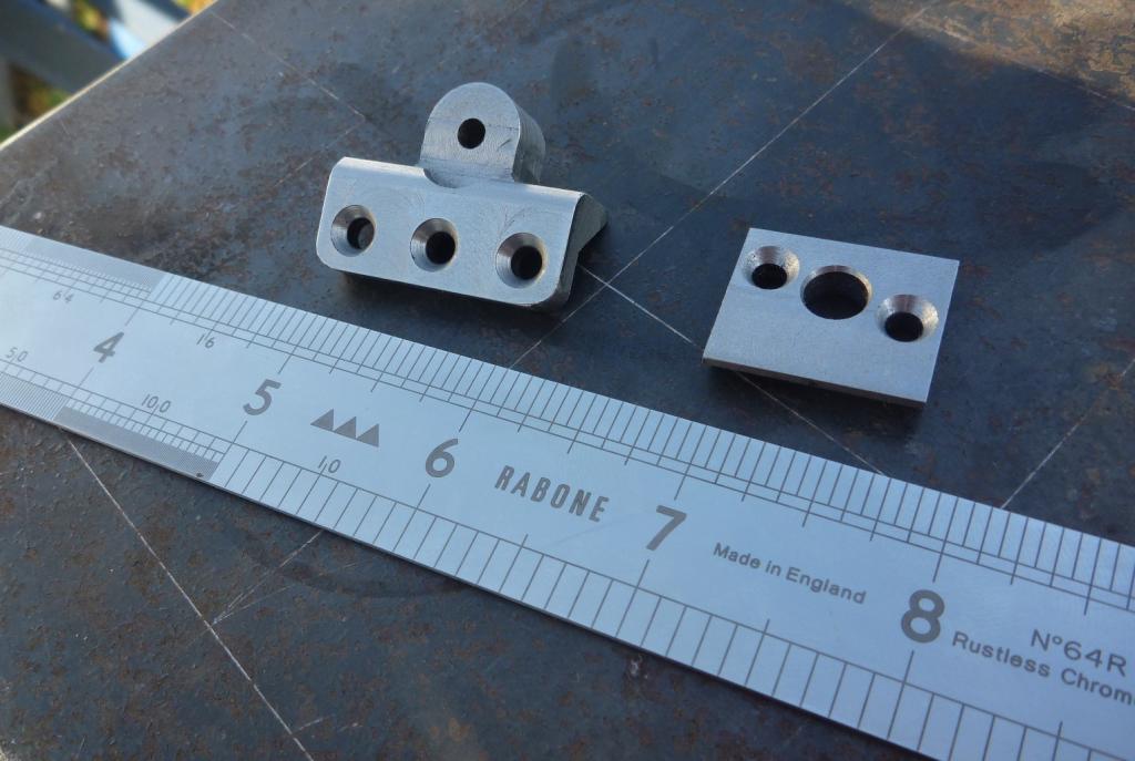

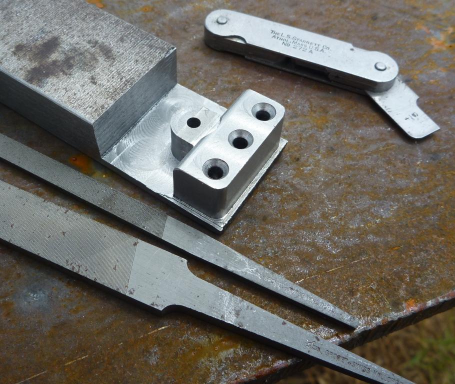

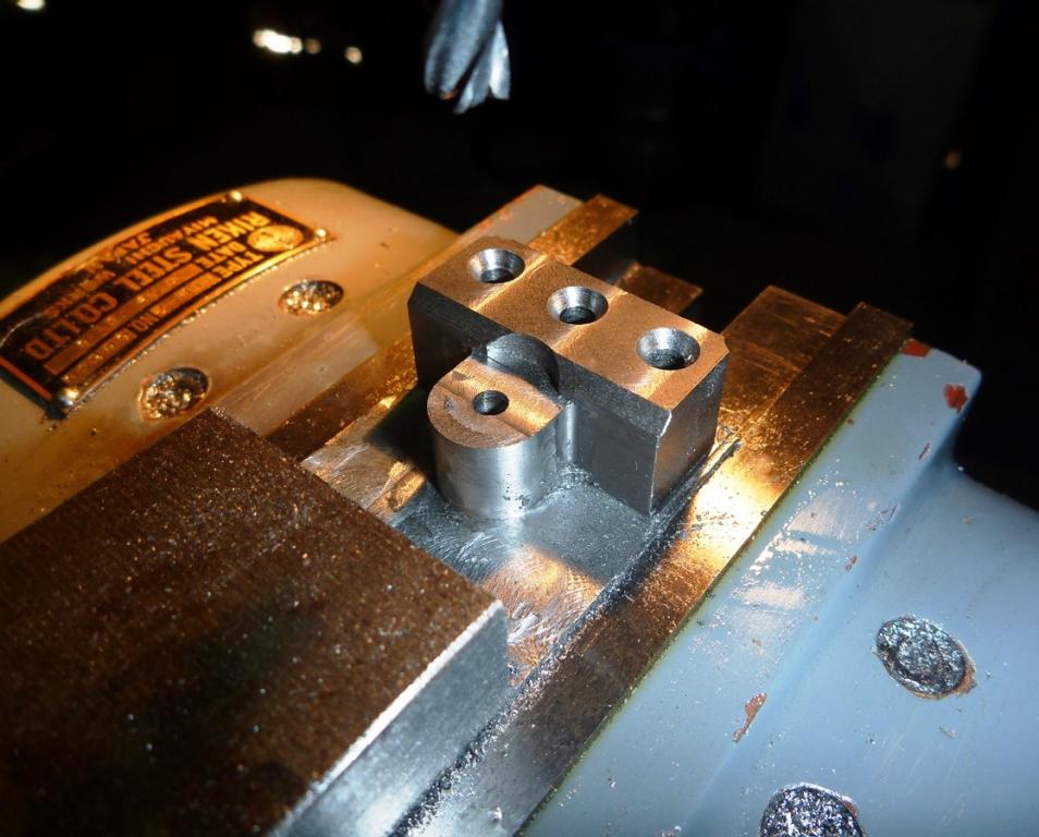

    I wasn't game to run the risk of getting repro pre-machined pads with insufficient material left to allow proper collimation - so I made my own blanks and will go about the H&H method of installing the pads and then machining the mating features, insitu relative to the bore axis.

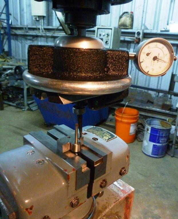

    I know the H&H front pad blanks, wouldn't have been piloted - however in my instance it became necessary so as to give me reference point to dial indicate off when it was flipped over to machine the backside. The pilot hole is well undersize that required for 1/4 BSF
    I've got a few questions though;

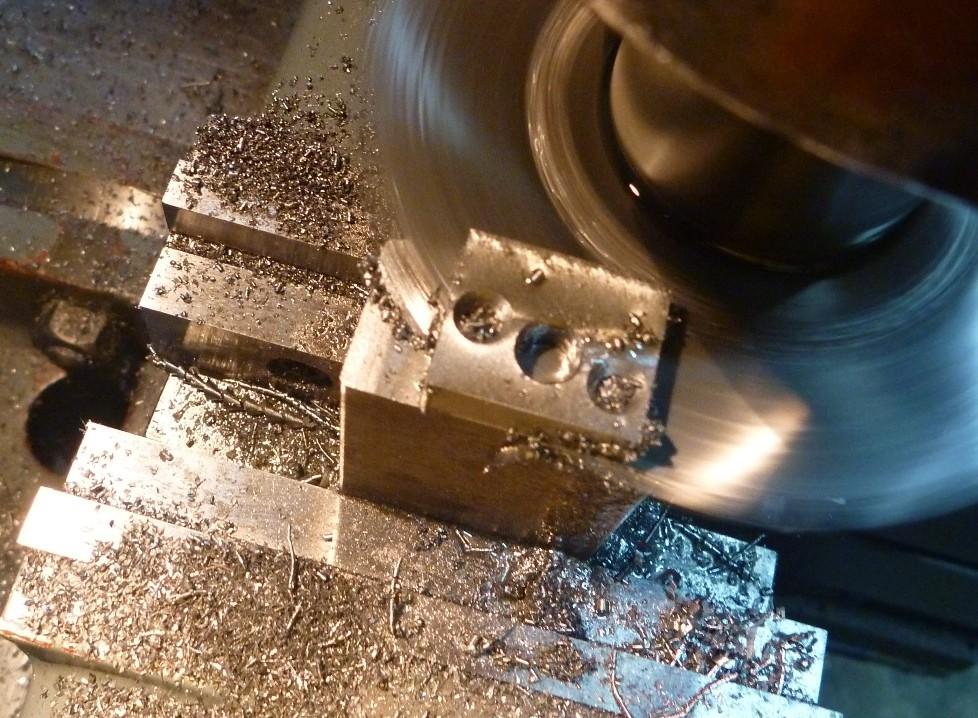

    #Does anyone know where I'd find a shell mill .600" in Dia x .370 inside diameter to machine the spigot with? Had considered using the boring head on the milling machine, however there's very tight space limitations to OD turn the spigot which would call for an absolutely miniscule boring bar. So am thinking that plunging the shell mill as per the H&H method is the way to go, its just finding one which is proving difficult.

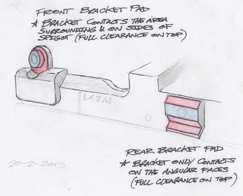

    #Also I've had a good look at the drawings in the Knowledge Libraryicon and have a mental picture of how all the mating features of the pads & brackets should come together. Just wanting to know if my interpretation of those drawings is correct (see below v)
    Any info would be most appreciated

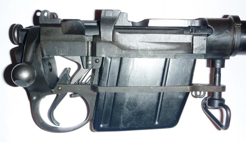

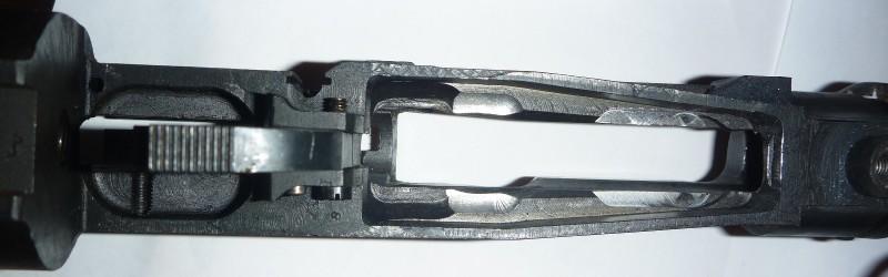

    Also a few pics of the rsaf enfield mag fitted to the action. In this instance it was necessary to machine the body to clear the rear feed lips (I've read sometimes it isn't required)

    Seems like you really have made a mountain out of a molehill there Brian! Mind you with all those facilities....... We often used to encounter sheared-off spigots from the front pads of L42 rifles caused by the additional rotational forces of the 7.62mm rounds against the moments of the bracket. Just insert an accurately made sleeve into the front pad as illustrated in the little H&H book and this will cure your need for the shell mill cutter. The perfect fit of the pad spigot into the corresponding opening in the bracket is critical for one of the woprkshop inspection stages.

    I applaud your efforts to do the job as close as possible to the H&H method! Probably going to have to fabricate a shell milling cutter. Could do one yourself if you have tool steel and heat treat, but it's a fiddle-y job.
    Thinking that modifying a spot facing/counter boring tool may be the easiest way out, but you may have to have the ID EDM'd to size. OD isn't a bother.

    The turning of the spigot as a seperate insert, certainly alleviates the need for a shell mill and I'd suggest offers a higher level of control over the O.D. rather than just plunging and accepting the resulting spigot (whether that still be within tolerance or not). The concerning thing about a shell mill may be the potential for it to wander whilst plunging, given it would be fairly heavily engaged on one side. - will ponder that one a little longer.

    JMoore, I've got some silver steel of the right size and a tempering oven etc so making a shell mill isn't out of the question - and your right the outside diameter isn't critical +/-.
    Just have to make sure to make sure it behaves and the ID cuts a resulting spigot within that tight .369-.370" tolerance band @ .120" deep.
    Also spotted a few dimensional errors with the freshened up drawings in the Knowledge Libraryicon, so will submit a few corrections once I've finished working through it all.

    Re the front bracket spigot. To save all the shell-mill palava and making an insert, you could just mill the spigot radially by rotating the pad about the axis of the bracket screw hole
