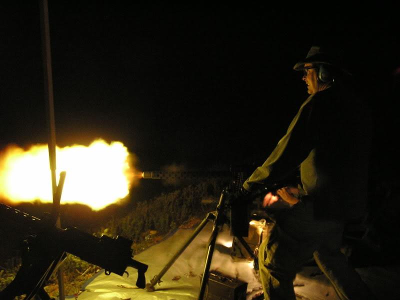

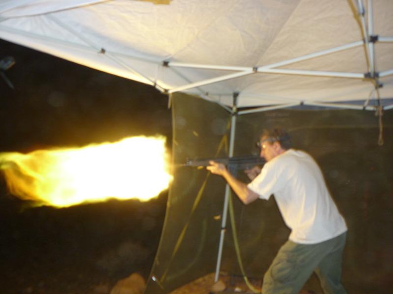

    It also provides an excellent muzzle flash at machine gun shoots and is quite impressive in a .308 G3-Kurz.....
    Here is the 1919A4.......43 grains H335...147gr tracer......(41-44)(Hodgdon)
    Here is the H&K G3 Kurz.......Same load as the A4......43gr H335.....(41-44)(Hodgdon)
    It tends to give your position away at night though.....
