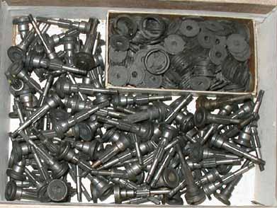

    Pinion Drums are almost impossible to find.
    I have approximately 150 sets of replacements parts, all needing drums and I have been looking since the early 1970's. Found none. The most likely reason is they were all used up by the military. It is the weak point in the Pinion Assembly, it breaks.

    I had over a 100 spindles, drums, and retaining washers, but I'm down to about 15 at this point and still looking. About the only drums I know of that may be found will come from the Danishicon parts that were brought into the US, most were marked PB or VAR. The Danes did have a part number for the drum, spindle, and retaining washer and the tool set to repair the elevation assembly.
