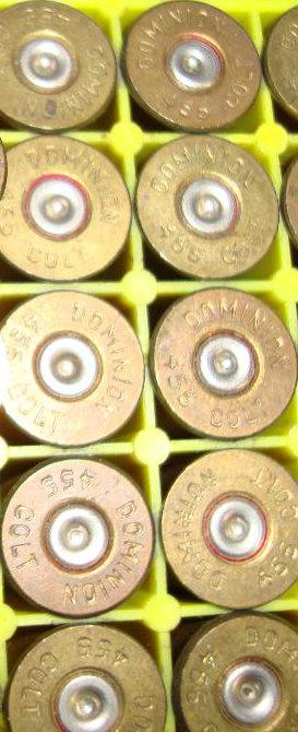

    Photos:
    "Lots" of Fiocchi .455 Mk.II on hand, but only the one box of Dominion in .455 Colt:

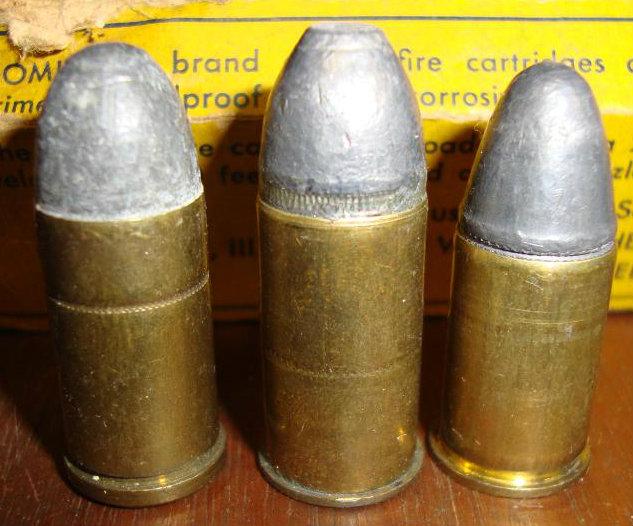

    L to R- .45 Auto Rim, .455 Colt with a WW bullet seated out fairly long, and a factory .455 Mk.II Fiocchi:
    No pressure signs in the primer area at all! I've seen empty cased rounds fired that distort the primer more (in rifles).:
