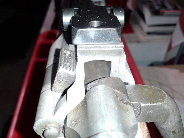

    Building a mock Sniper, mainly for hunting.
    So I level the receiver and set the mount level & straight on the receiver ring and the Leupold mount sets off a bit on one side at the rear bridge.
    any ideas ?

    As long as it places the scope's axis directly over the bore's axis I wouldn't worry about it none.

    The receiver bridge on the 03A3/A4 is not symetical. Just remove the bolt and do your best to make sure the holes are on the centerline of the receiver. if you can get access to one of the Forster sight mounting jigs even better. Don't worry aoubt how it looks from the rear. Just make sure both (or all three) mounting holes are straight and dead on the receiver center line. You have to use exist holes (guard screws, trigger ) as reference points.

    its supposed to be offset,
    the rear bridge is not center.
    drill center of the rifle, not center of the bridge,,,or you will be sorry
