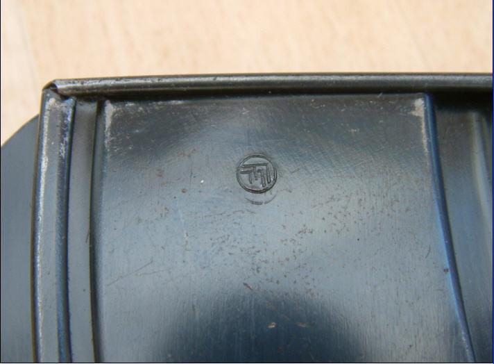

    Some items will be found that have the Fianna Fáil over lapped FF mark.
    An example on a Bren mag below -
    ATB Kevin

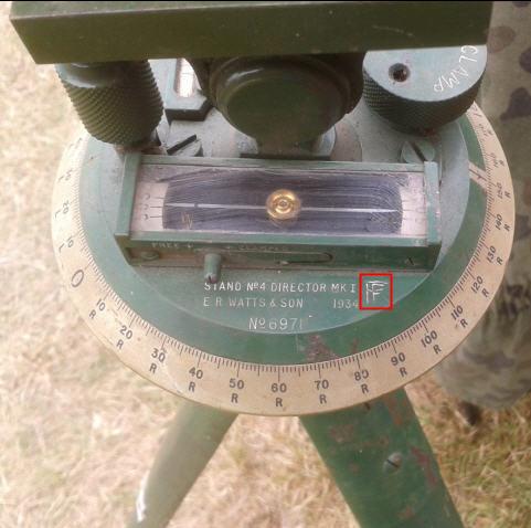

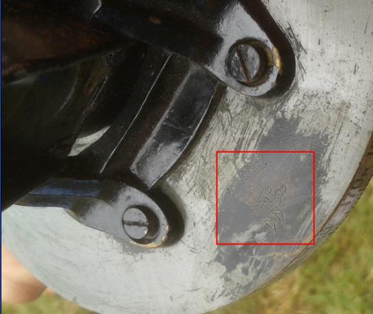

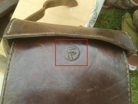

    I'm not too sure the FF Fianna Fáil ownership mark can be cited as being administered to everything but does show up frequently up to the late 30's on equipment.
    Some examples below in different fonts/designs.
    Other items such as tables,chairs and shirts are also noted.
