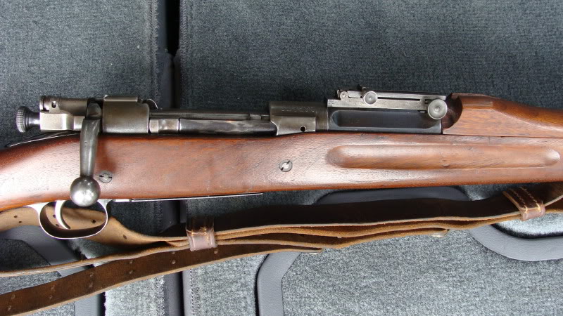

    My friend picked-up this rifle today. You'll have to pardon the back ground. I shot the pictures in the back of his van.
    He is interested to know how much is original based upon the pictures, epsecially the stock. As you can see it is a double-lugged, finger groove stock. It has a W.E.S. cartouche with the eagle head stamp next to it. It is not marked RI on the end of the stock. SA perhaps? It has very nice bore on the 10-18 dated R.I.A barrel. The sling is dated 1918. Any help or information will be appreciated and will be passed along.
    Mike
    Oct 2008
    01-24-2025 @ 10:45 PM
    Sweet Home Alabama
    1,098
    04-27-2025
    12:42 PM
    The rifle is a parts queen.
    The stock is from a 1918 Springfield Armory rifle. The trigger is from a pre-1911 rifle. The magazine cutoff is from a pre-WWI rifle. The Rear Sight Fixed Base appears to be a replacement. The receiver and bolt sleeve are refinished. The rear sight is a replacement. The handguard is a clever fake.
    And that's just what I can see. I'm confident that what I can't see is equally mixed.
    Hope this helps.
    J.B.

    John,
    Thanks for the reply. I know that he's gonna be a little disappointed, but that's the chance he took when he traded for it. I know he doesn't have a whole lot in it ($450), so that might soften the blow a little.
    Thanks again!
    Mike

    Quote Originally Posted by tinbender View Post
    John,
    Thanks again!
    Mike
    If he only has $450 in it, then he has no grounds to complain or feel shortchanged. The rifle is an outstanding buy at that price. If it were any nicer, he would be guilty of a criminal act!
    J.B.
