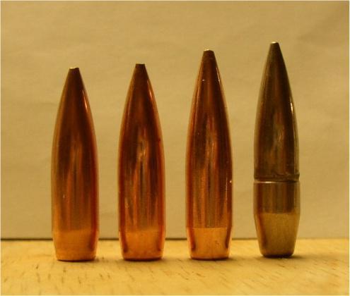

    I would like to see a GP11 bullet profile compared to the others.
    From what I can tell, it seems to be fatter not longer, LD type. Probably will pull one out so I can see it.
    Maybe put it on the coppier with the Nossler and Sierra 175 and see what I get.
    Ehh, don't bother...
    Various 175 gr .308 bullets compared to the GP11 projectile
    Sierra MK, Nosler CC, Barnes MB, GP11
