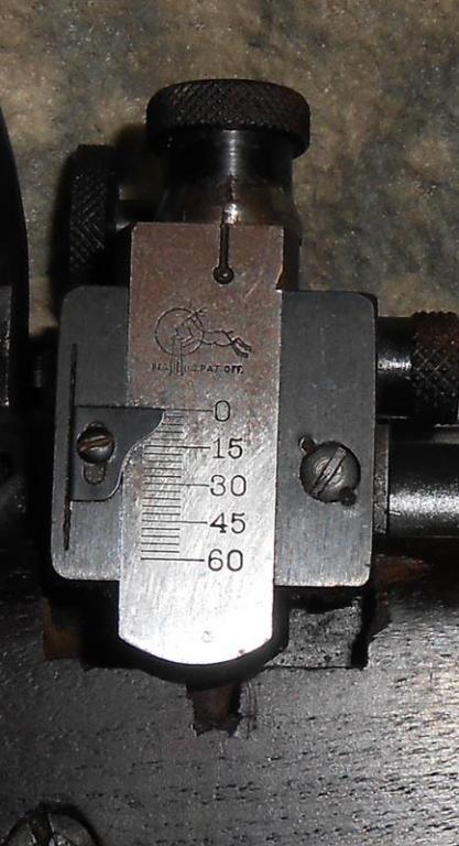

    Lyman 48C rear, Lyman front sights.
    https://i.postimg.cc/76phQCxg/DSCN8821-2.jpg
    https://i.postimg.cc/7LJytKbW/DSCN8833-2.jpg

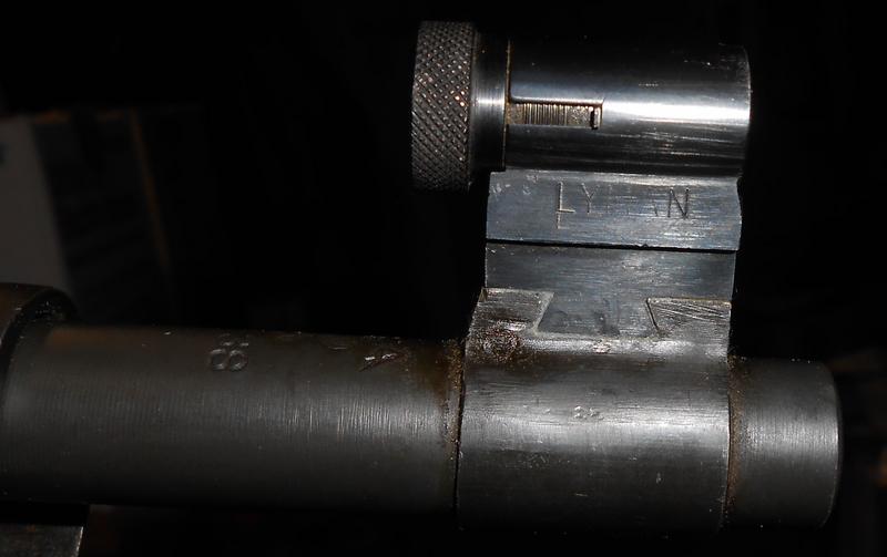

    Rear sight base marking:
    https://i.postimg.cc/MHQMW7sP/DSCN8826-2.jpg

    I made this comment on the CMPicon forum.
    But I think you have a National Match that was sent to the Marines as a Marine team rifle. Even though the stock has a 5, I believe this was most likely in the 1936 NM order to the Marines, possibly the 1937 shipment. But I just have a hunch it was 1936. But when the barrel was worn out at the end of a NM season the Marines re-barreled it and made it a Marine Special target.
    Then it was converted to a Unertl Sniper rifle post Jan 1943.
    Then at some point later it was built into this configuration. Which they always stamp the last four of the serial on the stock and handguard like this. Then they parked the whole bolt and clean off one little spot to electro pencil them. I haven't figured out for sure who did this, or why. But my speculation it might have been Raritan and post when the Unertl was declared obsolete and released to the Army. But I can't prove it. But I know of about a dozen of these. Some have the RA-P on the stock. One has a sales document to LetterKenny in the 50's. But all seem to be made from former Marine team or Sniper parts.
    I would love to know if the Marines built them into configuration and just released them to the Army, or the Army did some work on these as well.
    But congrats again! That is one rare rifle!
