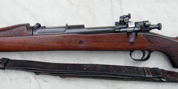

    New to milsurps.com, but not new to collecting. While searching for information on a (potentially) rare configuration, I found the most information here, so hoping to gain a little more insight. Thank you.

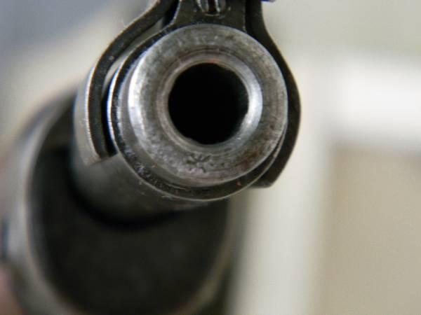

    I knew that when I saw this item advertised in a local classified for $750, I had better act quickly. I called the seller to confirm the star gauge barrel number under the handguard, hit the ATM and sped to complete the deal before anyone else could snatch it away.
    I knew that I was looking at several National Match features, and also considered that it could be an early Special Target. And searches for positive identification led me to the following thread:

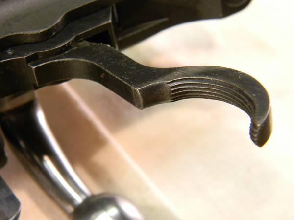

    Captain Crossman's 1932 description of the NM Special Rifle states that the rifle had the service type firing pin assembly and that the receiver was drilled and tapped for a Lyman Sight.

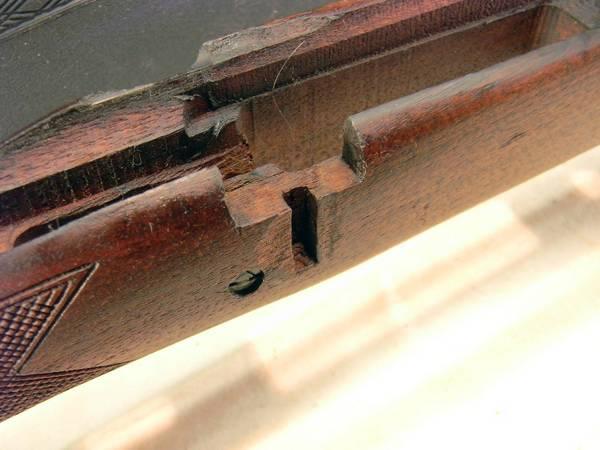

    The stocks of NM Special rifles were not stamped on the left side with an inspector's cartouche. They were, however, stamped behind the trigger guard on the bottom of the stock with the usual circled P proofmark.

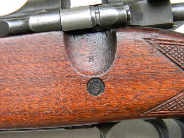

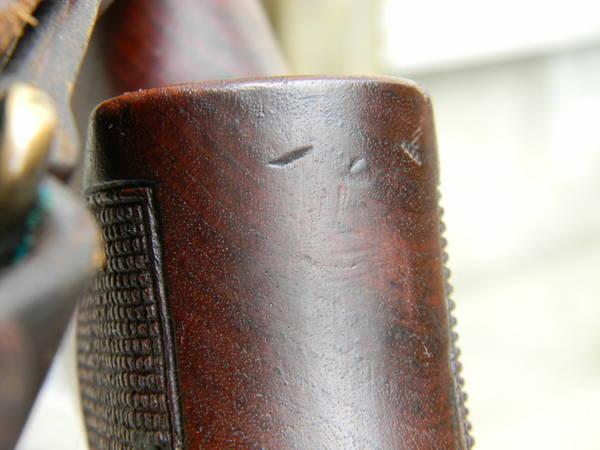

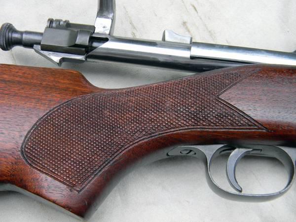

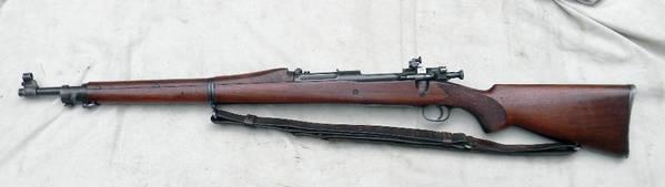

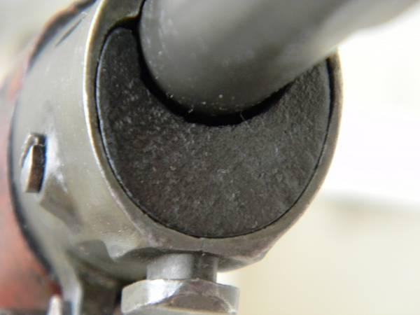

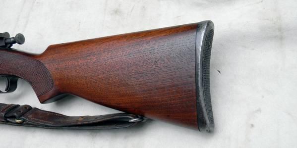

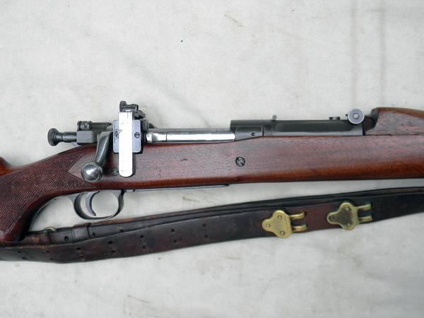

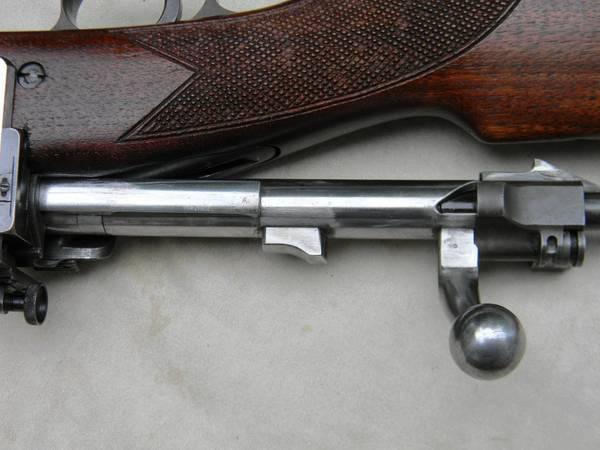

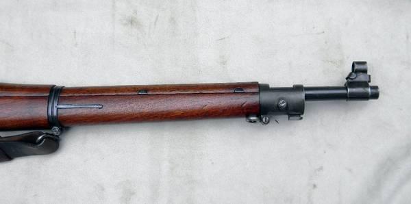

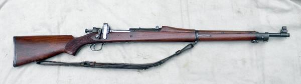

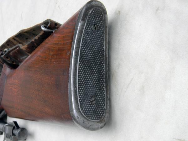

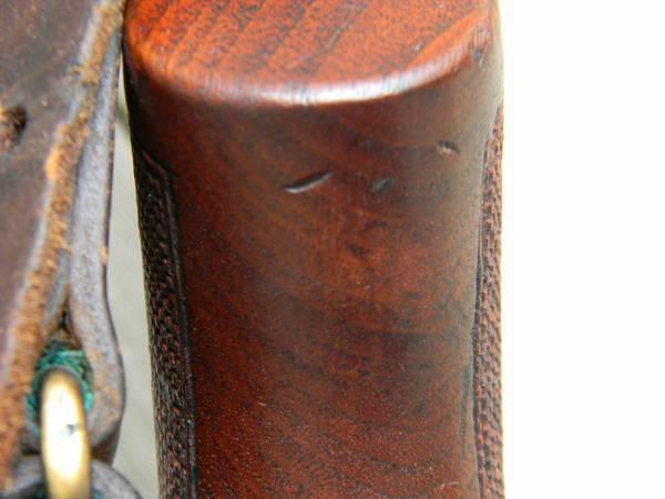

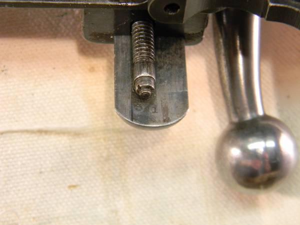

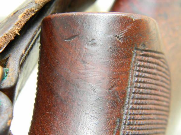

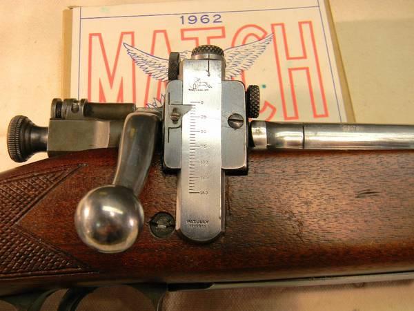

    The following rifle is a 'two-off' from Brophy's description, meaning that it does not have any evidence of a Circle-P proof on the underside of the pistol grip, and checkering has been added to the wrist. With the grip area obviously reworked (checkering and rounded edges), it is possible that a proof was sanded away. Another possibility is that an M1922 stock was independently purchased and installed with proper inletting for the Lyman on a NM barreled receiver, but odds begin to diminish with that scenario.
    So here I am seeking opinions. Could this be one of the fewer than 300 produced Rifle, U.S. Caliber .30 Model 1903 National Match Specials? All thoughts welcome, and thanks for looking.

    As I said on Gunboards, an especially nice rifle. Even with the checkering (which, to me, adds to the beauty), I think you got a heckuva deal!!

    Martin08:

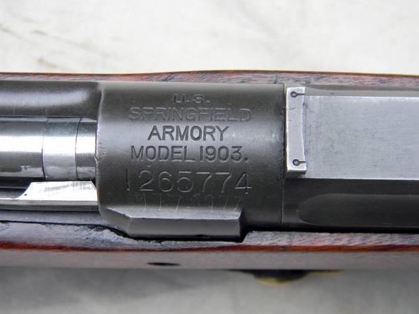

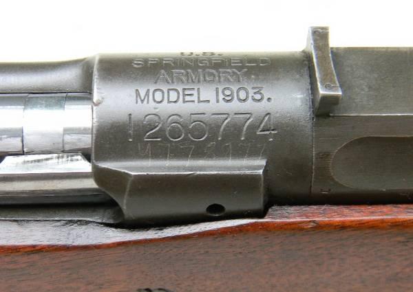

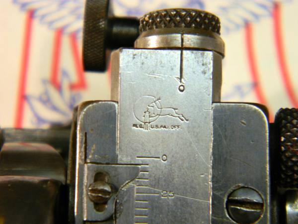

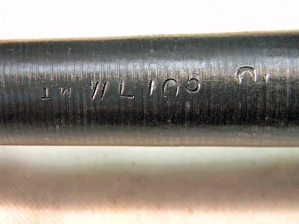

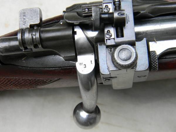

    1265774 is slightly outside a range of Special 1903s, ranging from 1265703 to 1265722, all listed in the SRS DCM Rifle Sales book. There are no other DCM rifles listed from 1265722 until 1265920, and 920 was apparently sold as a receiver only. While it certainly looks like an NM Special, there are several things I wonder about:

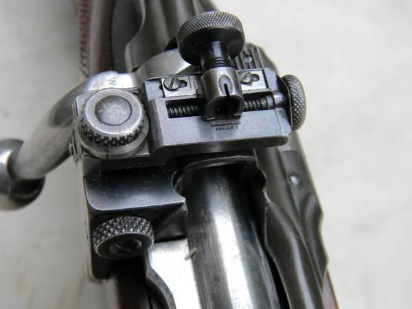

    The Lyman 48 "long" long slide rear sight is one that isn't normally seen on rifles as late as yours, but it is quite a rare pearl in itself!
    The stock without a circle P proof mark is a little disturbing, too. A stock purchased from the DCM by itself would not have the circle P, while the stock original to the rifle should.

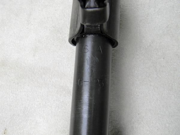

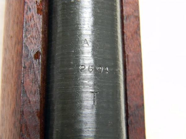

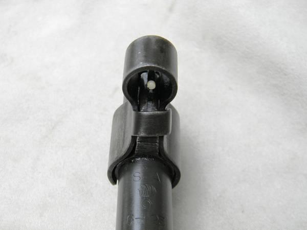

    The serial number puts your rifle right in the middle of the 1924 serial number range (1261487 to 1267099 according to Vi Shooter's list) , but your barrel is dated 6-23, which seems a bit too early to me. Normally I see barrels that are the same age as, or slightly later by a very few months, than the receiver.
    This rifle would have been fairly easy to build in the late 1920s with surplus DCM parts, it would be virtually impossible to build now.
    Whatever it is, you got a good deal on it, I would have bought it too!

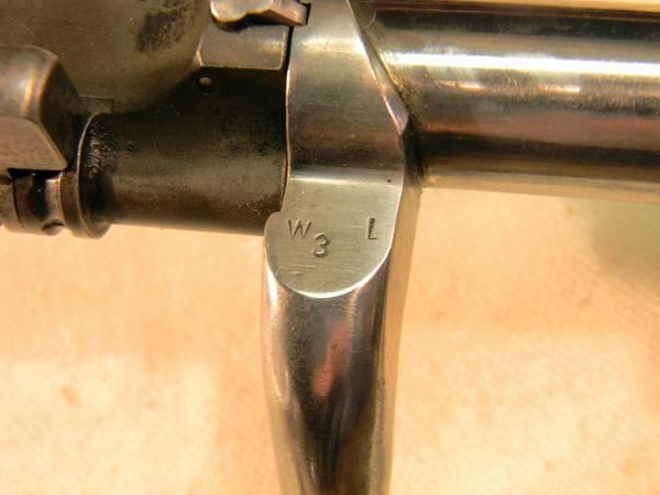

    Misses the serial range by 52, the recorded range. An SRS hit of another gun which is approximately 600 earlier than mine, serial 126,51XX, has a barrel date of 5-24. It is listed an an NMP (P denoting Special), yet it is a sporter. Has the nice Lyman 48B, too.

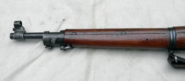

    Yes, my gun has driven me nuts since landing it. Has a mid-'24 receiver and a 6-23 barrel. Doesn't quite fit the time-line or the serial frame, but fits the model mold with all the fine features. Then, the Remington handguard from WWII era. Put together from parts? Hadn't considered that.... but should.
