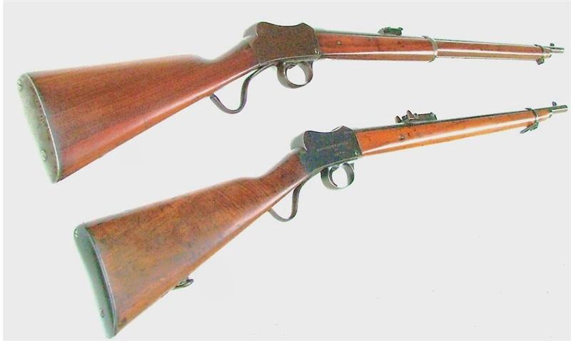

    These are Military trainers, They are nice, collectable, fun and great shooters.
