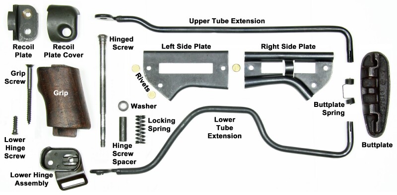

    Hello all, was wondering if anyone could help identify this part. At first I thought it was a recoil plate cover but looking at it closer, that can't be what that is. I am not familiar with the M1A1icon at all and was wondering if anyone could rule in or out if this part belongs to an M1A1 at all. Thanks in advance for any replies

    Not for the M1A1icon, here's a stock pic of parts and the link to go examine them closer.
    The U.S. Caliber .30 Carbines, Model M1A1

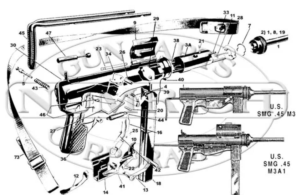

    Thanks BAR, there's another item in the lot that is not a carbine part as well which is right above that little black part. Some kind of weird shaped spring which I think is the end of a flashlight, the little holder that swivels flat with the bottom of the handle and can be raised up if you want to hang it on a nail. Listing said it was from an estate clean out so they probably just assumed those two pieces went with it haha
    Today @ 08:50 AM
    31,125
    04:08 PM
    That spring is the bolt and guide rail retaining clip from an M3 or M3A1 greasegun. Here in pic, top right corner number "7"...from Numrich.
