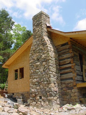

    Here's a chimney I finished solo on 6-6-09. One helper on the ground. 23' and 80" wide at base. Since the date was matched, I dedicated it to all allied participants in OVERLORD 1944.
    PD
