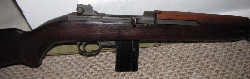

    Today I finnished my rebuild. My carbine is almost done except the bolt. Upper wood doesnt match but correct. Any ideas on how to correct this? The front sight was easy to get on and off. Barrel wasnt scratched much. I see why they went to a type III band. It holds the barrel better than a type II. I was able to trade SG parts for Inland to complete the trigger assembly. I have a bolt lined up which will finnish my rebuild. All and all I upgraded the wood and mag catch and downgraded the barrel band. Heres some pictures. It was fun to do and I thankyou for all your help.

    3ky,
    You've got that baby looking pretty nice. Darken that HG and your all set.
    What did you enjoy most? The thrill of the parts hunt?
    Or getting it all back together? LOL......
    Very nice, Thanks for sharing it with us.

    Hey I remenber that song. I been to the old Ryman. I love Nashville and its two hours away. Mu uncle probably knows the bands. I hear stories where my grandfather was also a groupie and a very good fiddle player!
    Ill look for a stain to darken the handguard. Its original but looks stripped. I got in trade with my Inland trigger parts. Its Inland.
    It all was fun. I got to meet new people and learn things. The people I dealt with were honest Carbine restorers. They wanted my parts to restore their projects. The NPM highwood is now on a NPM carbine and the SG trigger group is on a SG carbine. I also learned how to take one apart and put it back together. This site plus my carbine book were very helpful. Now I have a carbine in WW2 and another in Korea. I dont plan to rebuild my Underwood. I'll leave it like the last person in Agusta Armorey rebuilt it. All and all a very nice hobbie.

    Stain,
    Only use a oil base penetrating stain. Don't use one with the sealer and/or varnish all in with the stain. Like the Min Wax one step type stains. These claim to Stain..Seal and Varnish in just one coat.......DON'T USE THESE TYPE STAINS.
    Try hitting a local Sherwin-Williams or other Pro paint shop. If you take your carbine with you...they can tint a stain to match the HG to the stock.
    Point it just right and you may get all the stain you need for FREE !!
    Don't be afraid to inter-mix a couple stains to get the color you need.

    I'll do that this week. We have a Sherwin- Williams store in town. I'll take the stock and handguard and let them know I want an oil base penetrating stain. The handguard rattles like its alittle short. I wonder if it srunk. Anyone have any ideas how to fix that? This week I'll send off for the Inland bolt and that will complete it except some touch up work on some barrel scratching. I plan on keeping this carbine and my other. Barrel moves up and down in this barrel band but no side to side movement so thats good. I see why shooters like the type III bands.

    Michael,
    This may help with the handguard rattle... After you strip it and before you stain it, I would recommend that you do a multi-day "soaking" of BLOicon to "plump it up". I like Painter's process of submerging, but I doubt you have that equipment (I know I don't). Anyway, that may help swell up the grain making it larger and less likely to rattle.

    What equipment do you need? Looks like the handguard is stripped already. This was probably done to match it to the lower wood. You all can see in the picture it really doesnt have any finnish on it. Its not sanded thank goodness. My Underwoods is original underwood and is light but you can tell it has finnish. This one doesnt. Its dry also. Its in nice shape with a good marking. Lower wood is nice with no rebuild marks no marks where they were sanded away. It has the wheel marking on it.
    Last question. I'm buying a bolt. Do I need to have it headspaced? I have a mic and calipers to check its lug and face against the one that came out of it. Its no biggy either I am keeping the QMC and can change bolts if I wanna shoot it.

    Michael,
    Stain or color your handguard first. Don't clear oil coat it until it's been colored. That way the wood will take the color.
    If you seal (oil) it first, it will seal off the grain and won't allow the stain to penetrate evenly or deep enough.
    The darker the stain the longer it takes to dry. Let it dry a few days before putting any BLOicon or what ever on it.

    Some Walnut is dark enough in the raw or stripped stage to match another piece with out having to stain it. Best way to tell what a 'Natural' finish would look like is to first wet the walnut with a damp mineral spirits rag. If it doesn't look dark enough to match the other piece then get a penetrating stain mixed up to stain it with.
    All depends on the woods natural color.
