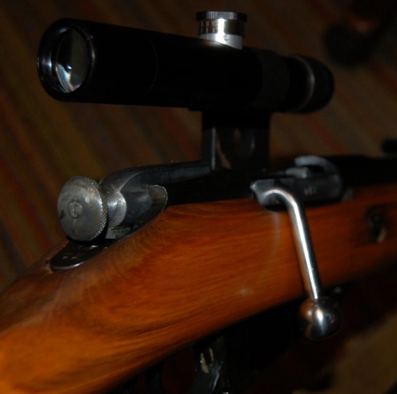

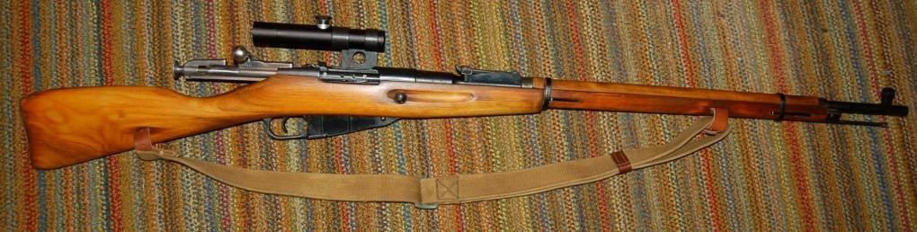

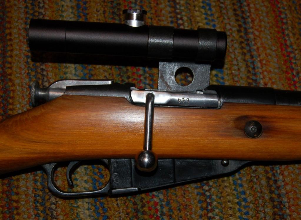

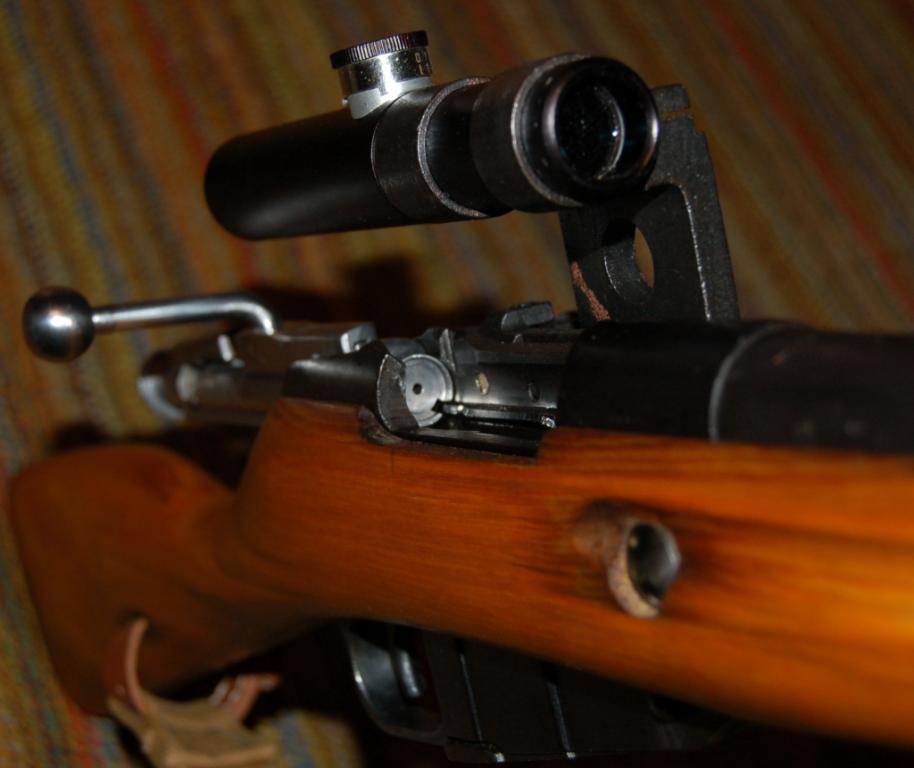

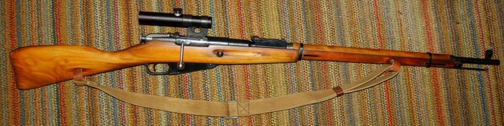

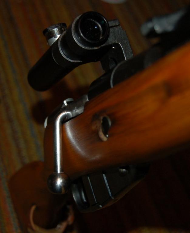

    As promised, photos of the finished project. This rifle is an ex-sniper bought at Dunham's for $79.99 plus tax and fees, roughly another $10.00. Scope is a Firefield brand reproduction with cast steel mount for $137.97 + $16.48 shipping. Drill, tap and cutting oil were approximately $11.00. Bolt conversion service was through ebay $30 + $5.50 postage.
    The stock has been stripped, cleaned and refinished with linseed oilicon, many coats. I spent about half an hour this evening doing some finish polishing of the bolt handle. I did the stock work and tapping and mounting of the scope myself. Final cost about $291.00. Haven't sighted the scope in yet, waiting for a nice warm day.

    That's a very nice rifle and nice job. Did you re-tap the original threads?
    Yesterday @ 11:02 PM
    7,510
    05-11-2025
    03:02 AM
    The original threads were not set up for a PU scope mount. From the photos I've seen they weren't quite right for a PE mount either but that is probably what was on it originally. It's a 1942 and that is the transition year from the PE to PU. I've never seen a photo of the lower PE mount so I don't know where the holes and pins are on those mounts. I have a couple photos on the other sniper build thread showing the interior of the action and you can see the location of the two rear holes. The two front holes are beyond the bolt opening, one may even be so far as where the barrel screws into the receive, can't see very well up in there.
