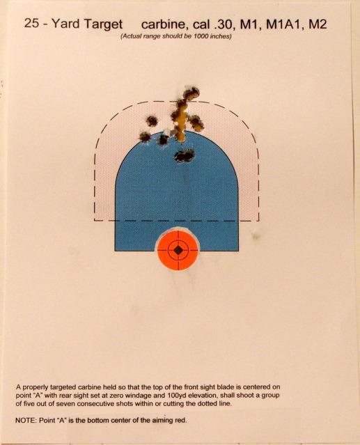

    Notice on this 100 yd sighting target that the aiming point is at the bottom edge of the allowable impact zone, not the center. The same is also true of the 25 yd target. Your sight blade may be a little low, but if you accurately reproduce the target and aim at the correct point, it sounds to me like your carbine would be acceptable.

    Pics added to show difference in shot location. Carbine1 is sighted in good for me shown in 25yard and 50yard targets, Carbine2 (with short front sight) shoots high, and higher still the further out you go!
    Carbine1 at 25 and 50 yards,
    Carbine2 at 25 and 50 yards (POA red center),

    04-27-2025
    12:16 PM
    Your carbine in fact is within the original mil tolerance as clearly shown by all but 2 of the shots being within or cutting the dotted line area. Looking at the top of your sight, it obviously has been filed down as illustrated in the manual for raising the point of impact. This was most likely done during initial sighting before shipment. Possibly they went too far on this one or the sight has been changed. You could put a taller sight on it if you want both carbines to shoot the same, but your first carbine is actually shooting rather low. Maybe swap the sights between them and see how that comes out? Again, the original concept was that the sight blade not obscure the target (enemy combatant) and allow for faster target acquisition. You can modify this sighting concept to suit your needs, but it may be wiser to leave a collectible WWII weapon just as it was used then.
