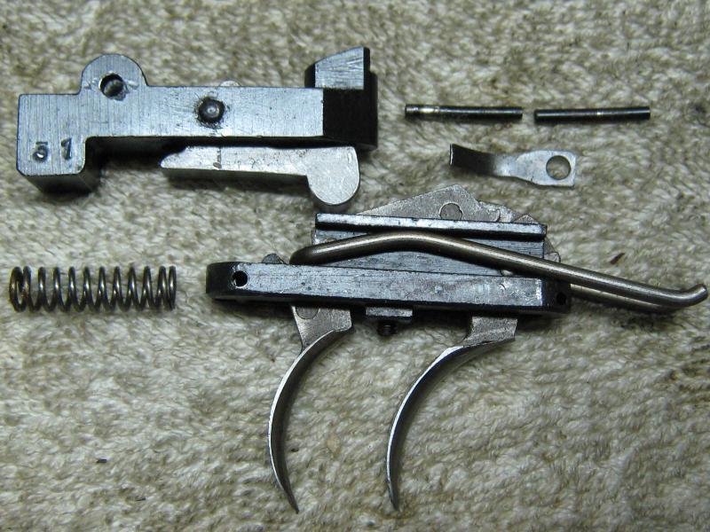

    I bought this trigger the other day and I really can't find much information about it. Did they acually use these on some of the Germanicon sniper rifles or are they just a commercial trigger.

    I'm suprised that nobody can help me out with some information, this must really be an oddball trigger setup. Can anyone point me in a direction for some information? I have tried searching the web and can't find much except that they actually exist. Maybe it's not even a Mauser trigger assembly and I'm a dummy for buying it.

    A touch of understatement there - that thread pretty well says it all!
    It is a very ordinary commercial double-set trigger of (historically speaking) recent manufacture, using some cast components, some stamped components, and a wire spring. A common retrofitting when Mauser systems are used for hunting rifles, of which I have seen plenty. But not on military rifles. (I am tempted to say never, but that would be challenging fate.)
    For comparison, here is a real antique, of a somewhat different quality, from my 1850s Anschütz muzzle-loader:
    Attachment 25616
    Note the leaf spring. All parts hand-cut and hardened. Perfectly sharp edges after 160 years. Absolutely stable let-off. Now cleaned and put back into the rifle. As good to use now as when it was made.

    Wow Patrick, you are correct. I only read down far enough in the post to learn about the set vs single triggers on Mausers. This is a very thorough thread indeed.
    Your trigger shows an example of the impressive manufacturing from the beginning of the industrial age, still working as designed today.
