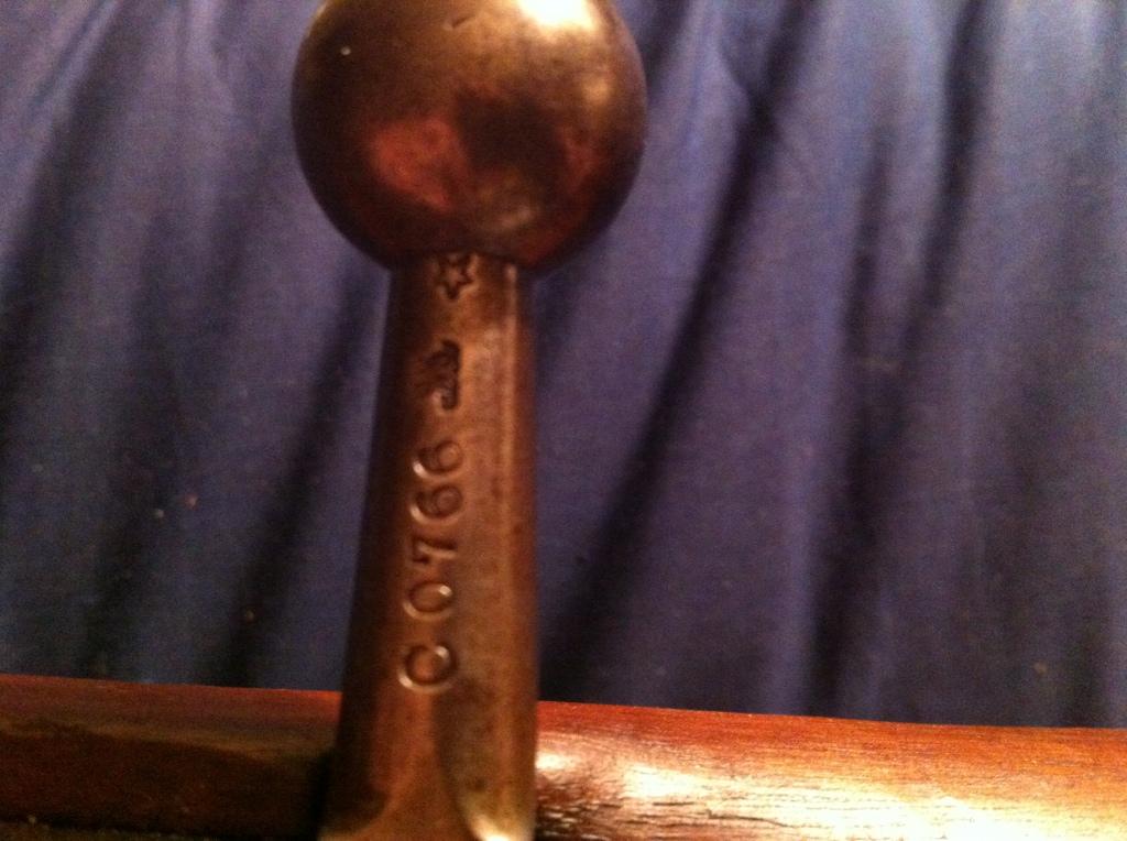

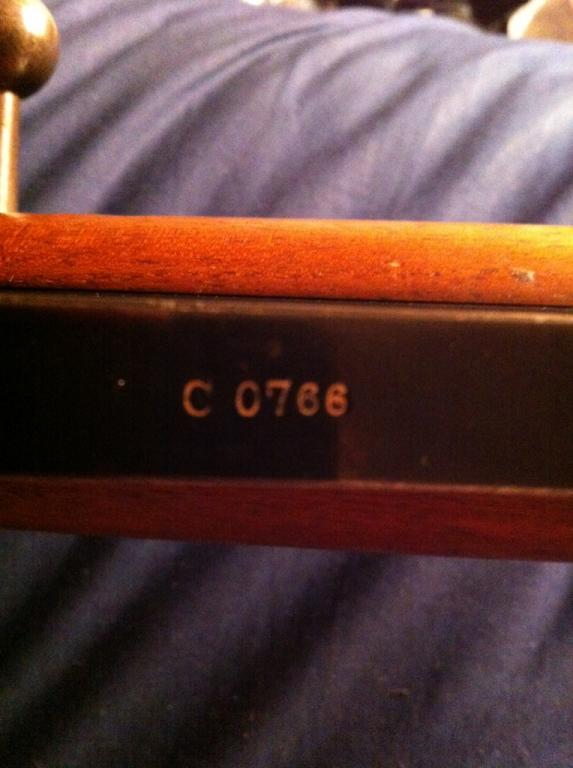

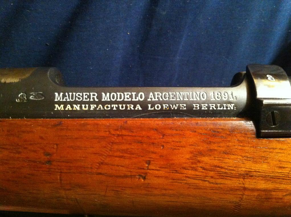

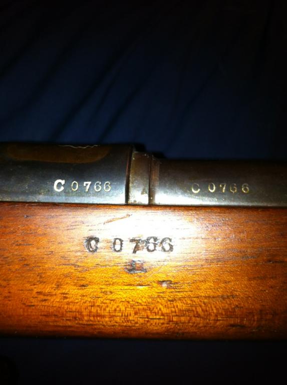

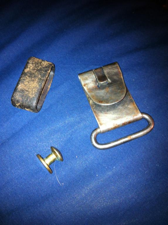

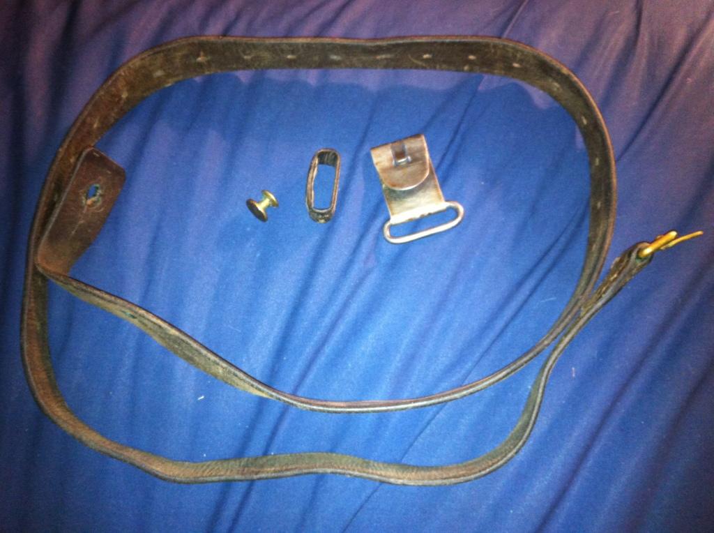

    I've had this rifle for around six years now, and am finally getting around to sorting it out. The serials all match, I have a 1909 bayonet and an unknown sling. I need help identifying the sling (I have 5 or 6 of them, all the same), and need to get a straight answer on ammunition to use.

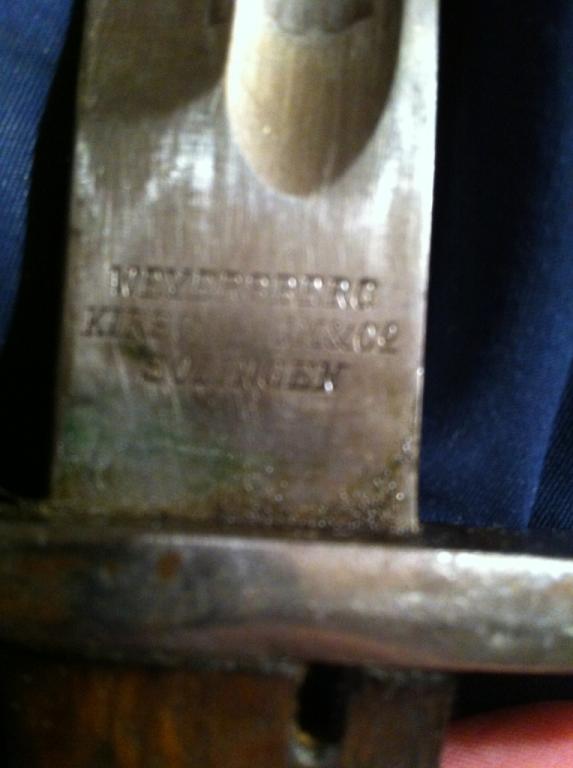

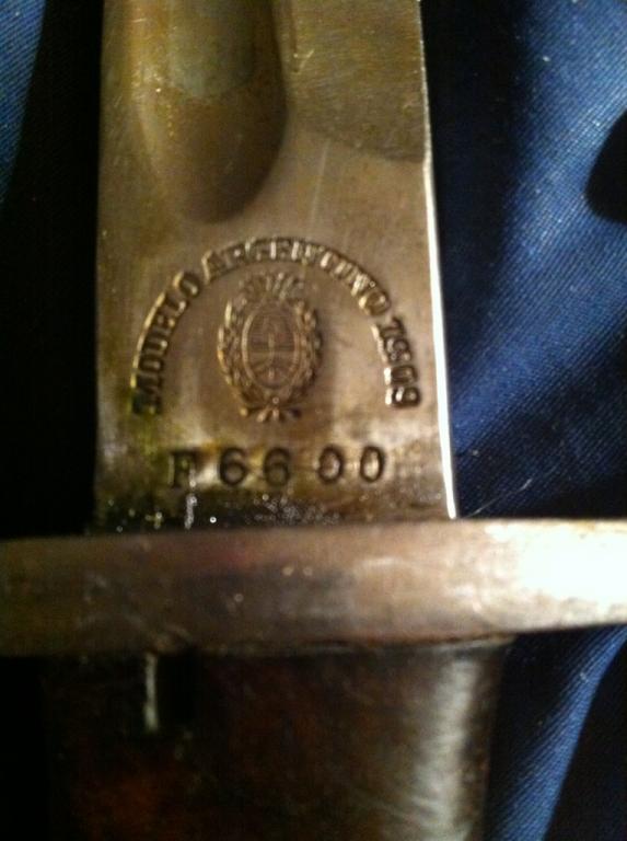

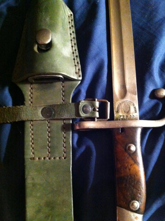

    Marking on the bayonet is "WYERSBERG KIRSC___UM & CO. SOLINGEN." Their is no marking on the green leather frog.

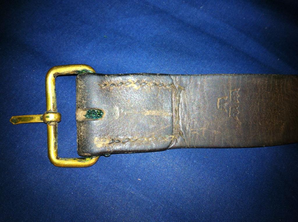

    As far as the sling, the only markings I have found are three small crowns in a triangular pattern. If this is the correct or an acceptable sling, does the button go to the front or rear of the rifle?
    I would like to trade this 1909 bayonet for the proper model, but I can live with it. I'd also probably sell this ammo, or pull it and reload, if not suitable in this rifle.

    The name of the bayonet maker is Weyersberg Kischbaum & Co. Solingen, the usual supplier for Argentineicon bayonets of that vintage.

    I have found that the sling is a Swedishicon model. I have listed them in the for sale section. I found a repro green 1909 Argentineicon sling that will match the frog that I will most likely order, unless I replace the bayonet and/or frog.
