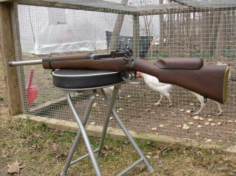

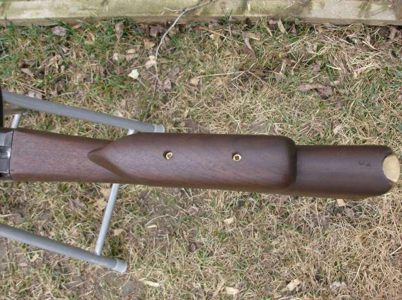

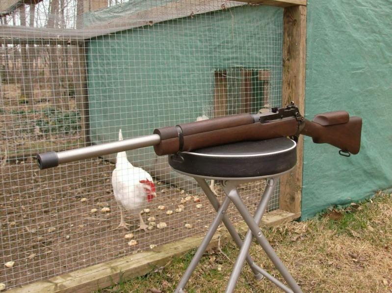

    Hi folks,
    Thought I'd share this here. A guy in Canadaicon made a run of barrels for the No4 action, chambered in .45ACP, and ordered magazine adapters from the US. I bought one kit, and in echange for some labor which this fellow did for me, I agreed to "dress up" his .45 No4. I'll work on mine later this year...
    So here's the result; the barrel's final shape isn't done yet (the owner will do it), nor is the metal refinished, my responsibility just involved the wood. It was my first attempt at carving a cheek rest, which took longer than I'd hope (true fitting between it and the butt stock isn't regular shaped!)
    Lou
