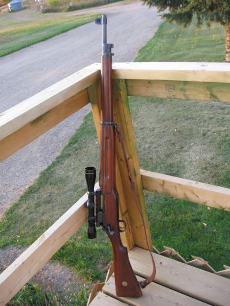

    I put together what I think is the nearest practical thing to a P13. I bought a junker P14 and put a 7mm barrel on it chambered to 7mm Rem mag.
    From what I can gather the .276 enfield and the 7mm remington magnum cartridges are almost identical in performance, and as near as could be got dimensionally. Everything feels right about it when shooting, it is far better than shooting a .303 P14. It's my serious long range rifle.

    Nice looking rifle. Hard to believe that was ever a "junker"!
    All that's left of the original rifle is the action and bolt. Everything else is a mixture of parts. The stock is a NOS P14 that I bought on ebay. It was not accurate until I floated the barrel, now it's amazingly accurate.

    05-10-2025
    03:55 AM
    The above post should read NOS P17
