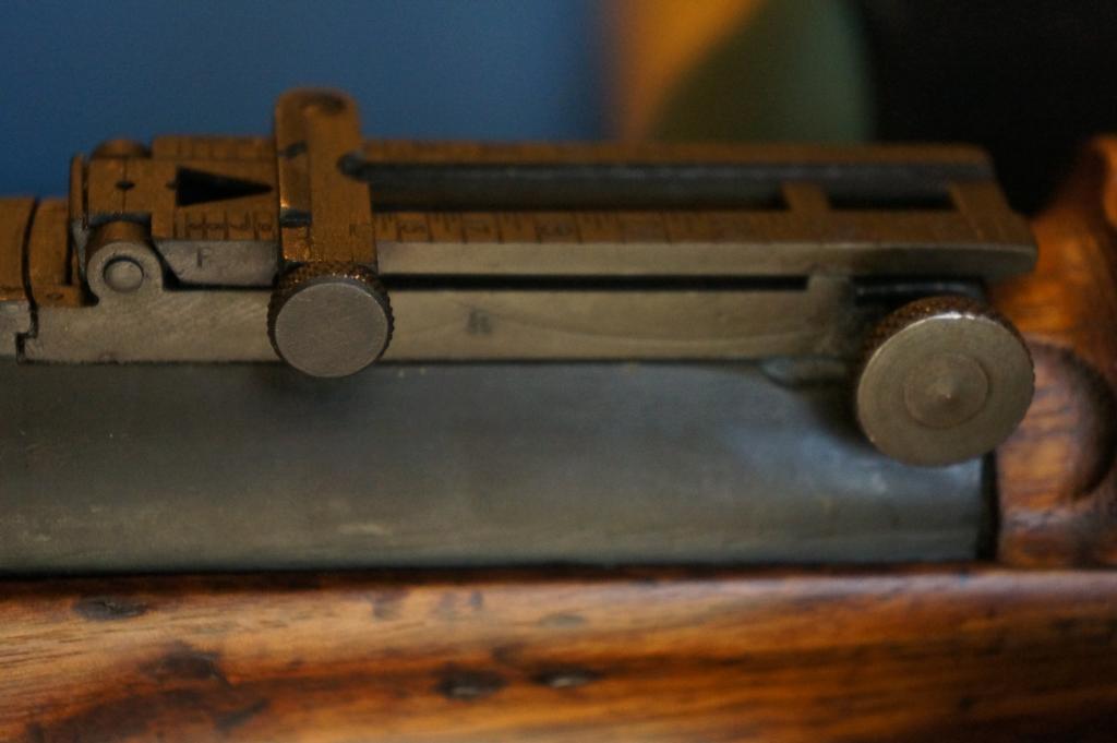

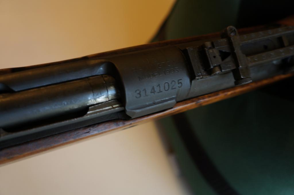

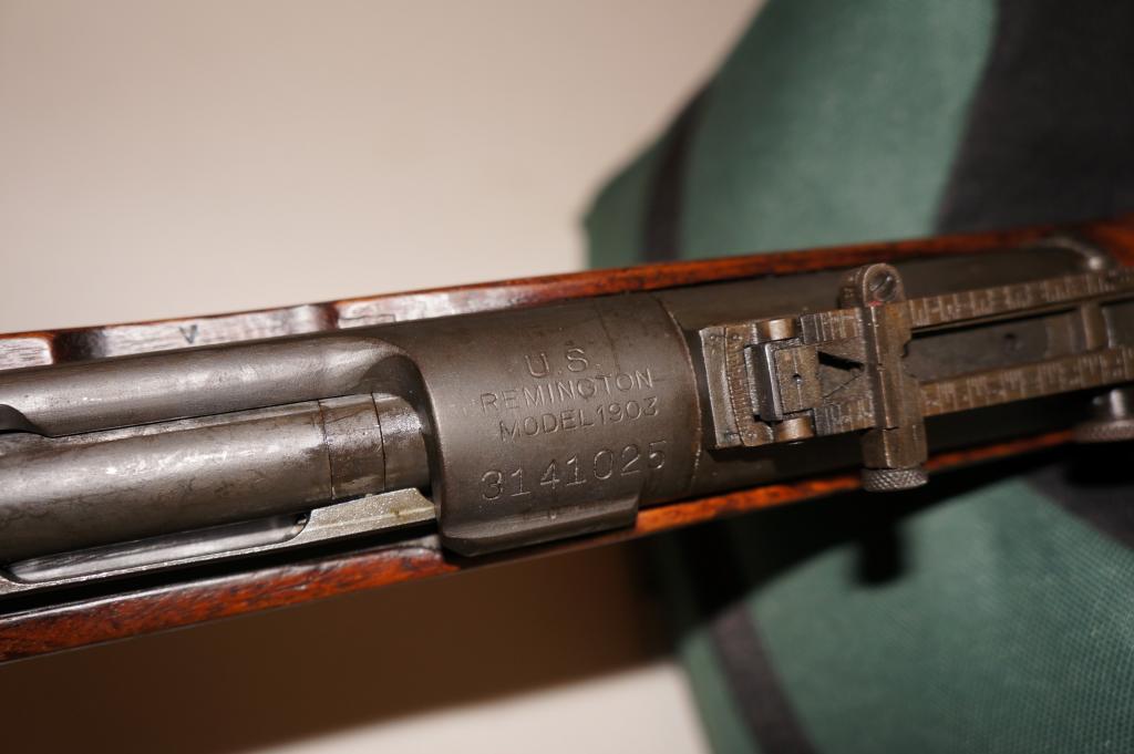

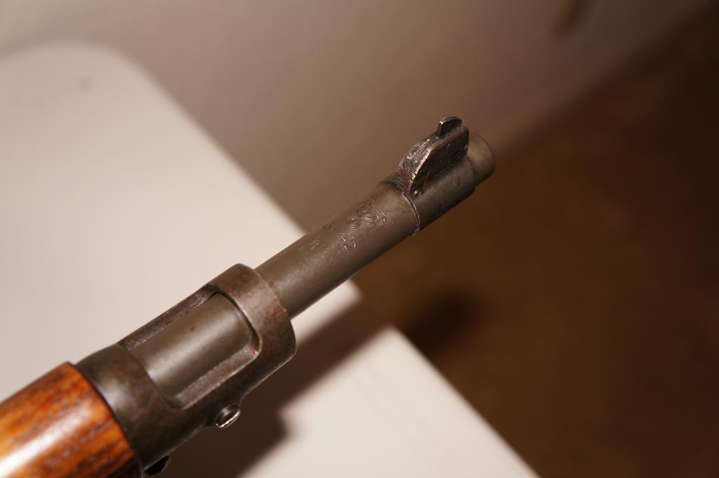

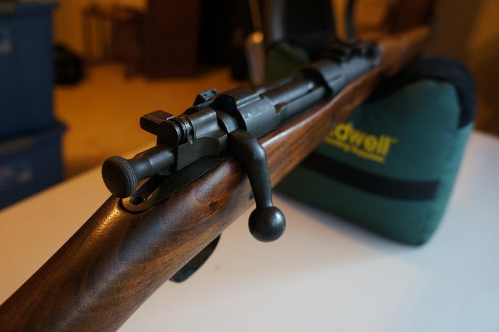

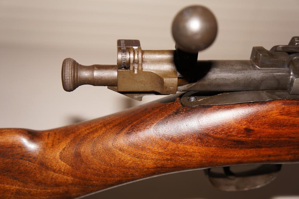

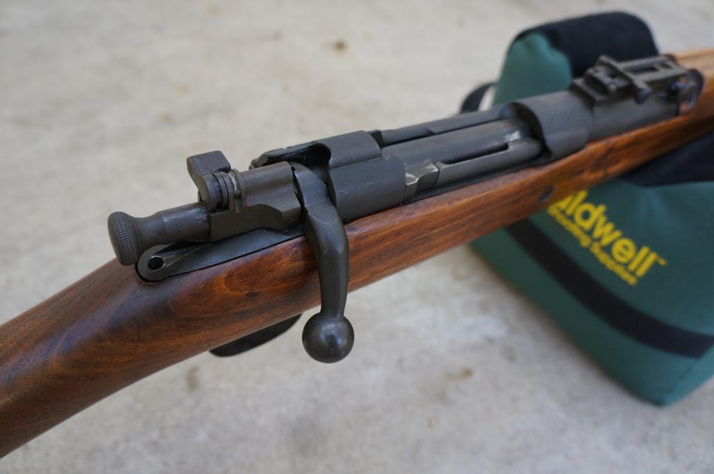

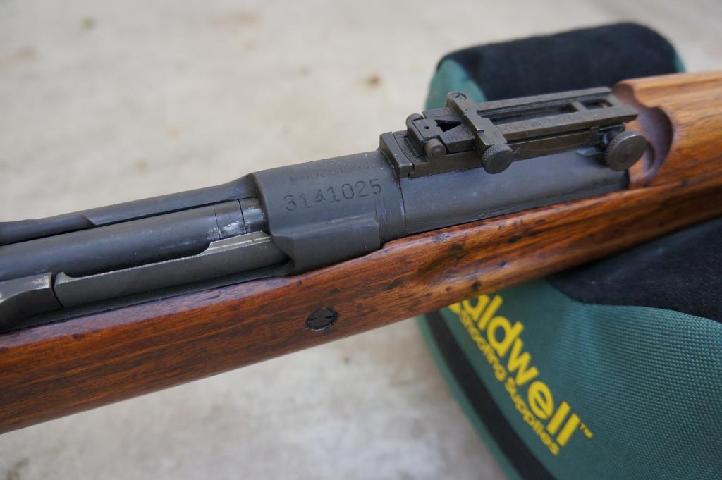

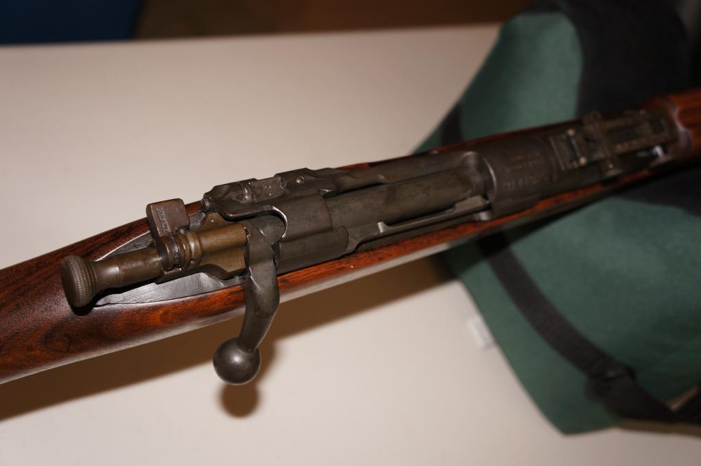

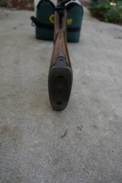

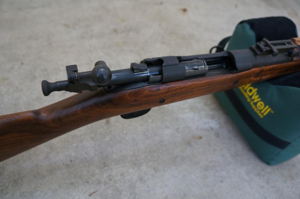

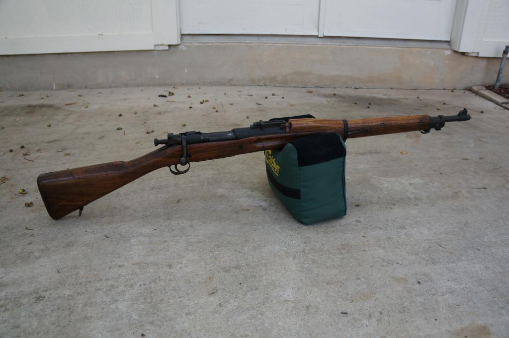

    Here's a Photobucket gallery:

    The stock is a Mark I (notice the "notch" on the left side). The rifle appears to be refinished, as well, with a number of replacement parts.

    Thanks! So I guess that finish is not the original dark parkerize. Wish I knew where it had been. I have the CMPicon COA for it, so I know it came from them in 2008. Maybe a Greek return...

    I noticed it has tiny flakes of red paint on it near the sights, like something on it was painted red at one point. I could only see them in my close-up photo. I'll ask my friend if he cleaned off any markings.
