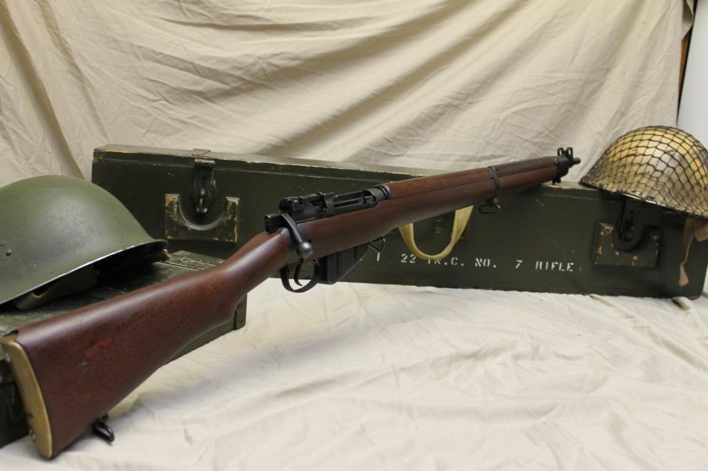

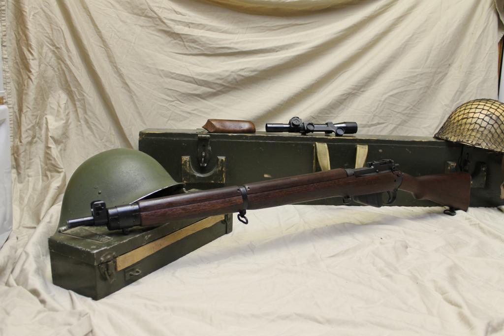

    Quick update: rifle is now what I would consider restored. I'm going out to test the bedding and sight it in with the aperture tomorrow.
    Before:
    Mid:
    Restored:
    It and my as issued '42 Longbranch in the last one there. Just awaiting a nice Canadianicon buttplate then its basic form is finished. Range testing tomorrow then I will decide if it deserves that scope in the background. If it does I'm off to learn how to solder properly then onto building a jig then time to get the files out and fire up the drill press. Things are coming together.

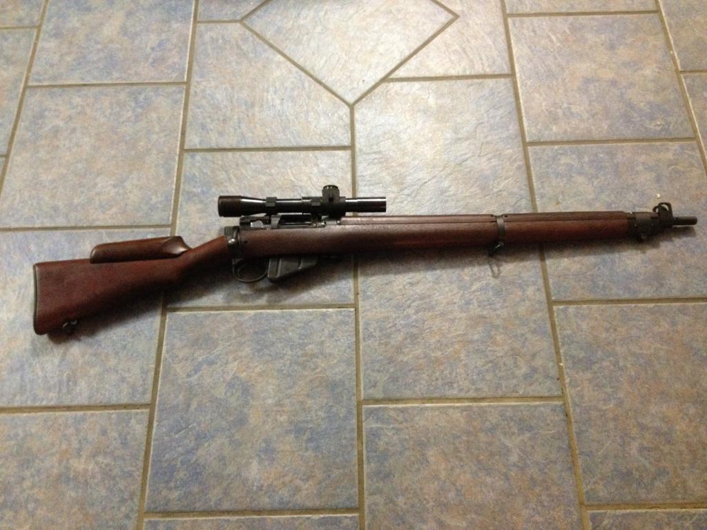

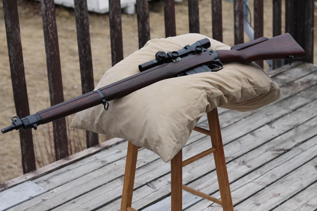

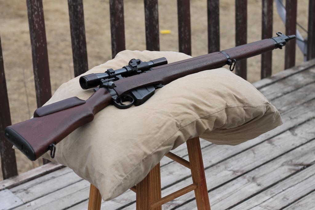

    Well its finally done, 11 months after I originally decided a repro 4T was what I wanted. I guess a poor man's fantasy Longbranch No4 Mk1/3 T.
    From start to finish:
    Started off as a VERY lightly used No4 Mk1/3 Longbranch originally built in 1944 that was upgraded to Mk1/3 at Faz in '51. The previous owner claimed a very low round count, 4 to be exact and the bore shows it.
    This photo does not do it justice...
    Part way through fitting up the very chubby Pakistani woodset.

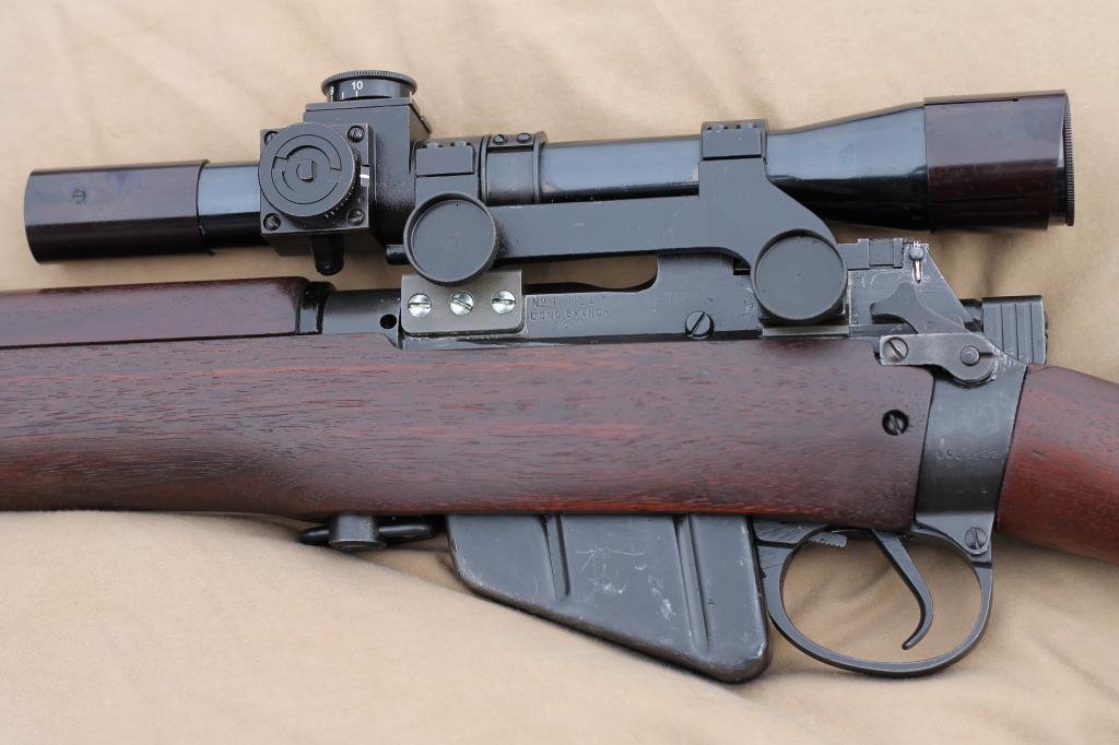

    Reproduction No32 MkI scope that I got from Wheaty on CGN. Great fellow and very very helpful in this whole project.

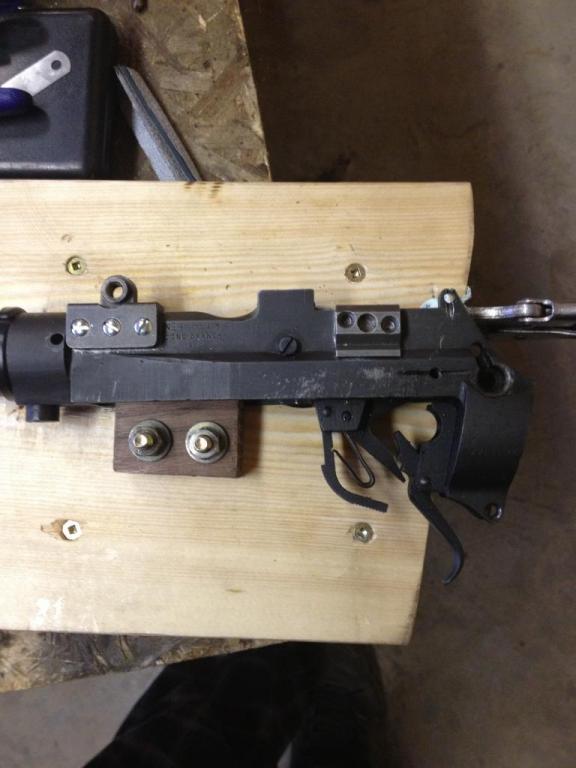

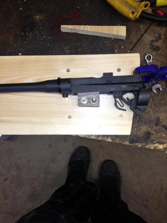

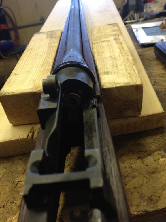

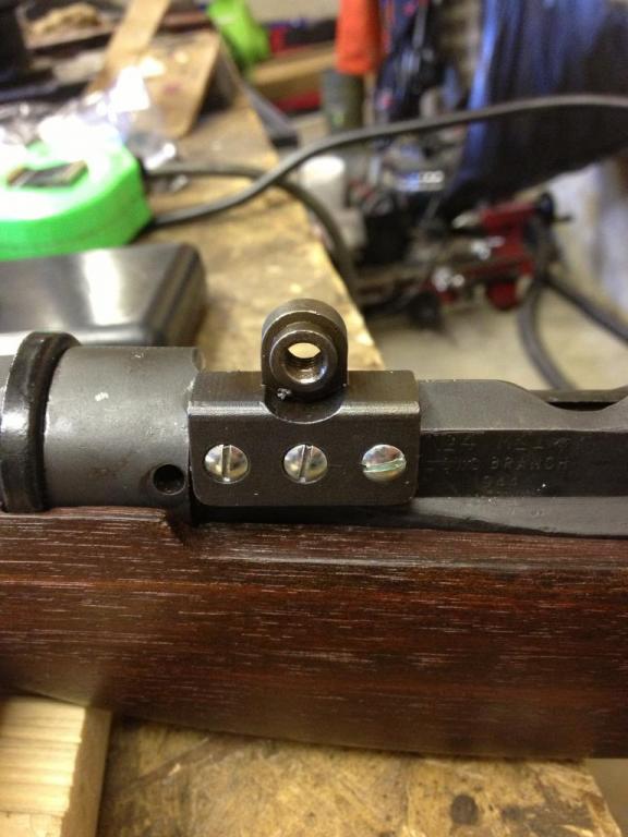

    This shot shows the wooden jig I built for this project. It has a hole for the charger bridge and a recess that allows the body side to go down flat. I used a pair of small vise grips with teflon tape over the jaws to hold the rear sight ear down during drilling and tapping as well as filing the receiver.

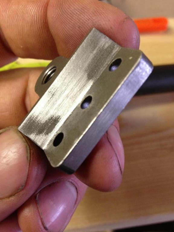

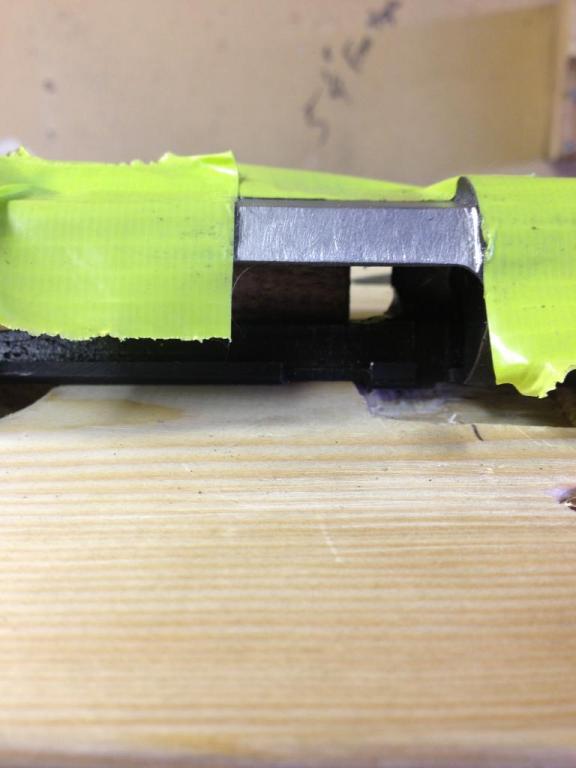

    I found that the sloped portion of the pad rocked on the receiver a fair bit in original form so before I began the fitting I filed the surface true.

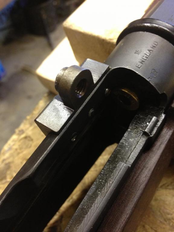

    File job under the surface of the front pad. I hope I did this part properly. I got things down as flat as I could and removed all of the finish. I also squared up the front edge so the pad would but up perfectly

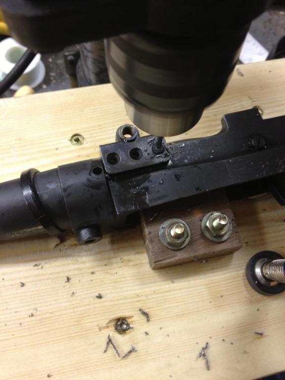

    Drilling one of the front pad 4BA holes.
    Front pad after the initial fitting. You can't see it in this photo but I cleaned the metal down about 1-2mm outside of the area the pad covers all the way around to make sure it sat flush.
    inside shot of the screw heads after the first cut. This shot also shows the once fired case/less primer I used to sight it for the fitting of the pads

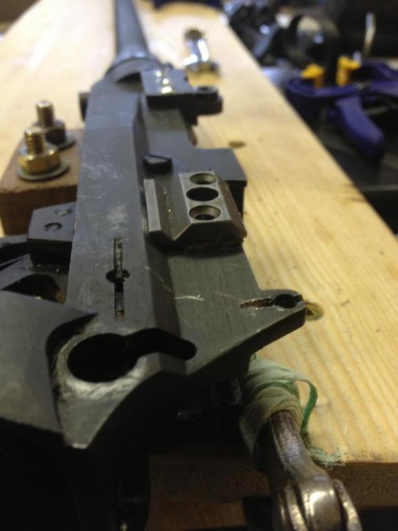

    The bottom side of the jig had a section of 2x4 that I cut at a slight angle and placed about the width of the forestock apart. This held the rifle quite firmly in place while getting things lined up and allowed me to use another 2x4 under the front of the jig to act as a ramp. I was only able to use a neighbors chimney rain cap as a target. It was only about 150m out but I made it line up perfectly and set the range drum accordoingly when doing the rear pad.
    The rear pad sitting on its soon to be permanent location. I wound up having to shim it up 0.048" to line it up with the front pad. I used strips from an old feeler gauge stacked up to build the shims. It seemed a lot easier than machining something and it was only a princess auto $5 gauge.
    This shot shows how much shim I had to add to get it where it needed to be.

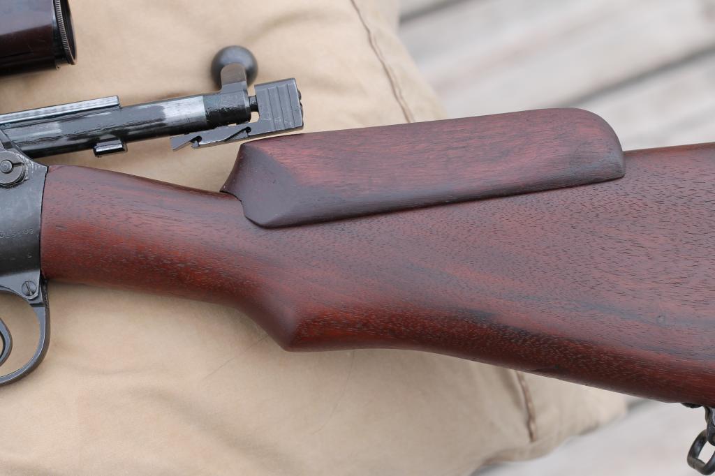

    Being a rookie I never took into account that the bolt has to operate. Ha ha. I wound up spending about 2 more hours fitting this cheekrest, then about another hour trying to get it to take stain. Whatever they use to make those repro rests seems to hate stain!
    And here it is, ready for page four of Peter's instructions, then off to see how she performs this weekend.

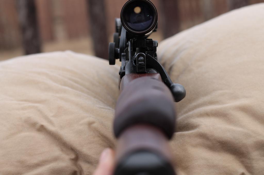

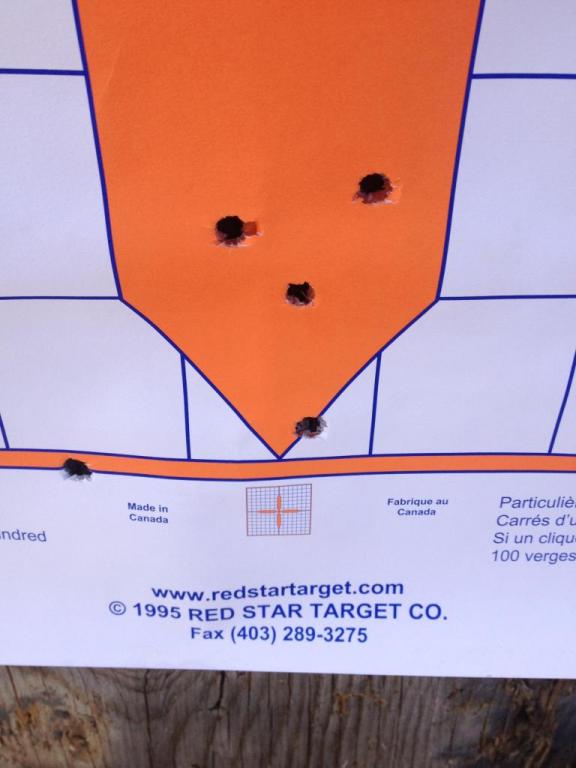

    Range report!!!
    Anyway I braved our 80km/h winds and took it out to the pit today. I sighted in as best I could (forgot my scope tool sitting on the workbench so its not quite zero'd). I only took two different loads, one of 39grns H4895 under Hornady 174gr round nose and 39 grns H4895 under 174SMKs. I am very pleased with how it performed, what a pussycat to shoot. I have a feeling my fiancee is going to like this one (maybe I better keep it from her!).
    Keep in mind that it was so windy it was brutal to hold steady, even with front and rear bag. Wind coming in at 10:00. These groups were tiny compared to with my Ross MkIII sporter or my M1917 which I also shot today. Best group with the M1917 for comparison was about 6", but it is a new rifle to me still too and was its first day out too. Enough of the excuses as to why I'm a lousy shot heres the pics...
    First group after I was able to somewhat zero it:
    Second group (whats with the flyer?):
    300m on the steel plate with the round nose load:
    7 shot 300m group with the last of my SMK loaded ammo:
    Seems like the SMKs must be shooting a little slower than the RNs? They were hitting at POA and the SMKs about 6" lower at the 300m mark.
