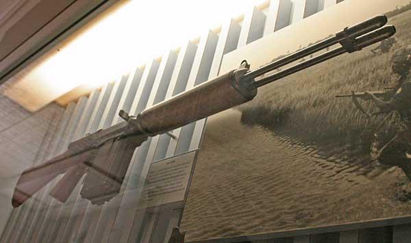

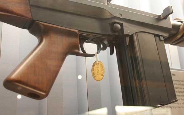

    Board, I would like to share two photos from our esteemed member RCS.
    From RCS:
    Quote Originally Posted by RCS
    "Rifle was developed by Winchester during 1956=57 and chambered
    for the 22/T65 duplex cartridge (22/7,62x51mm with two bullets). Weight was
    11.8 lbs, total length is 43.5 in and barrels are 23 inches.
    They call it the double barreled T48 but it would appear to me that it is something
    on its own ! Robert"
    This is truly a unique specimen of the experimental work performed in the interest of defending this nation. Many thanks to Robert for taking the time to email these photos to me and many thanks to his ever present contributions to this site.
    Bill Hollinger

    Thanks Bill for posting these photos, this rifle was developed by Winchester during 1956-57. There are two bolts, two barrels and two 20 rd magazines and one trigger and one gas cylinder. The line drawings of this rifle had some information stating that two T48 rifles were used but it looks to me that this is a dedicated receiver produced for this project but could be wrong. The gas cylinder has a ball that will block the other gas port if only one barrel is being fired, if both barrels are being fired the ball will stay in the center. The weight is 11.8 lbs, length is 43.5 in and the barrels are 23 inches long.
    The cartridge used is the 22/T65 Duplex (22 on a necked down 7,62x51mm case. Thanks again Bill for posting the photos

    The designer listed for the T48 double rifle is Stefan K. Janson, who was Manager, Arms Research & Development Dept of Winchester. His name should be familiar as he was one the principal designers of the EM-2 (No 9 Mk 1). Before WW2 he was a native of Poland and fled to Englandicon.
