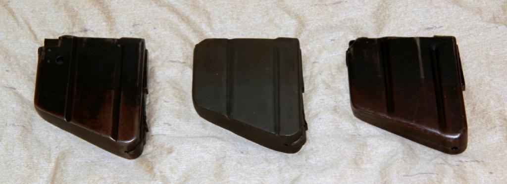

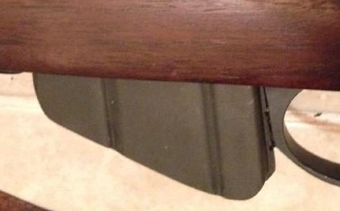

    Who produced No.4 Mags that had a phosphated finish?
    Might be hard to tell in the picture - but there is a green hew ...

    Picture shows a No 1 magazine, rather than a No 4. These are often phosphate finshed/ "parkerized".

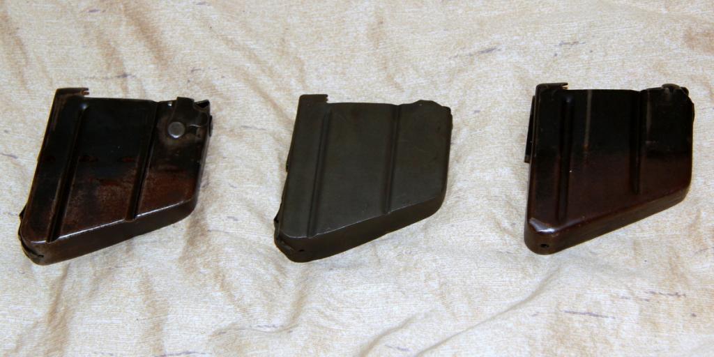

    That thread was a great help. So if I have this correct then (from Left to Right) are:
    1. SMLE Magazine with cutout for the mag cutoff
    2. A No.1 Magazine that may have had a No.4 follower added? ( mag from the initial post )
    3. A No.4 Magazine

    The one in the middle appears to be a standard later-made Australianicon SMLE mag.

    L to R 3rd variation No1 mag, case should be stamped with a 3 that is most likely over a 2, conversion of earlier No1 mags for use with MkVI & VII ammo, auxillary spring should be stamped with a 3 & the follower a 2.'
    4th variation No1 mag for use with MkVI & VII ammo, case & auxillary spring stamped with a 4 the follower a 3, both of these mags were fitted to MkIIIs & MkIII*s
    No4 mag.
