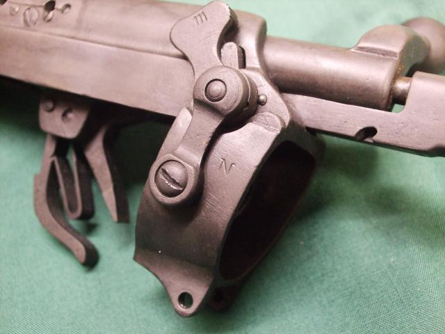

    approx 20 mins or when the reaction begins to ease, remove part, the part will have a white kind of residue on this can be cleaned off, I used kitchen towel to wipe it clear,
    after the initial wipe, I wiped it over with AC90 (WD40) I did this a few times then let it dry.
    The picture makes it look very black, but in certain light it is a very dark grey.
    I did a SMLE action I,ve had for a while using the recipe , this was a sporterised SMLE, which I stripped for the action, it had been polished to high heaven and had more holes than a colander , so a spot blast and a pickle brought it back to a reasonable standard. this is a long term project that I hope to finish one day am looking to mount a scope mount/mounts and scope that fit the period. a before and after, (it still may end up as a De-Lisle which it was bought for)
