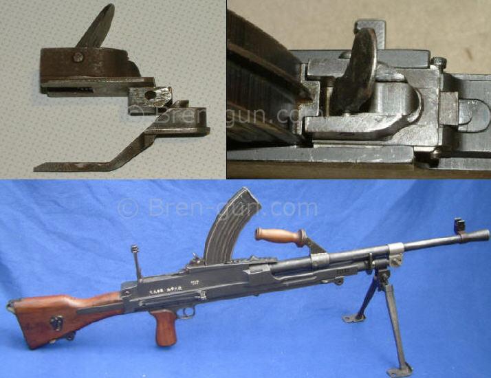

    Machining drawings of Chinese 7,62x39mm ejector block/mag catch??
    Does anyone have dimensioned drawings of the proprietary Chinese 7,62x39mm Bren conversion ejector block/mag catch (AK mag block) ??
    I know it's a long shot, but figured I'd ask first......
    I am working up a couple caliber conversions as I await transfer of my Mk II, and am starting on the x39 set up next. I am looking at doing a short CNC run of new blocks. Barring the availability of existing drwgs, would anyone be able to let me borrow an actual block that I will then run through the CMM and produce a new digitized model of, and from that produce a suitable set of .IGES file models to do the CNC run.
    If I can borrow the part, I will return the favor by sending you a couple of the new-made 4130 blocks.....or whatever you want.
    If I can get the parts made here soon, is there anyone else interested in them?? If I can get a run of >15 pieces, I'll probably make them.
    -TomH

    Greetings Peter!,
    Wellllllll...YES....I am doing a x54R conversion, as well. If you saw my other posts recently, I am very close to completing a conversion of a 47rd DP-28 pan magazine for just this purpose. I have already done the necessary removing of the old DP magazine well adapter and done the CAD drawings and CNC file conversions to produce a new Bren-sized mag well adapter piece. I should have the new piece "in metal" by the weekend, and then I will TIG it back up under the DP pan, and off we go. My newly designed adapter fits well into a DEMIL'ed parts kit receiver piece I have. Doing the bolt face and barrel rechamber is not an issue. I seriously doubt whether anyone ever thought a DP pan would ever be on a Bren!
    I have been reading multiple, numerous, comments on how different the 7,62x54R cartridge recoil impulse is....compared to .303 MkVII ball.....this got to me to investigating things....
    I believe the best way to handle the differing "felt" impulse, without resorting to major changes in the angular relationship of the piston-post cam and bolt unlocking cam surfaces, which relationship is really where the issue lies given a specified impulse force, is to simply slightly alter the piston-post buffer dynamics.....re-spec'ing the designed spring there is probably unnecessary, so my take is to install an inner elastomeric polymer buffer, or second interior spring of a suitable rate, to slightly bias the unlocking of the bolt cam by a very slight margin, allowing just a short dwell time longer, or conversely, an impact buffer effect. I'll have to bore the post spring guide, but I've got several to play with, and I am going to start by counter-boring one a fraction of an inch and installing a small polymer buffer "plug" and we'll see where we are.
    The 7,62x39 option is simple economics over here.....AK Mags and the ammo are cheap and plentiful. Since the only real effort needed is to clone the Chinese ejector block and ejector and rechamber a barrel, and a little bolt carving......too simple. The ones I have seen pictured seem to work well.
    -TomH

    This has a slightly different profile but looks pretty similar. Any confirmation on what it is?
