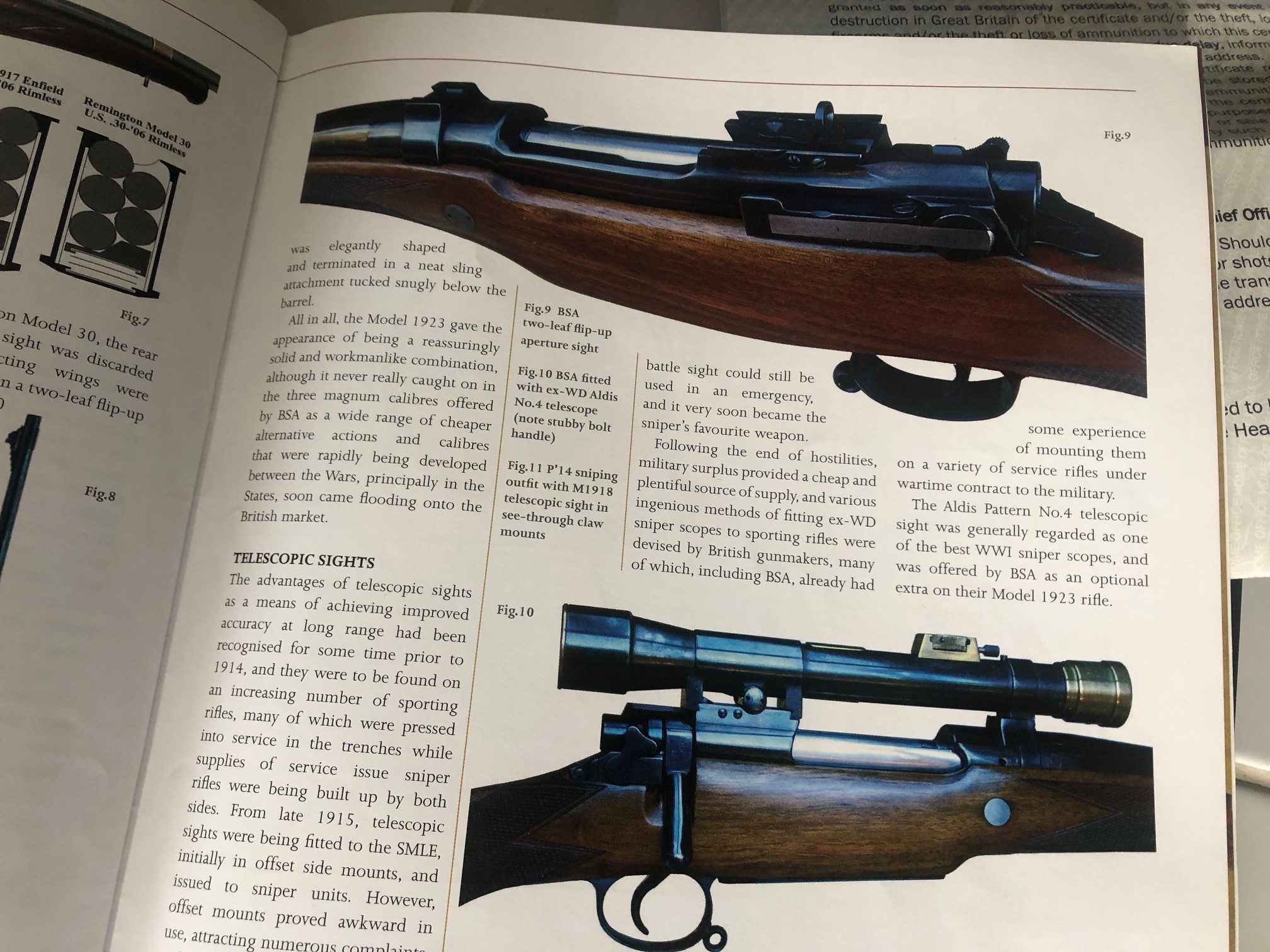

    BSA Model 1923
    I think this scope would have fitted the BSA Model 1923 but I'm only aware of Aldis scopes being used.
Name:	BSA front cover.jpg‎
ID:	138478   Click image for larger version
Name:	BSA 1923 Aldis.jpg‎
ID:	138477   Click image for larger version
Name:	BSA 1923.jpg‎

    That's the one, Nige. Couldn't remember the designation.
