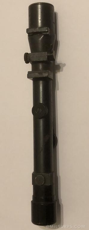

    PPco Scope unknown mount
    just picked up this PPco scope in very good condition but with a complex unknown mount !

    It looks to be very similar to a system used with Aldis scopes fitted to sporterised P'14's. Never seen such a mount on the Model 1918, but I've seen several Aldis scopes with what looked to be the equivalent mount system in 1" scope diameter. Never seen any formal reference to it, & it could be a rare previously unknown sniping mount, but I think the former explanation is more likely. Thank you for showing it to me last Sunday. It is certainly unusual. I presume it rotated as it was fitted & then locked into place on the rear mount........same general principle as the turret mount on the Kar98kicon.

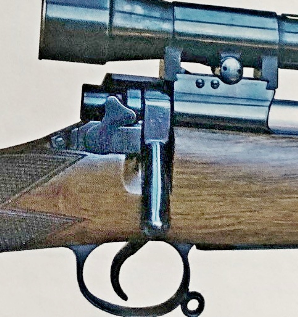

    A bolt with no knob; that's a first! And the sling loop on the guard as well.
    The mounts are certainly an advance on what was the current at the time, but the funny thing is there is no way of taking up any slop. The Goerz "semi-turret" design which seems to have inspired the front mount, was spring loaded and pivoted up and down. Here, if the user was not careful to keep things aligned when pivoting the scope tube to the right it would not be hard to strain the front mount. The rear dovetail is certainly strong enough to absorb recoil forces and demonstrates a knowledge that they operate in both directions, but there is no means of adjustment for wear.
    The folding peep sights are clever; inspired by the Porter on the Ross M10?
    So these were presumably the inspiration for the Remington Model 30 that appeared about 1926?
    Skiprat, your scope's rear mount has apparently been designed to sit the scope farther forward than the example in Nigel's photos or is that just the length difference between the No.4 Aldis and Patt.18; I forget!?
    Actually the turned down flat bolt handle ("spoon like") is very typical for Mannlicher Schönauer rifles.

    Sorry for the delay in replying.
    Thank you for your replies.
    The scope is an Aldis 4 and is marked "Aldis Brothers Birmingham No 154799"
    The range drum is marked 1 to 6 and it has the standard post and crosswire reticule.
    There do not appear to be any other marks on the scope or mount.
    The scope is detachable in the same way as described earlier by Peter.
    I'm no engineer but the actual mount on the rifle looks a lot harder to manufacture
    than the scope rings. The mount is soldered and screwed to the charger bridge at the
    rear and soldered and screwed to the receiver ring at the front. It actually shoots very well.
    I will take some more pictures if anyone is interested.
    I used the term "knob" only because there is no alternative which can describe all the possible permutations of a bolt handle's end, but in this case it appears the bolt handle is a plain rod with a round end; that was what I had never seen before.
    From the shading in the photo it may be that there is a slight relief on forward face of the lever or arm near the lower end, but otherwise it looks like a plain rod with a half-round end.
    There may be a very slight outward taper to the end of the handle, but the shadow on the muzzle side of the handle gives a false impression I suggest.
    Presumably a special order like the sling loop on the guard.

    this scope has BSA provenance,
    I wonder if BSA "tried it out " so they could use the pattern 1918 as well as the Aldis, but due to the low numbers of rifles produced it came to naught , the mount is a lot of machining to fit to the eye piece belling out, a lot more when compared with the Aldis mount
