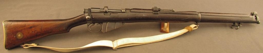

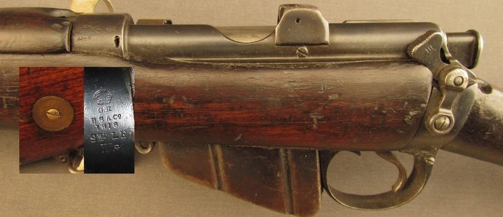

    1916 BSA... Questions
    What interests me are the features it has as a MkIII* that do not comply with what the pattern is supposed to be for a MkIII* which leads me to think it was produced fairly early. 1917 BSAs I've seen photos of have the plugged disc hole and different cocking piece. I already know my rifle was converted to a trainer around 1956 so all the S/Ns were removed. What remains is a lined out no prefix 94625 which I guess might be the original S/N. Please let me know any info you may have or your thoughts... I have a well worn copy of "The Britishicon Service Lee" Thank you.

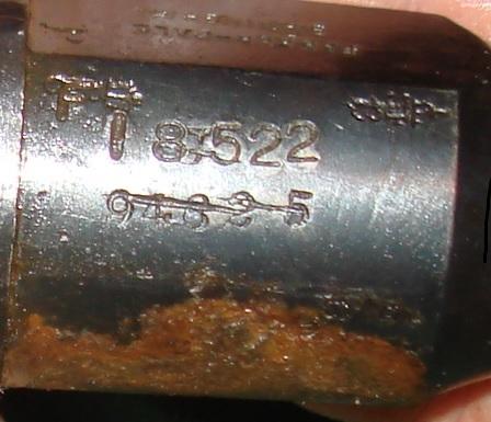

    Can you post a photo of the lined out number? It could be an inventory number if it has been in Australianicon service.

    That is not an inventory number so disregard my previous post.

    Your rifle is in the correct configuration for a 1916, read this thread here https://www.milsurps.com/showthread.php?t=56490 it should help you understand why

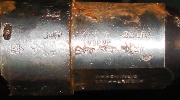

    Let me guess.
    The rifle has a serial number of AMxxxx between AM544 and AM1534. Most likely at AM1186 or above.
    Your .22 conversion was done by Parker Hale for Ireland. The barrel is a re-bored Irish Free state barrel. The unique serial number pattern was applied in the early 1920s, when Ireland was supplied with around 27,800 No 1 MK III rifles. Most were converted in 51/52 based on the Birmingham poof marks, though in the lower AM series you will see 1945 dated ones. I would guess it came from Joe Salter looking at the photo, in which case I should have the serial number in my database.
    How did di do?

    Didn't mean for this to be a trainer thread but I'm thankful to get the info. Yep I got it from Joe Salter...Now, if I understand Frederick303 correctly, you have determined it has a re-bored Irish Free State barrel by virtue of the AM 1186 S/N. I have found no FF marking anywhere on the wood or metal. I include more markings photos for identification. Can anyone tell me if the lined out S/N is consistent with how BSA stamped their S/Ns? and can it be determined approximately when it was made in 1916Does the S/N fall within the range that went to Irish Free State?

    Looking at your photos on a computer (instead of phone) you have a 1918 BSA not a 1916 & the original barrel serial number (i say barrel as you dont show a pic of the receiver number) is a J prefix the J can be seen stuck though between the 8 & 5 of the new number which appears to be F 18522
    Frederick, how do you know this is a AM rifle?
    Jim Long, is the serial number AM 1186? the chances of it being a number Frederick quoted seems remote, photo please.
    Edited to add, J would fit with 1918 as i have 2 1918 BSAs with I & K prefixes
