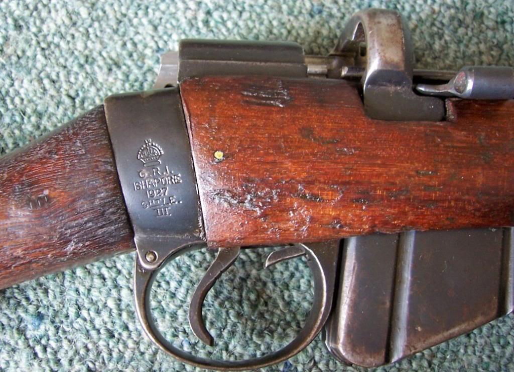

    The Indians did away with the keeper plate before the introduction of the tie plate & simply put a spring washer on the stockbolt, externally the forend looked the same as any Britishicon or Australianicon made rifle.
    The forend on my 1927 Ishapore, it is numbered to the rifle but cant guarantee the forend dates to 1927 as it could have been replaced

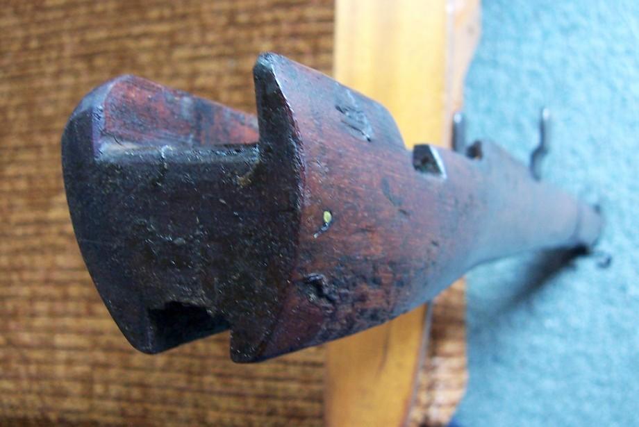

    Attachment 72870
    the indians went from this to the rear tie plate. so did the ishapore factory continue to have draws problems with splits and such? did this application not work at all?

    No, they didn't go FROM that (pic in thread 9) to the squared tie plate. They went from the squared tie plate TO the No4 type shown in fin 9. I would think that they decided, in their wisdom, that the tie plate idea used on the No4 rifle fore-ends PLUS the standard No4 rifle stock bolt (without the squared-off thread) was a better idea than the original tie plate that locked the stock bolt. The additional bonus was that it made the stock bolts and No4 type tie plates standard across the range. Just my view of course.
