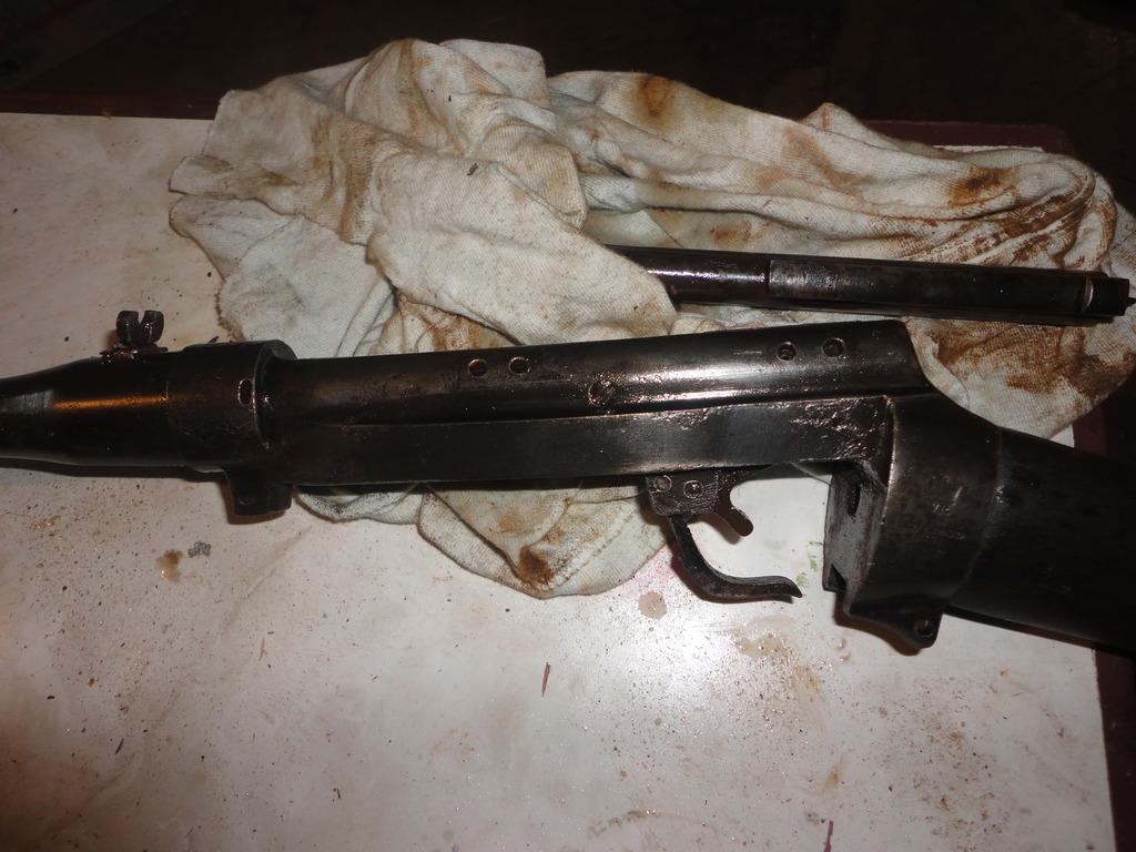

    AM i NUTS??? Saving a LEC

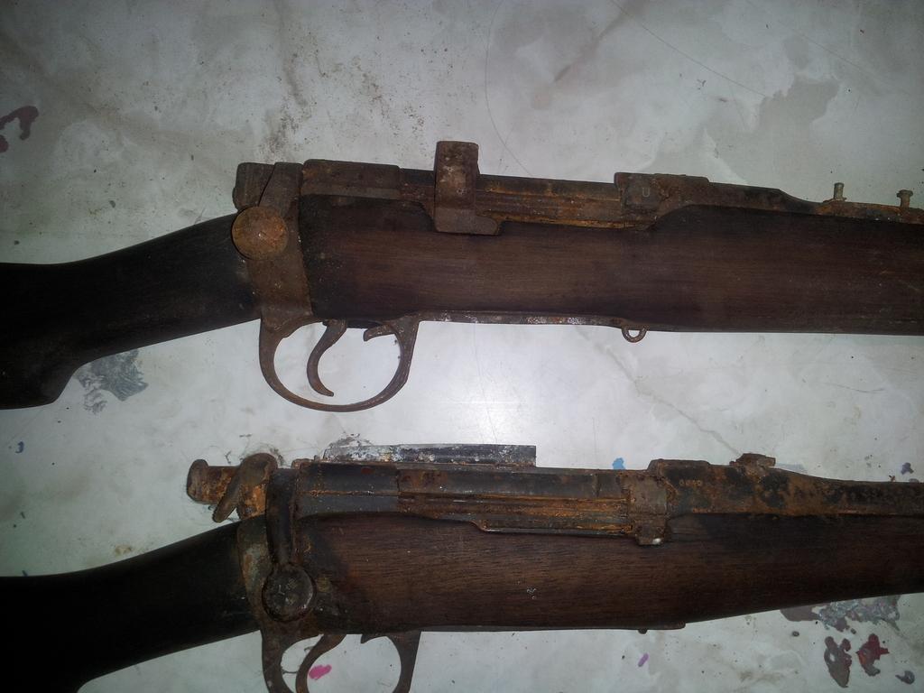

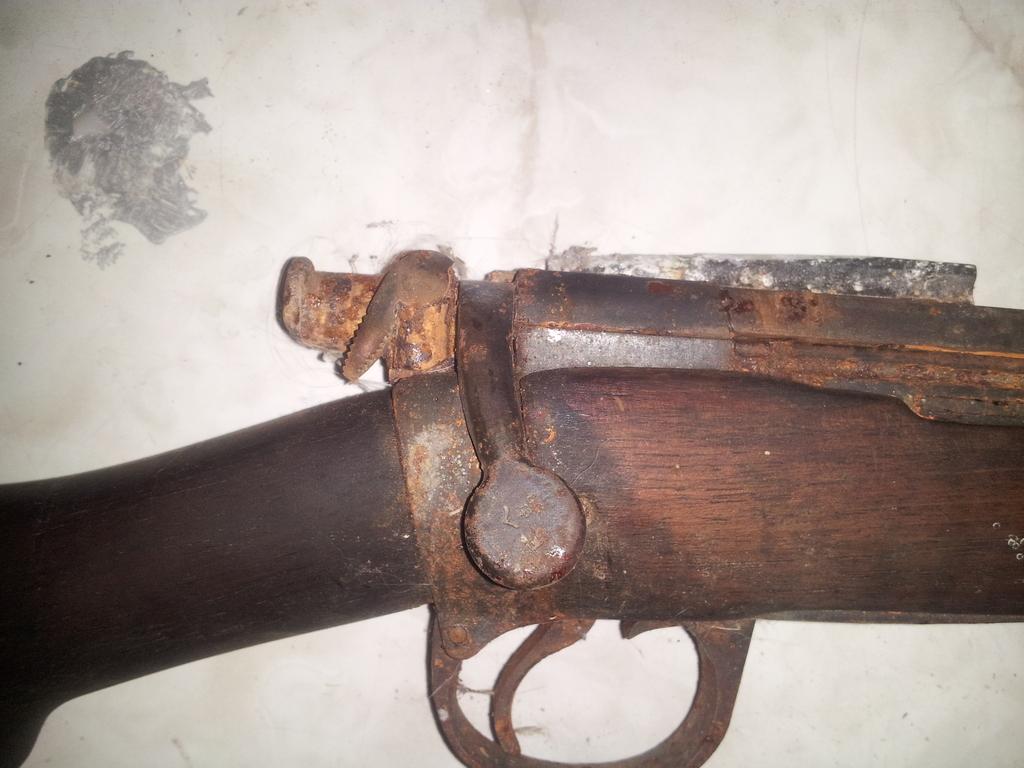

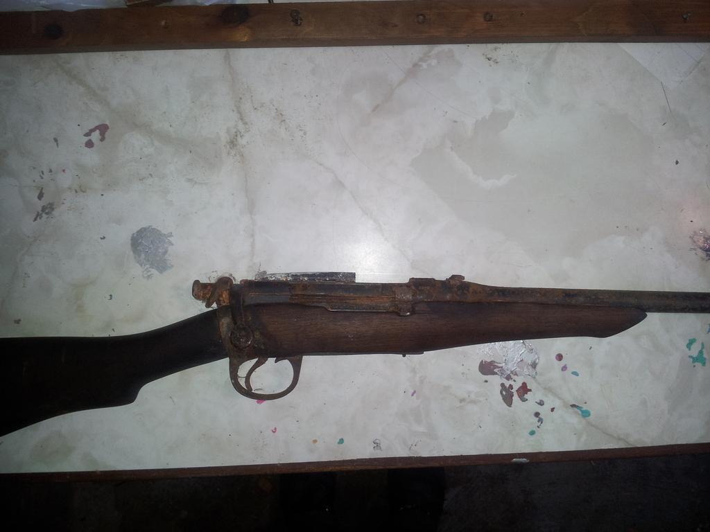

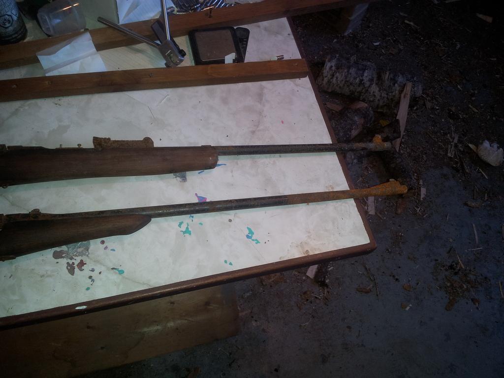

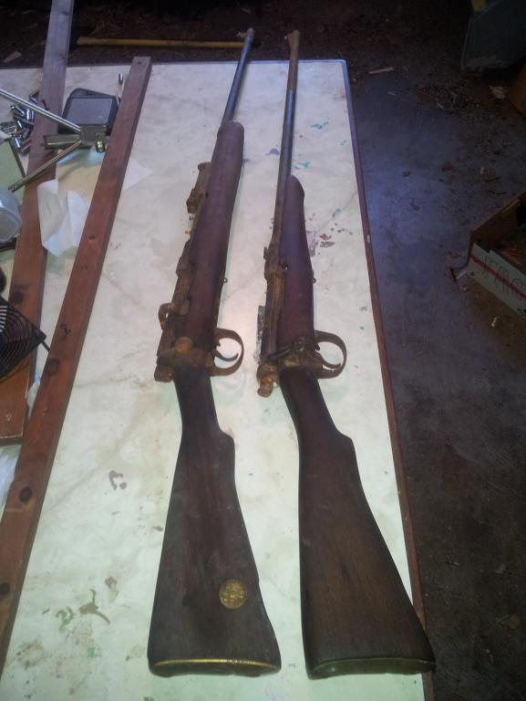

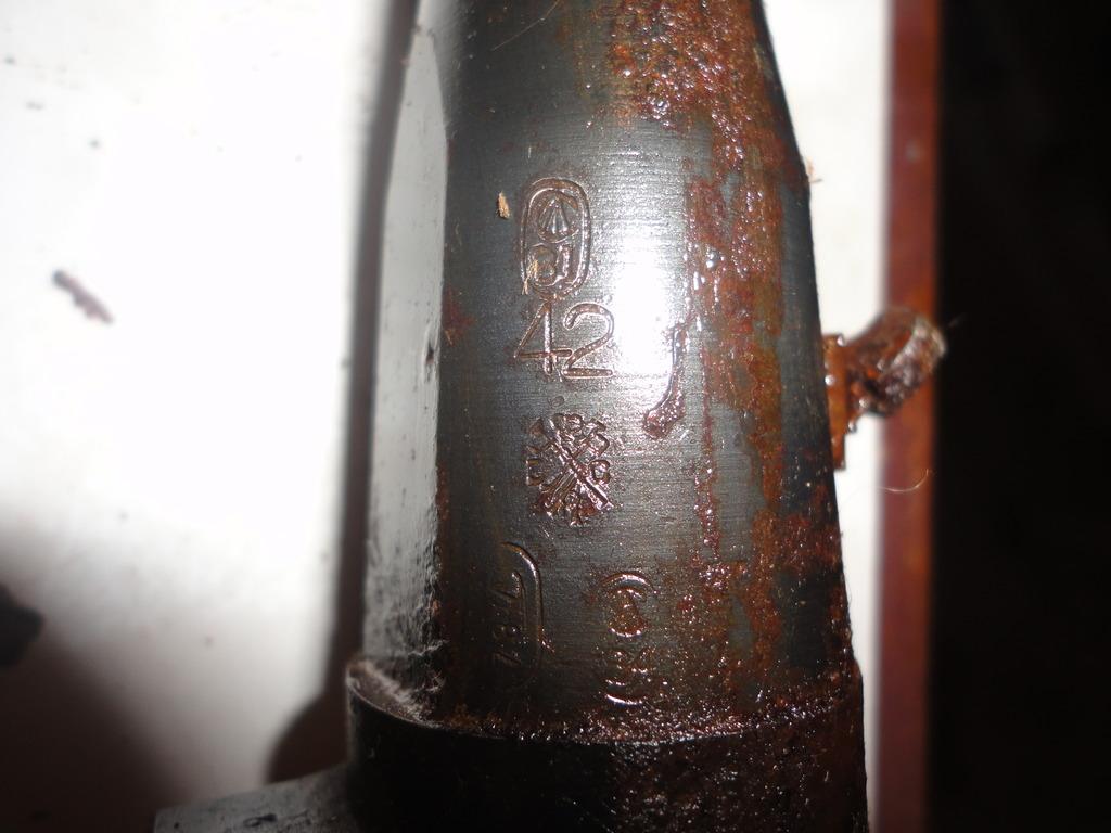

    so i was given this rifle back in the spring(2016), i was told buy a guy at work that they were "100% f**ked" and he was "going to throw them in a lake". i told him how much im into them and how i now have 7 (then, now 12) and love them, one day i hope to have a full room just filled with them, he said i could have the two 303s, i bought him a bottle of jack daniels and he was more then happy.

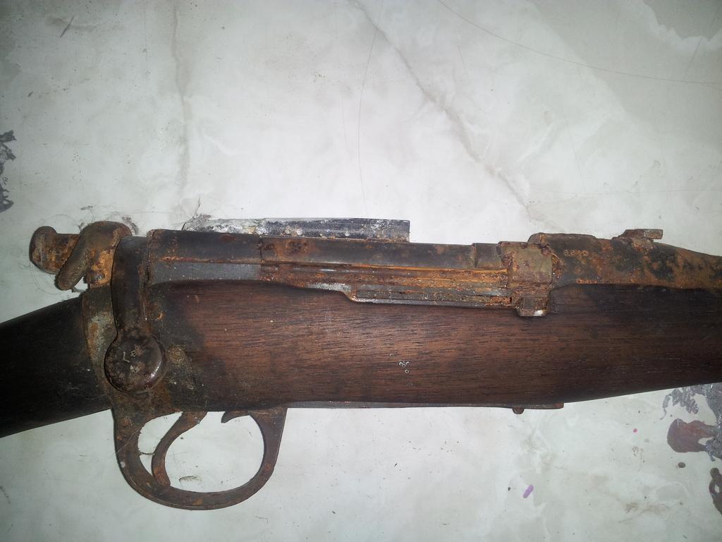

    so the next day he shows up with the rifles.....................well, he did not lie about the condition, that is for sure.
    at the time i had no idea about really any lee Enfield older then the no1mkIII's, i actually didn't know what the LEC was or that this rifle was stamped that until i got the wire bush out.
    after being told i have a "Lee Enfield Cavalry Carbine" and i google'ed them, i was hooked. anything newer then a LE1* I had lost a lot of interest for.
    ive put a lot of work into this rifle so far, more then one probably should have. but i had a strong drive from within and im unsure what fueled that drive but it was/is there.
    il post the first pics of what it looked like when i got it, and leave it for comments, then illl post the rest of the story and pics, (its now just in need of blueing and the wood set to show up in the mail) i have collected every part needed (i have to admit without Englishman_ca's help i would never be where i am today(it worked out well for him to have invested the time he did in helping me))
    the other rifle in the pics is a 1941 Lithgowicon, thats being restored to a sporter state now, basically to match my sporter no1mk3 .22 trainer and my sporter no1mk3 .410. ill have three rifles that look identical other then the barrel bore. but that is another story.
    ill post the rest of my adventure with this rifle maybe tonight or over time since i have about 100 pics to find in photobucket and copy the links with a cell phone hotspot as my connection (very slow)

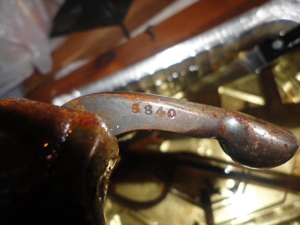

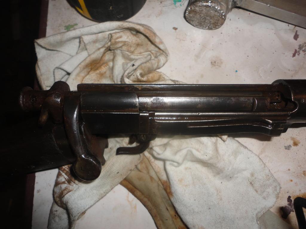

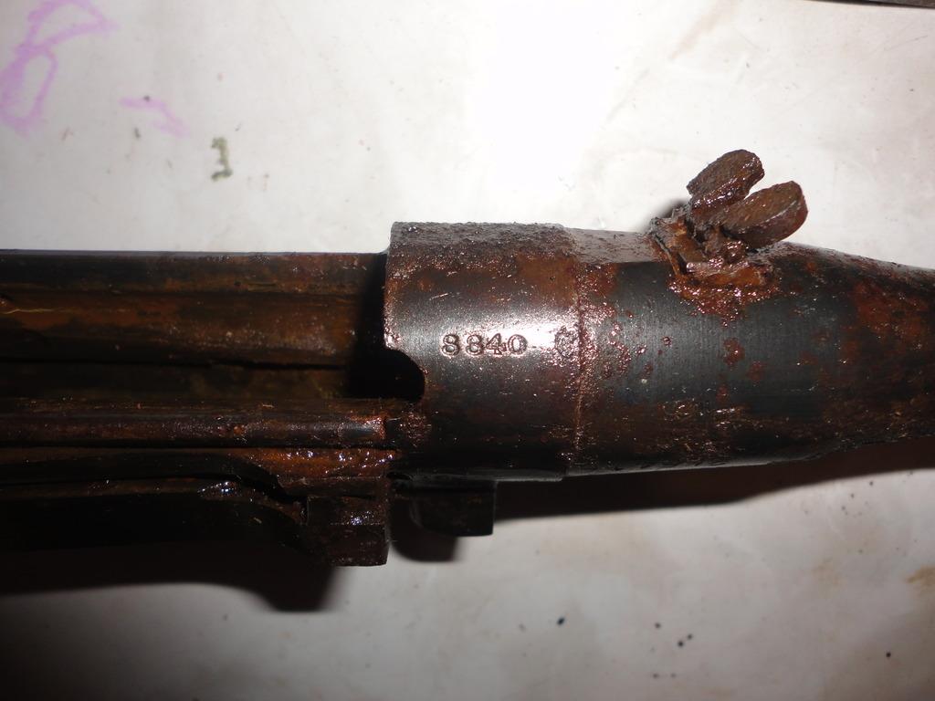

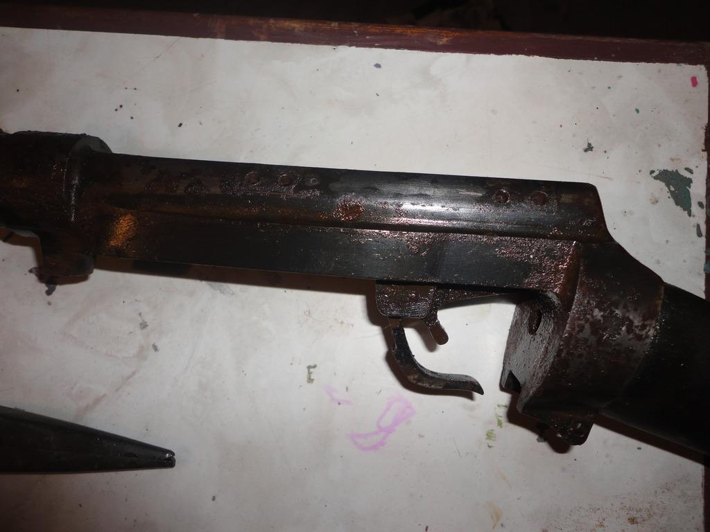

    so first things fist, i had to figure out a way to get this rifle apart. i starter slowly and took my time using a wire brush and clean and removed parts in order of now easy they came apart.
    as i was getting it cleaned up i noticed it has a matching bolt and receiver, a no4 barrel as well as the butt stock, i was in need a a few peices to make this rifle correct and started looking for them,

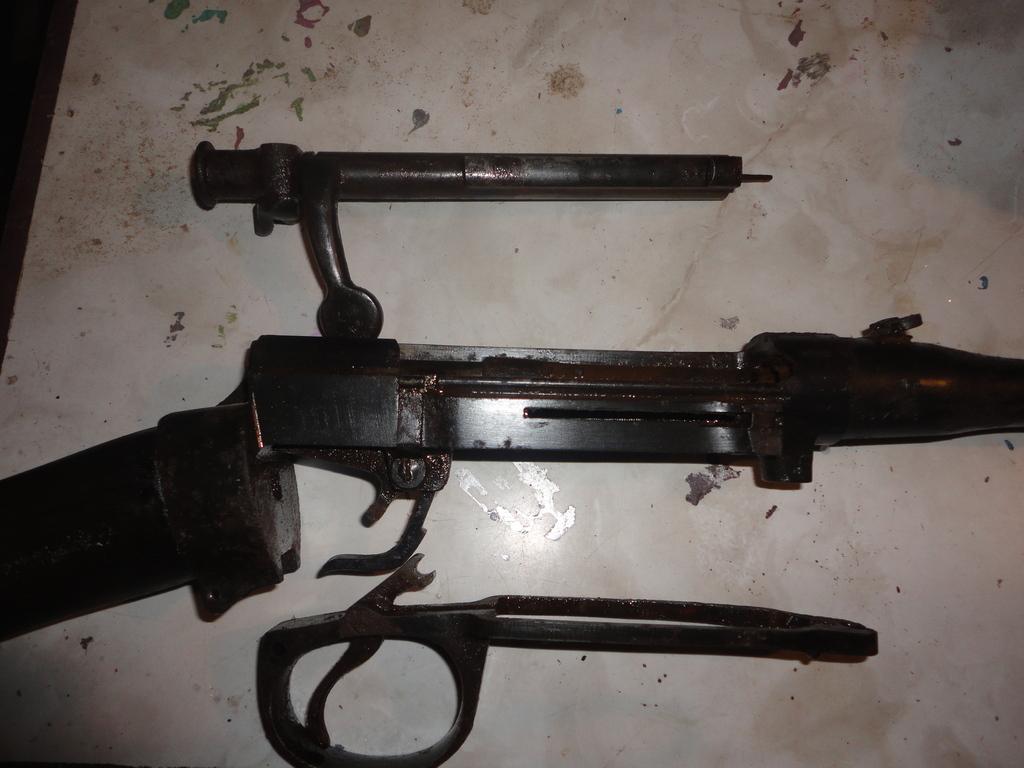

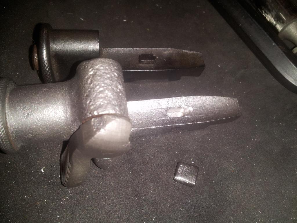

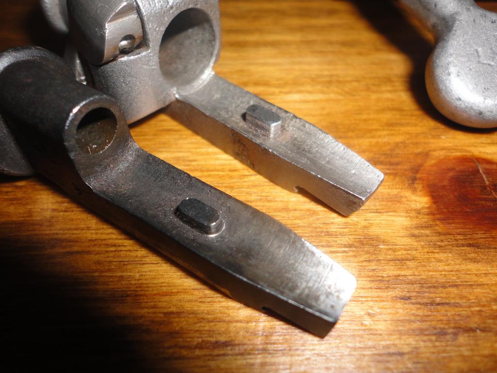

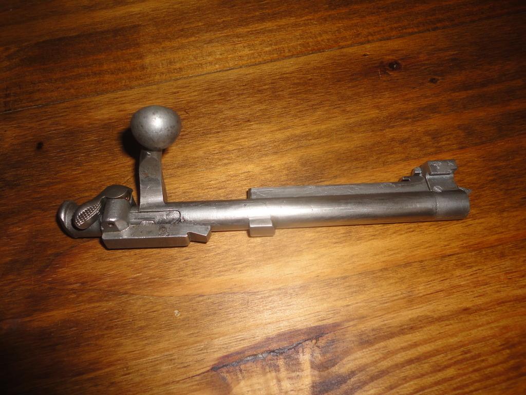

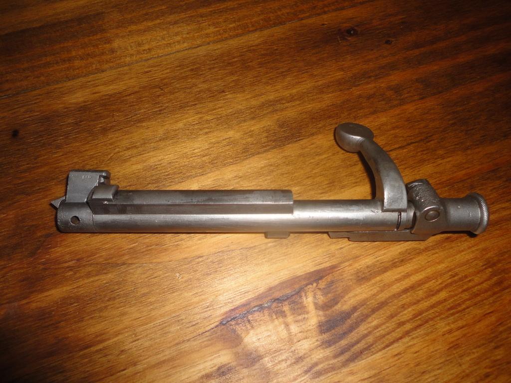

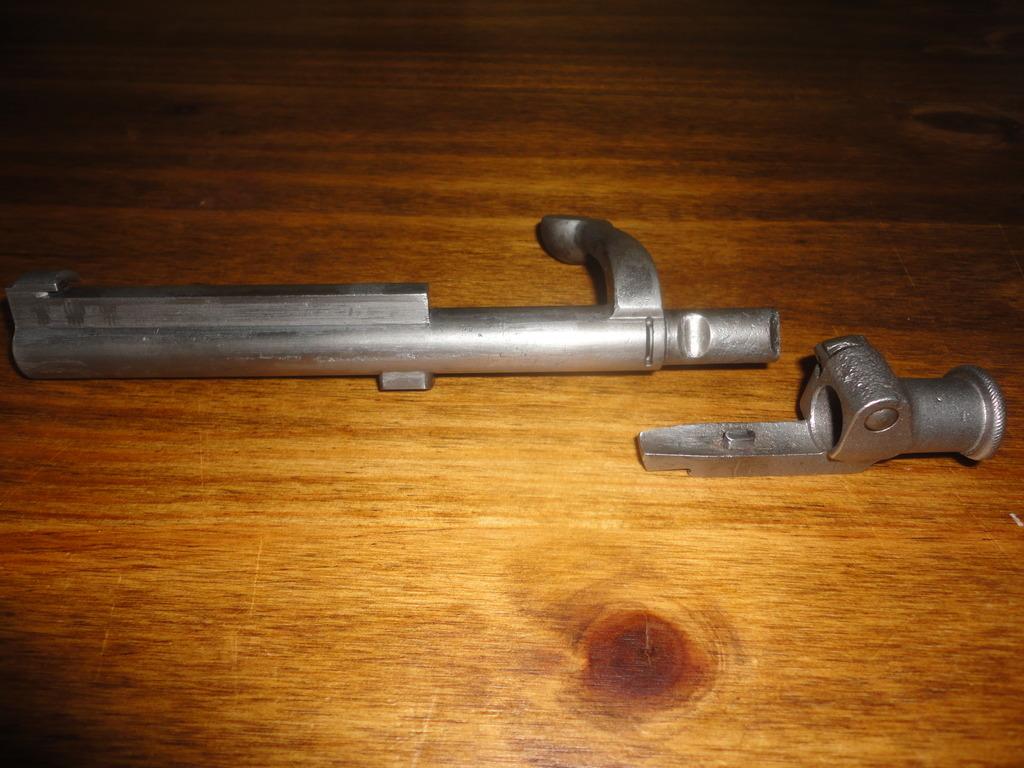

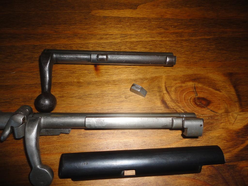

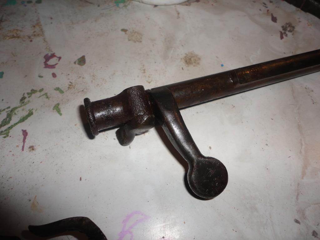

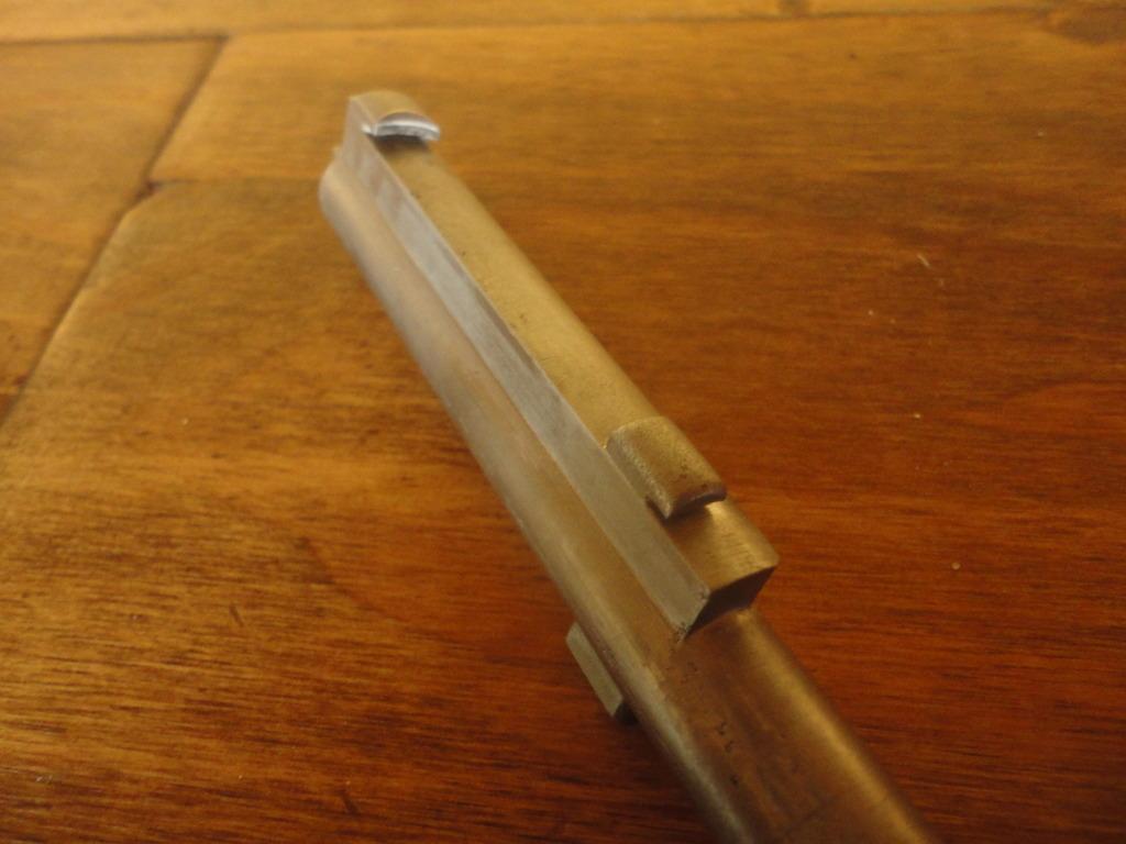

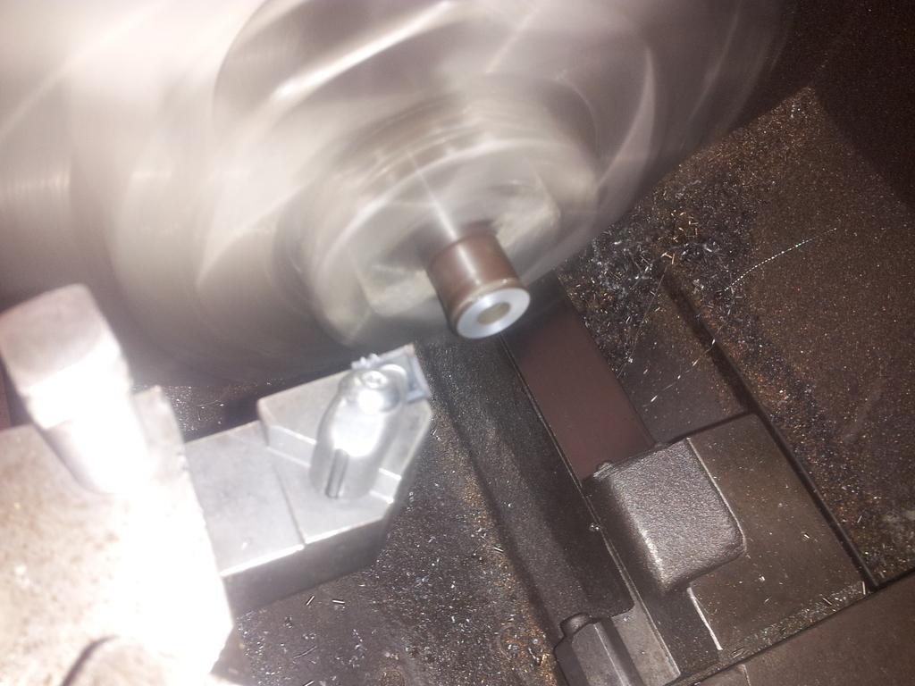

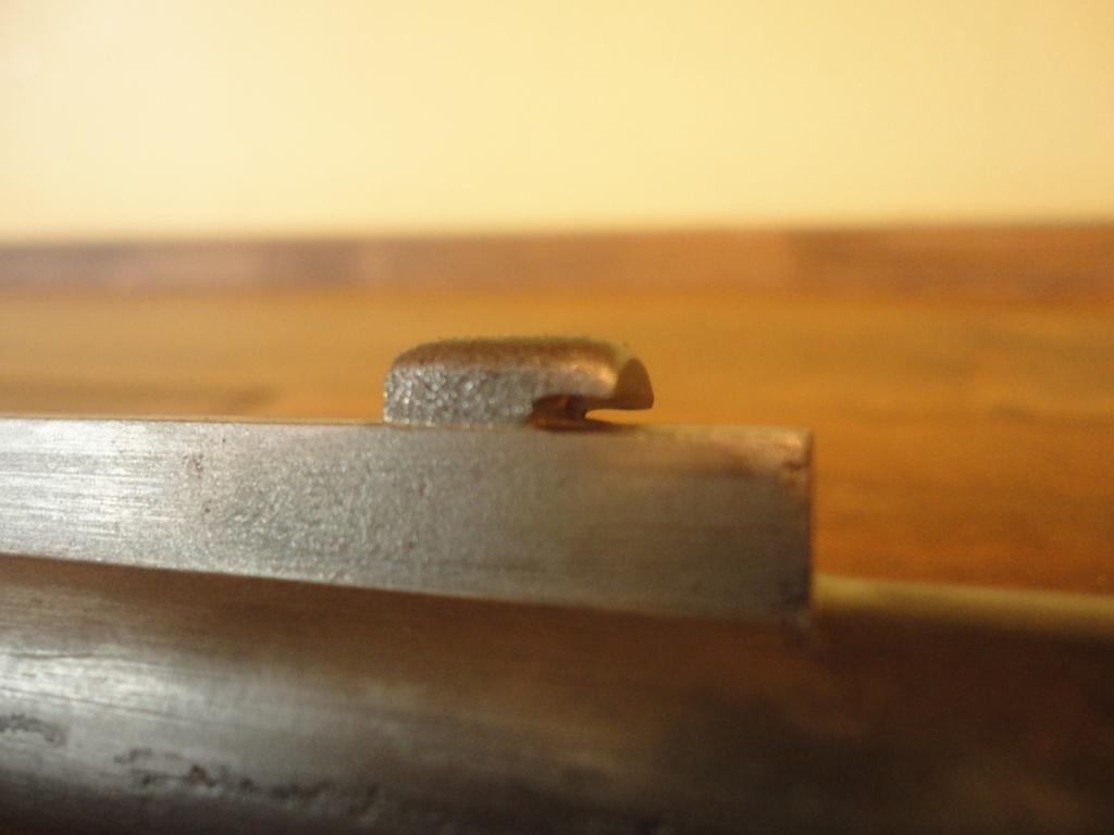

    after getting the rifle mostly apart i noticed ill need to fix the little key in the cocking knob so i fixed that up and finished cleaning the bolt as well as getting it apart. also i needed a rear lug on the bolt for the dust cover
    i borrowed a old bolt to copy the rear dust cover lug off of. i made the lug out of 1018 cold roll, and silver soldered it in place, honestly who this whole project that lug has impressed the the most, i cant believe how well it turned out lol.
    so i cleaned the bolt up and started working on the broken parts.

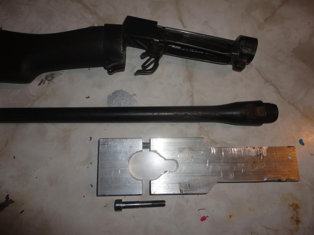

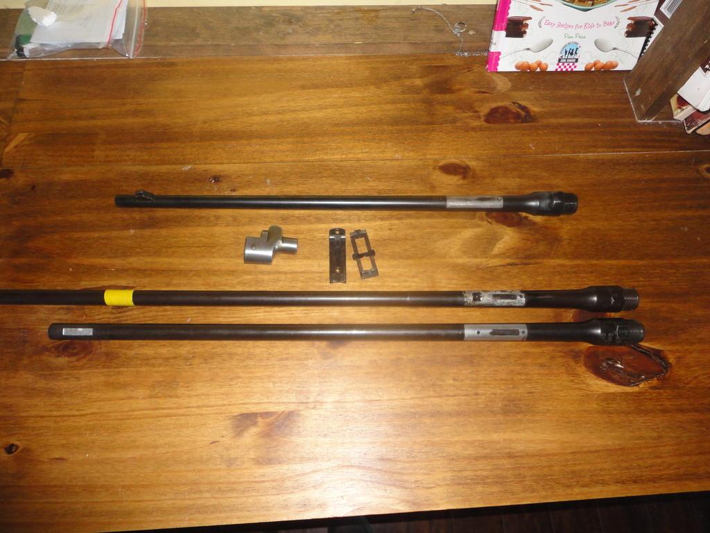

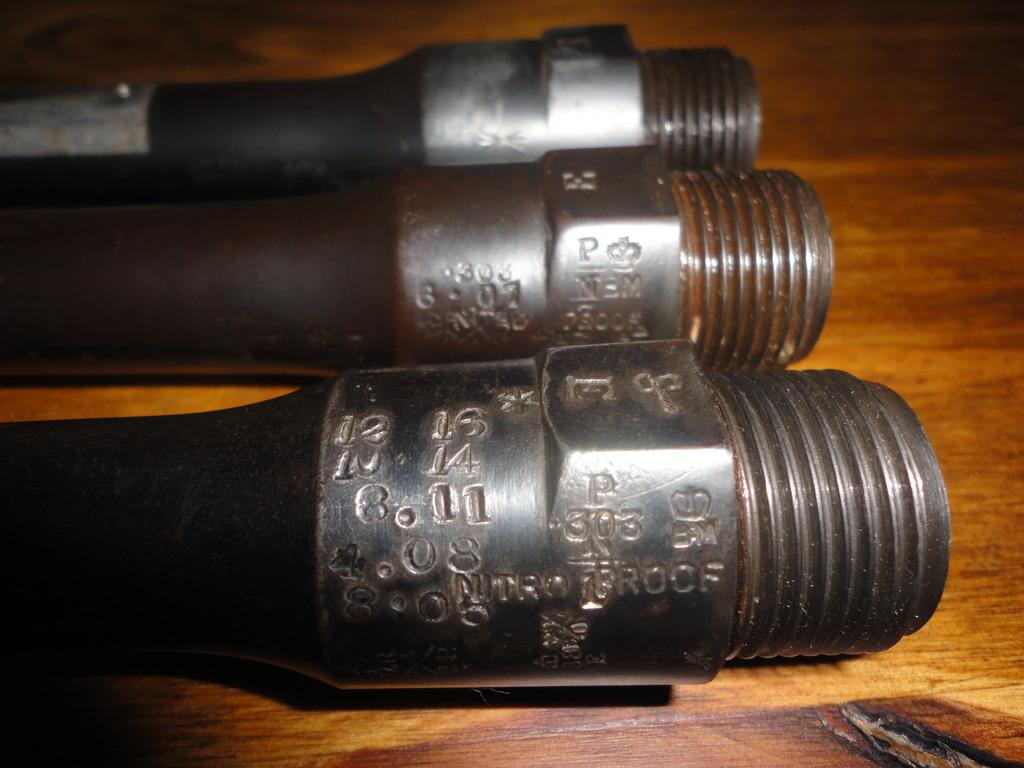

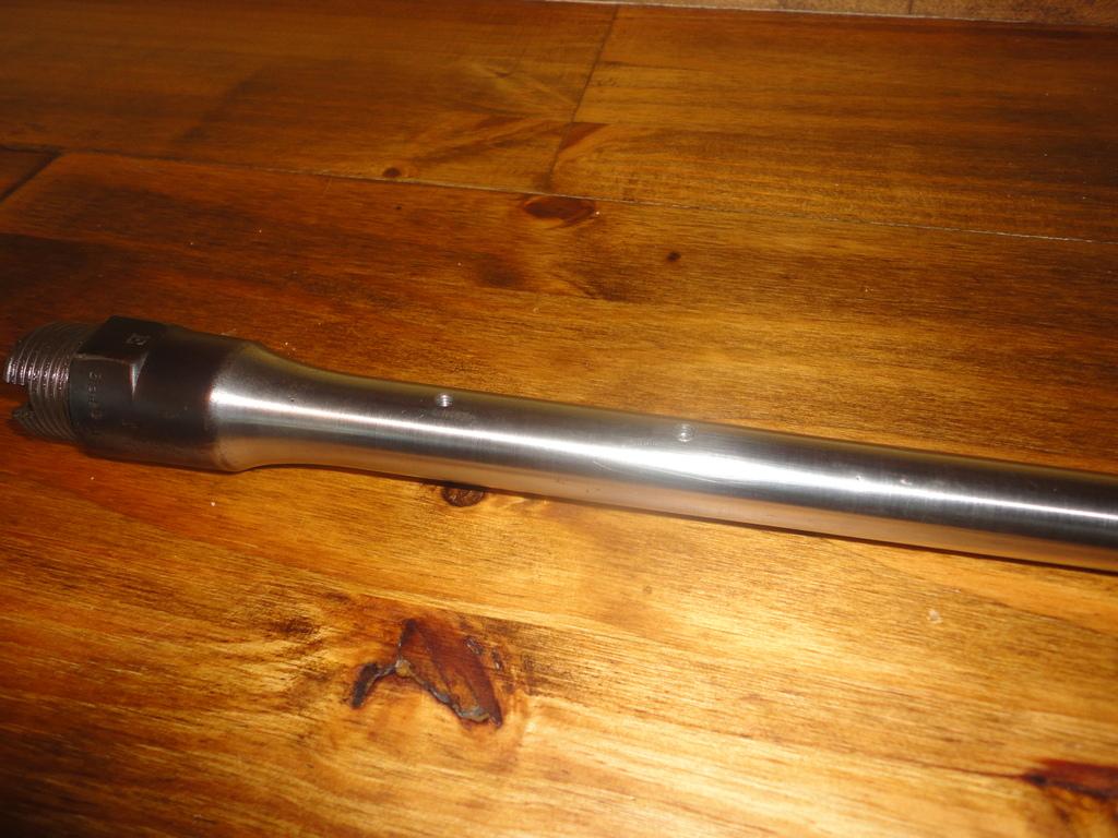

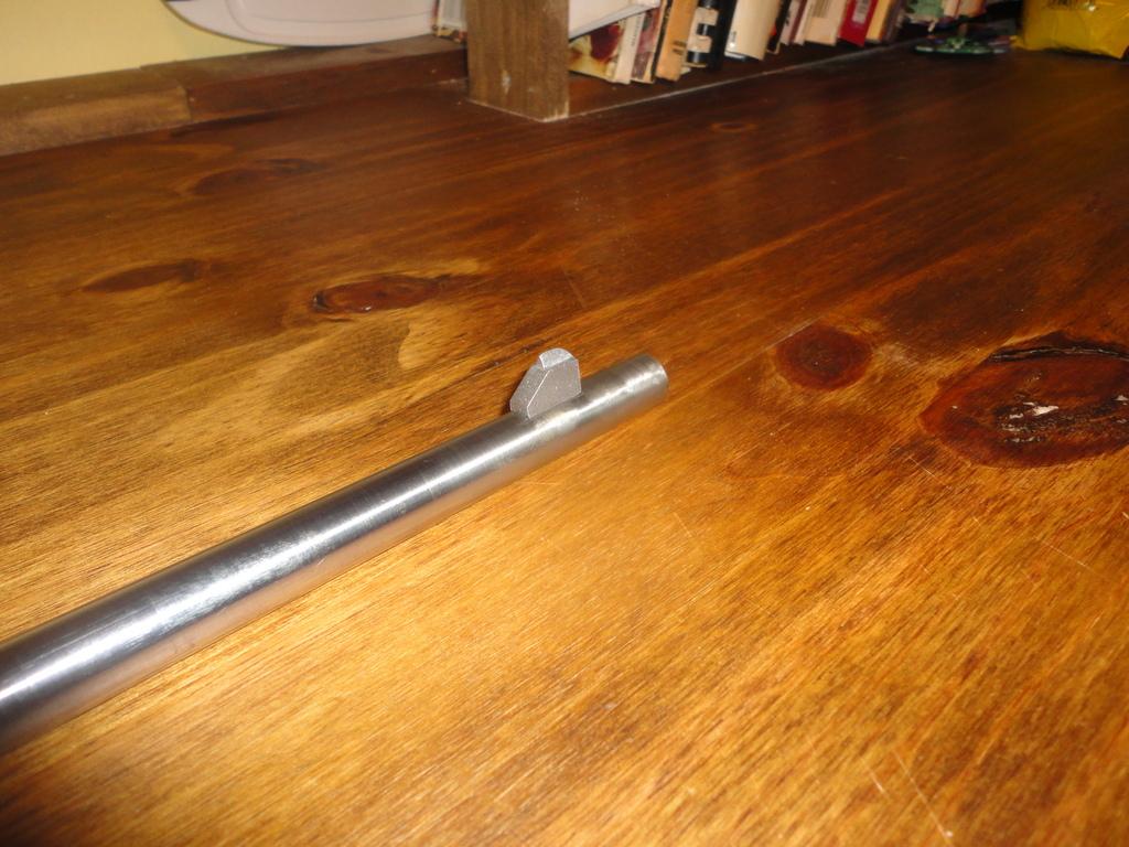

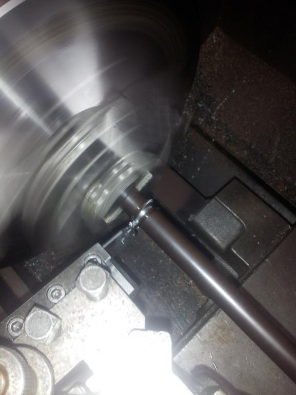

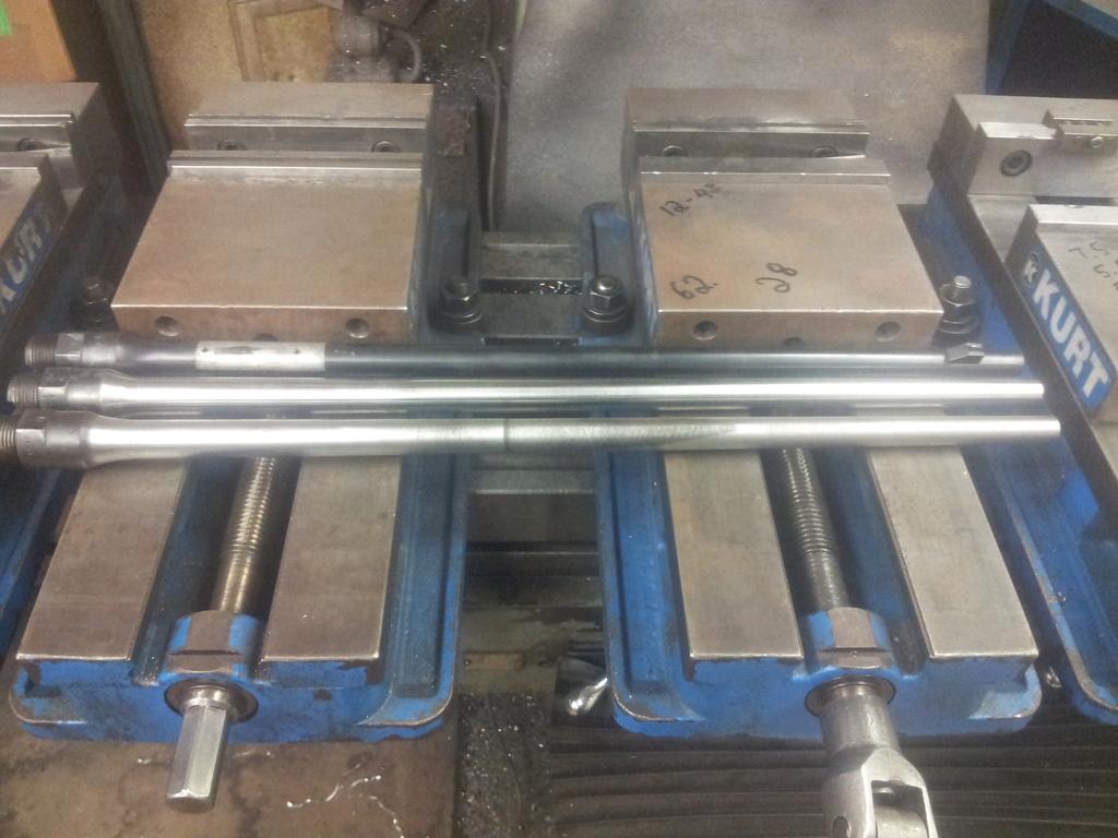

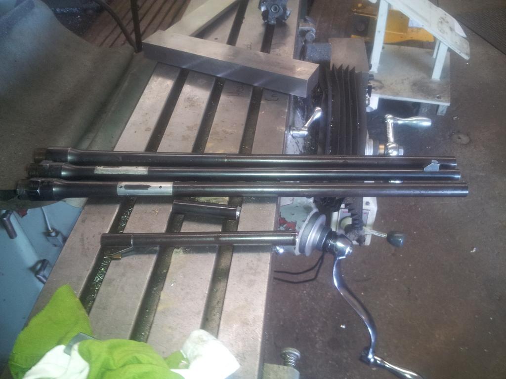

    then it was time to remove the barrel, i later used that barrel to make a 410 shotgun
    then after talks with englishman_ca i worked out a deal that got me a sporter long lee barrel to and a LEC barrel to copy the taper and length. that went well and i then had a barrel to use that would look proper. i also borrowed an LEC nose cap to copy because i was unable to find one to buy.

    it was coming a long well and i had it to this stage for a while, when i was distracted for a bit with other projects, but i still needed to fix the holes in the receiver from the scope mount and remove all the old blueing, as well as get the receiver fully apart.
    ---------- Post added at 02:23 PM ---------- Previous post was at 02:22 PM ----------
    so as of now this is how the rifle sits today and the only things left is, reblue all the parts and wait for my stock set to come in the mail with a proper butt plate fitted. then i can assemble the rifle and shoot the crap of it(check and deal with head space is any problem arises), i got the holes filled from the scope mount, you can still see the outline of them but with all the pitting there already it probably will be fine, and also i didn't want to put any more heat into the receiver, i submerged the receiver in water and tig welded the holes full, so i didn't feel like setting all that up again

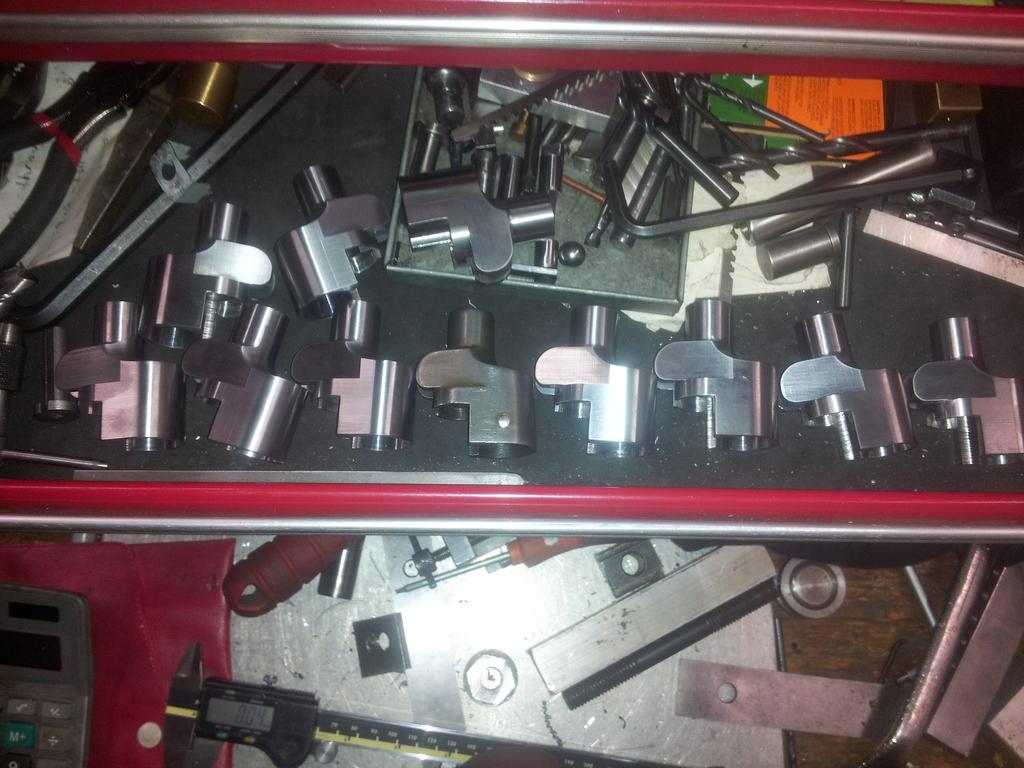

    This is what i was working on Lately, its not for the LEC but it for its bigger brother
    ILL be back on this LEC and also a few MLE's when i get back to work next month.
