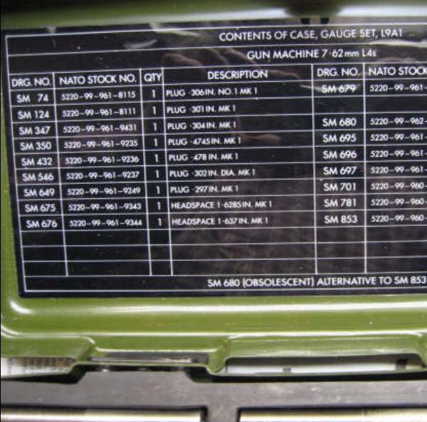

    CHS -
    ATB Kevin

    I just knew that I'd answered this earlier...... Just remembered, I did it under the Australianicon Brens thread! Anyway, maestro KG has it above for unit but Field and Base workshops, 1.634" NO-GO.
