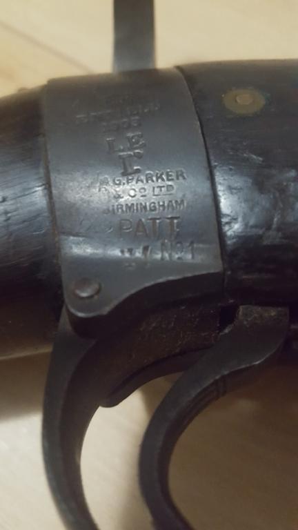

    1903 L.E. 1* ConD11 22 Patern14 No.1
    A few pictures of my pattern 14 no.1 trainer.
    1903 L.E. with sparkbrook 22 conversion in 1905?
    Some replaced wood, a gouge and stock repairs, but all matching numbers with a great shiny bore.
    Please feel free to comment.

    you need some rear sight ears

    Very nice, one of my favorite rifles. Can you check the top of the butt near the butt plate for a rack number? I have observed from "C1"(sold it to a friend in a moment of weakness) to as high as "C539" giving the reasoning that Australiaicon received at least that many.
    A correct handguard can be found if patient and willing to spend the $$.
    Good luck.

    Does the rifle have any markings linking it to Australiaicon?
    The TAS marking on the stock disk makes me think The Armidale School, a local private school (public school to the british). They have thier own small bore range, cadets and a quick google shows the school "shooting club" dating back to the 1890s.

    I read it as the conversion to Sht.LE Cond.II was done in 1905. The subsequent Pat 14 .22 conversion would be done at least 1914 onwards.
    What I do note is that the bolt head is a unit from the center fire 303 converted to rim fire. I was under the impression that on conversion the bolt heads were switched out with purpose made ones. Apparently not. I just learnt something!

    Is that a sprinter barrel?

    Not sure! how do I tell?

    I have no stamp at all on top of my butt in front of the buttplate.
    ---------- Post added at 08:46 PM ---------- Previous post was at 08:45 PM ----------
    Quote Originally Posted by henry r View Post
    Does the rifle have any markings linking it to australia?
    It has a U stamp on the top, front of the receiver.
