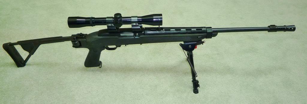

    RUGER 10/22
    Using it in the above rifle I find Winchester Sub Sonic a very tempremental beast, stoppages every other round, bad feeding, probably due to the length, where CCI seems to go through it OK with fewer stoppages.
    I tried a better round altogether.........ELEY FORCE High Velocity no stoppages worked really well through the RUGER and the CHIAPPA.
    Anybody else got any knowledge of this little beauty!! No stoppages at all.?
