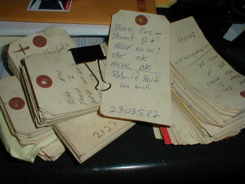

    M1D sheet I have been working on
    Here is a little blib from the tags I have from 163 M1D's that were imported back to the U.S. in 1992 . Rick Bicon
    Imported M1D's thru Federal Ordinance 1992
    Serial #,, Bore,, Throat ,, HDSP ,, Stock ,, MCHL ,, Broken or missing ,, parts Replaced Parts
    2664548 Excellent 3 NoGo OK Ok
    2734471 Excellent 2+ NoGo OK Ok
    2738393 Excellent 2 NoGo OK Ok No sling
    2762850 Excellent 2+ NoGoOK Ok No cheek piece, Rebuilt Bolt Follower, firing pin, extractor / spring assy, ejector spring
    2769858 Excellent 2- NoGo-- OK Ok No sling
    2786706 Excellent 3 NoGo OK Ok Follower, firing pin, extractor / spring assy, ejector spring
    2789941 Bad barrel NoGo OK Ok Buldged barrel
    2801356 Excellent 2 NoGo-- OK Ok Adjusted Op rod
    2819671 Excellent 3 NoGo OK Ok
    2825104 Excellent 3 NoGo OK Ok Rebuilt bolt Follower, firing pin, extractor / spring assy, ejector spring
    Last edited by Rick B; 02-18-2019 at 09:18 AM. Reason: Tried to straighten it up. Format will not allow a copy in same order It straightens up the text on its own ruining it.

    M1-d
    Rick Bicon
    I have an M1icon-D that was imported to the US by Federal Ordnance. Would you be willing to send me a copy of the data tag or the data tag itself if you happen to have the one for my rifle? I'll send you the serial number via PM if you are willing to do so.
    Thanks,
    Rick B's Avatar
    Yesterday @ 03:23 PM
    Hinckley, Ohio
    510
    RICHARD BORECKY
    05-05-2025
    05:23 AM
    Yes Asin, send me a PM with a Email to forward scans for you if it is in this batch. I have put the compete list together but still not sure what I am going to do as a whole. Rick Bicon

    How and where are these import marked ? I'm just wondering if I have one of these.
    Rick B's Avatar
    Hinckley, Ohio
    510
    RICHARD BORECKY
    05-05-2025
    05:23 AM
    They were marked dead bottom of the barrel between the gas cylinder and barrel. You have to look to see it as it doesnt stick out. Rick Bicon

    Serial number
    Rick,
    PM sent with serial number and contact information. Thanks for taking the time to look.
    Rick B's Avatar
    Hinckley, Ohio
    510
    RICHARD BORECKY
    05-05-2025
    05:23 AM
    Quote Originally Posted by asin View Post
    Rick,
    Info sent back and yours was in the group. Hope it helps. Rick Bicon
