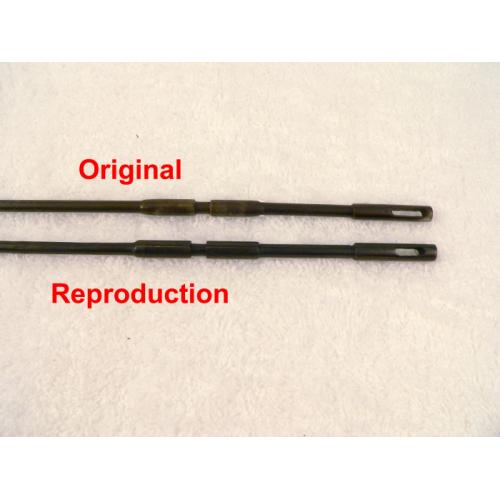

    With any Arasaka you want to check the stock for a correct finish, this is a huge factor many have been refinished. You want original, not redone. Make sure the bolt matches. Make sure an original cleaning rod is present, most have reproductions.
    72 USMC, Thank you for all the information! I have taken a great deal of notes and will go take a second informed look at the rifle today if it's still there; from what I have read here I may have a winner. The only question I have now, is how can you tell an if what there is the original cleaning rod? I did read about it but there but the only thing I found was this picture, I'm guessing it would be the shape of the two lugs the orgainl lugs looks to have a gentle, smoother, and longer end taper.
    Thank you again for the help.
