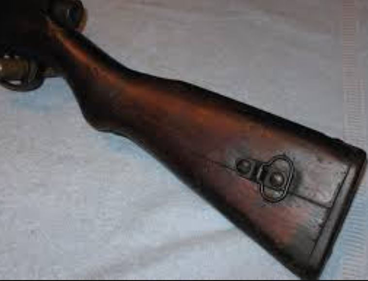

    Anyone know why there would be a square area cut out in the rear lower area of the butt? Is this intended for a strap maybe?

    Quote Originally Posted by dannytoro1 View Post
    Like this?
