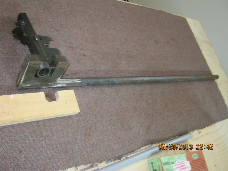

    I'm new to the Garand & could use some info. I have a M1icon Garand Springfield dated around mid 54 . The bolt is a new Springfield heat # A 14 I think it is correct for the receiver. I also need a barrel. I can get 2 barrels a Springfield short chambered 1955 barrel and
    I can also get a new Springfield 1954 barrel that has all ready been reamed but not on my receiver Would the head space be ok on that barrel ??? I was told that the head space should be ok ?? . I don't know witch barrel would be the best to take. And is the Pacific Tools GO & NOGO good to use. I guess there is 2 questions there. Thanks for any help. Thanks for any help.
