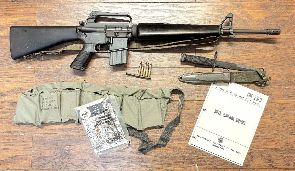

    My California Compliant retro ARs
    1967 vintage XM16E1
    -Upper is a large front hole CH forge 603 upper from an early AR15 Sporter II rifle that was parted out. Offset bushing installed
    -Bolt Carrier Group is Nickel Boron M16icon BCG (too cheap to buy chrome)
    -Lower is a 1989/90 vintage tool room prototype XM177/GAU-5 lower from a USAF commemorative project I had when I had a
    manufacturer's license. Serial "Proto 1". The CA Roberti Roos Assault Weapon bill killed the project before it started production.
    -2000 vintage Colt [S] Lower parts kit with Juggernaught "hellfighter" kit for Commiefornia compliance
    -Barrel is a H&R (PSA) 20" chrome lined M16A1 "pencil" barrel and slip ring. (I got 1/7" twist to shoot my MK262 MOD1 77 grainer 5.56
    -Flash hider is original M16 Bird Cage
    -stock and handguards are original XM16E1 set with Type D stock, no trap door, of course, and an original "fat" mottled pistol grip
    -Colt 20 round magazine (blocked to 10 for Commifornia compliance
    -Original "seatbelt" sling.
    -Original Vietnam era M7 Bayonet and M8A1 sheath
    -Original "comic book" manual (1967 edition) in original plastic sleeve
    -7 pocket bandoleer of M193 55 grain ball ammo
    -Reprint 1966 XM16E1 FM23-9 manual
