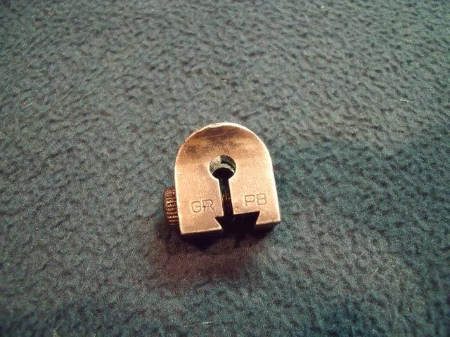

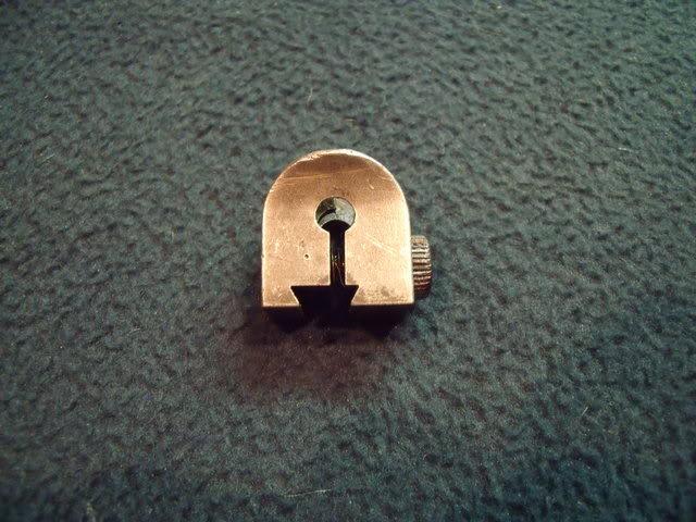

    Quote Originally Posted by LavaTech View Post
    Although Beretta did receive the worn and outdated tooling from Winchester along with JCG's production flowcharting and an unknown number of Winchester parts in varying stages of completion, they elected instead to build their own tooling to fulfill their NATO contract. They did stamp the parts they received with their mark, and both Winchester and PB markings are encountered on the same part. Breda MAY have elected to use the Winchester tooling, but I've no idea. Beretta didn't feel it was worth their time.
    That may explain this little guy.
    JR
