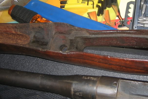

    Banned Edward Horton's Avatar
    Jan 2008
    09-10-2011 @ 01:42 PM
    Harrisburg, PA USA
    74
    935
    05-09-2025
    02:22 PM
    spinecracker
    I don't know if you noticed but it looks like your fore stock was regulated by Fultons. Your trigger guard bushing was removed and the wood around the bushing has been cone shaped.
    Your fore stock.
    A fore stock that belongs to RJW NZicon that was regulated by Fultons.
    And a unmodified fore stock.
    And a fore stock with a hare trigger
