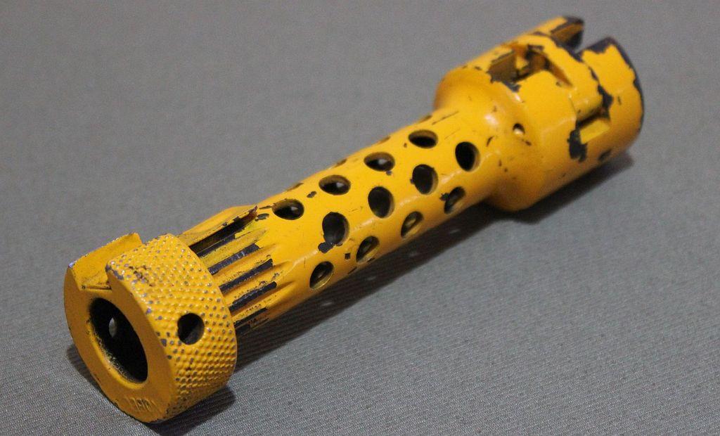

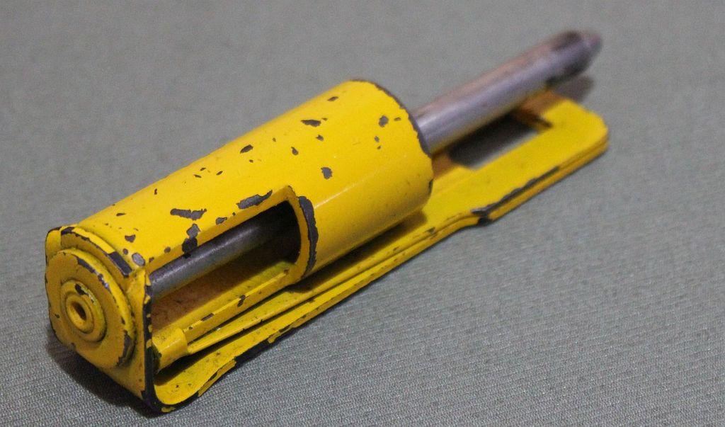

    Canadianicon C1 BFA
    Canadian C1A1 BFA
    Britishicon L1A1 BFA
    British L1A2 BFA
    British L1A2 (modified) BFA
    British L6A1 BFA
    Australianicon F1 BFA
    Australian F1 BFA for the L1A1-F1 Rifle

    I only remember the ones that were clamped on (pics 4 and 5) plus the big head banger type (pic 6) but the rivetting and large rivet are clear. You can see the 'U' bend where the spring part would crack across and eventually break* There was a special tool for reinforcing/re-rivetting the L1 type. I seem to think that they were made by a small sub-contracting firm called JETAGE or JET-AGE in West Bromwich who made lots of small parts.
    These cheap pressed steel BFA's were a bone of contention when the big workshops were privatised to ABRO. They would be sent in to be acid dipped to clear the carbon, stripped phosphated and repainted with high oven bake paint. But because everything was costed on a commercial basis. But due to the quantities being done, especially at the large training centres, the actual cost per unit was absorbed into a average cost per, say 10. That is where 5 would need a new choke tube, 6 would need new clamp springs, 5 would need new sliders..... You know the sort of thing.
    You would come out with an aggregate cost of repair. THAT cost exceeded the cost price paid by Ordnance!!!!!!!!!! As a result it was uneconomic to repair/rebuild or even repaint them at any level past the unit level. So they were used and cleaned repeatedly until they went black and were replaced with new.
    Some units would clean and respray with shake cans to prolong their life but that was really just a one trip quick fix. Different with the big head banger ones though
    *were these breaking a problem with you Tankie and Skippy? Not a particular prob in the 60/70's to me. Never saw it highlighted as suck. Just working loose which was a fairly simple tighten up job every so often
  11. #6
    Today @ 09:08 AM
    30,997
    04-26-2025
    08:42 AM
    The C1 BFA, if it's meant to be the Canadianicon one is broken. Ours were the same as the L1A1 BFA. The spring is missing and it is in danger of flying off. Also we painted our yellow, same as the L1A1. The one you show has been stripped of paint and would be classed as unserviceable.
    The C1 BFA was the first BFA to be developed and issued, but didn't last long because it would fly off so the extra sliding locking spring was added creating the C1A1, or in Britishicon service the L1A1 BFA. The C1 BFA's were withdrawn from service.

    We had damages at the front bottom of the outside spring attachment where it would break and the inside spring would retain it. I took that spring off a couple times and tried it without and found it was required... Never saw a spigot come off completely. Even if it did, I think you'll find it's too big to go inside the bore. It's designed to PLUG the end of the bore and just fit in the F/E. We also found that using a hose clamp to retain our would almost guarantee the broken BFA. I always thought it was because of lack of flexibility when it was firing.
