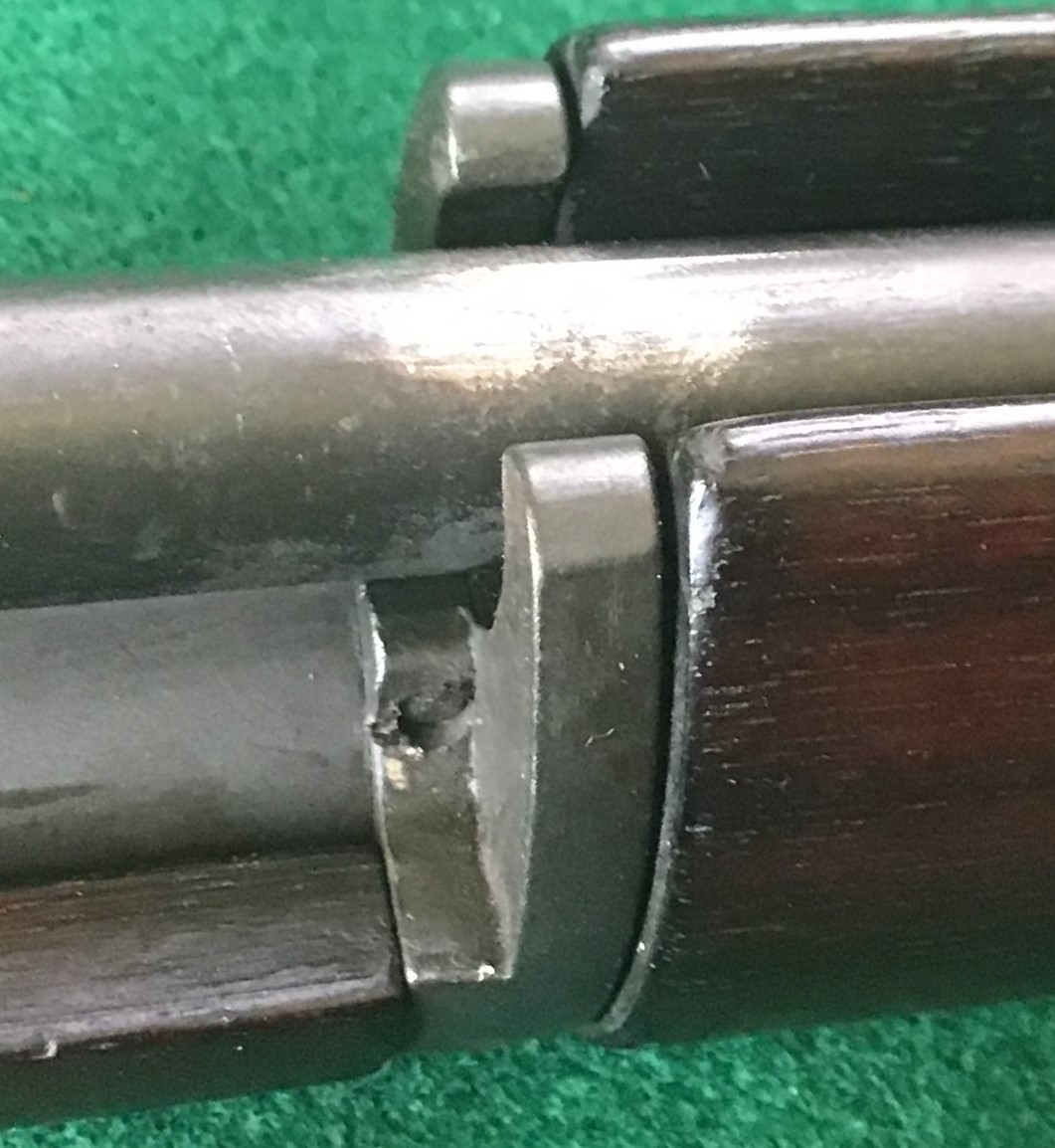

    Lower Band
    The issue is not whether the pin is in place, it's whether it shows signs of having been removed or replaced. That is a strong sign of originality, you can't rebarrel a receiver without taking it off. The best telltale is undisturbed original staking.
    Attachment 123406
    Interesting, thank you!
    In this regard, if the pin is missing but there are no signs that it was removed, does this mean anything?
    Is it possible that they could just fall out on their own?

    It's unlikely that a lower band pin would fall out on its own because they were staked in place. As you can see in Mr. Seijasicon' photo above, there's a bit of metal that's disturbed on either side of the pin. That was done so as to prevent the pin from coming loose and falling out. I've never seen a truly original, unmolested example that didn't have the pin in place. I suppose anything is possible, but I'd be highly suspect of such an example that claims originality but has a missing lower band pin.
    Thank you for the reply!
    I would assume as much that there’s no feasible way it would fall out on its own with indented metal to keep it in.
    Moreover, is it safe to assume that on these completely undisturbed rifles the staking is only on one side of the lower band? And evidence of disturbed metal on both sides is rather suspect?
    I am just on the lookout for an all original rifle, and am taking all of these details into consideration so I know exactly what to look for.

    Sorry, not convinced by the photo
    Well Bob, maybe it’s just my eyeballs, but the “staked” region in that photo looks very untidy. The few examples I have of staking show one clean dimple from a punch. That area looks as if it had been struck at least twice - first at 8 o’clock and later at 9 o’clock. As it might appear if, for instance, the pin had been driven out, replaced, and then staked again.
    It is noticeable that the position of the head of the pin in that photo is rather deep. Which would happen if, just maybe, the pin was driven in flush on the other side.
    To form a clearer opinion, one would need to see a good close-up photo of the other side.
    I had one of the LL rifles that still had it's solid pin and looked exactly like that. Looks like they used something with a chisel point. It's the "Solid pin" that matters too. They changed to roll pins about 1952(?) I think.
