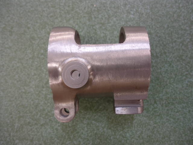

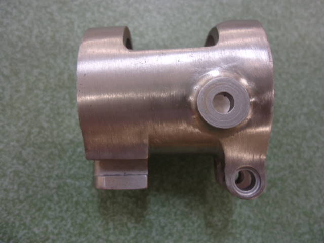

    Small update.... these parts are sub projects all in themselves and require lots of work.
    The ''band'' portion of the P14 nosecap/bayonet band was removed.
    A new position for the cross screw was made by welding a piece in the new location.
    Metal will be build up around it and properly shaped.
    The old screw holes will also be filled in.

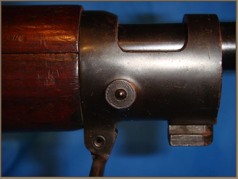

    Here's what the original looks like

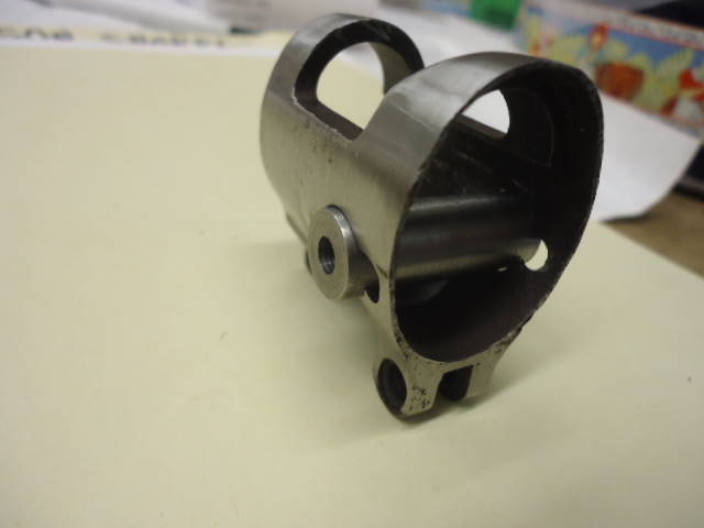

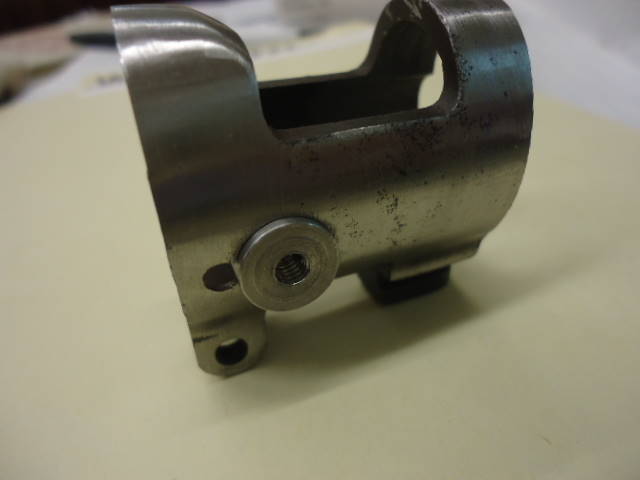

    It's coming along nicely
    Making something as this isn't easy when all you have are pictures.
    I just found out that the cross screw is similar to the one of M1903 (after this part was done)
    Thank you Promo for the help
    On an original screw the treads are just below the head...so the corresponding treads on the band are on the left, NOT on the right side like on the MLE's or the SMLE's.
    No biggie ... at least this way no one will confuse it for an original, it will still look similar from the outside.

    Not much of an update... but i haven't given up. NEVA !!
    Covid is really making things go slow but it will get done.
    The Nose cap is done and blued... another part scratched off the list.
