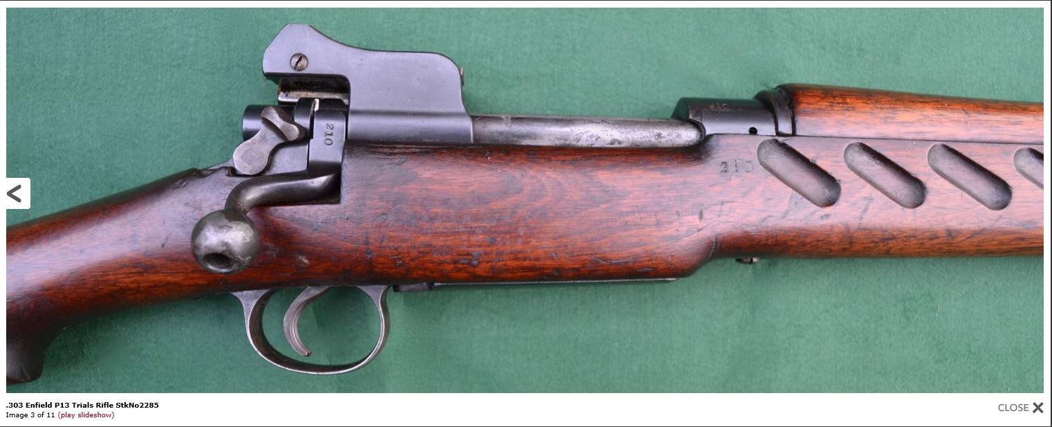

    Presumably it was once a target rifle, but what rear sight those adaptions were made for is an interesting mystery.

    I do agree that there are good chances this was once a target rifle.
    Not by the rear sight adaptations but rather by the look and profile of the barrel.
    First, it's a ''bull'' barrel and second the barrel does look similar to the one posted by ''MK VII'' in the 5th post of this tread.

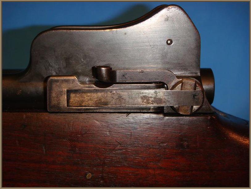

    There is no mystery behind what sight was fitted to it with those adaptations (i call them washers).
    The rifle was posted 7 years ago and it was fitted with a Sherman tank scope.
    I doubt very much any target shooter would have used such apparatus.
    Also, having held and examined the rifle for quite some time i also doubt very much a target shooter would have allowed his rifle to be so crudely ''carved''
    Those guys take good care of their rifles and this was poorly made... strong, but crude.
