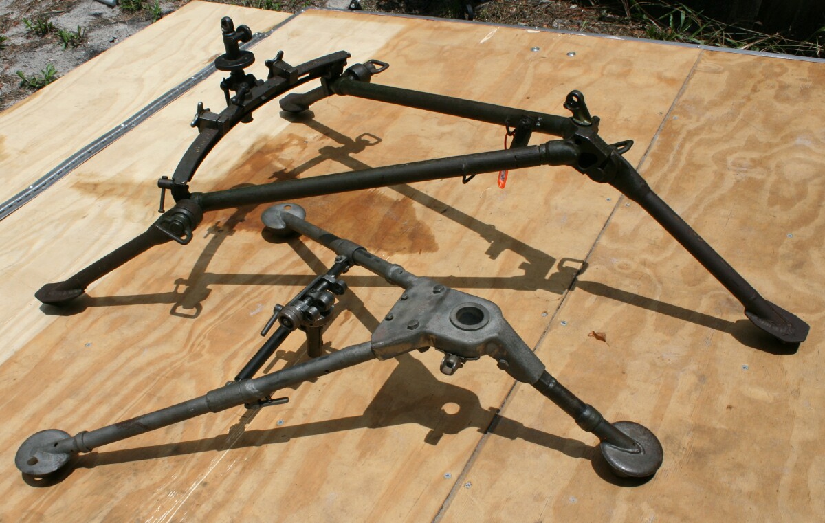

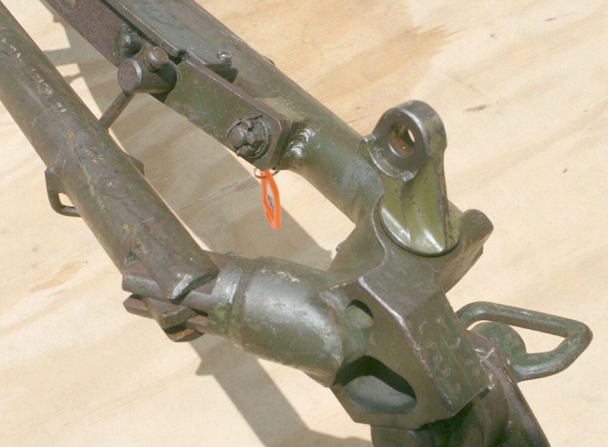

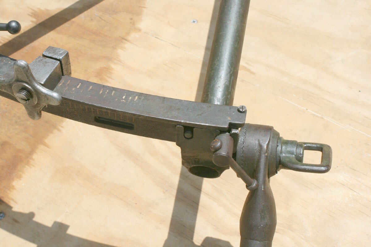

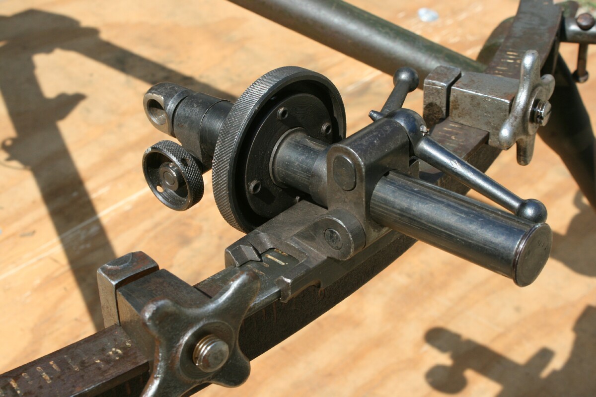

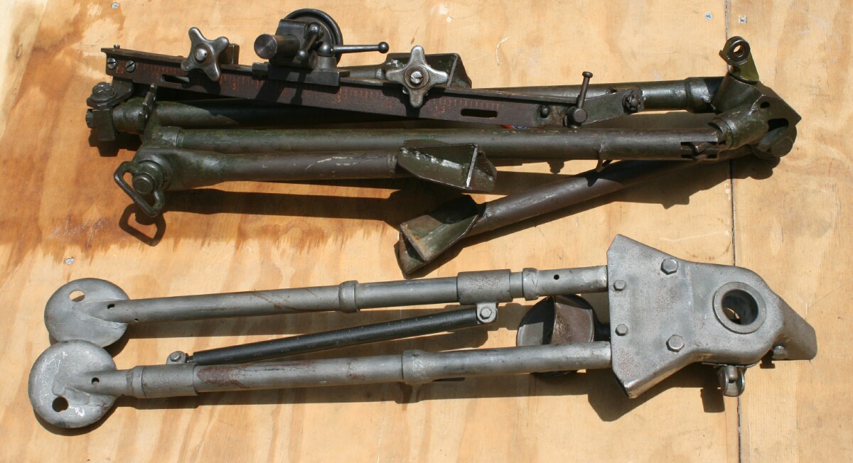

    Next 2 pics are of the Mk2* and M2 30cal tripods next to each other. Setup and folded.
    Next 3 pics are of the "special" areas of the Mk2*.

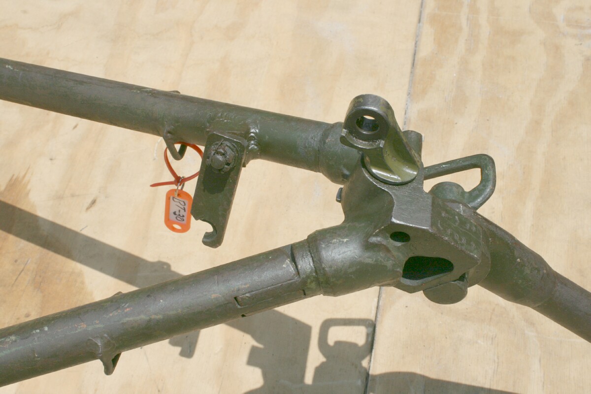

    1st folding area in the right body tube. Also bar that the traverse bar T-handle locks into.

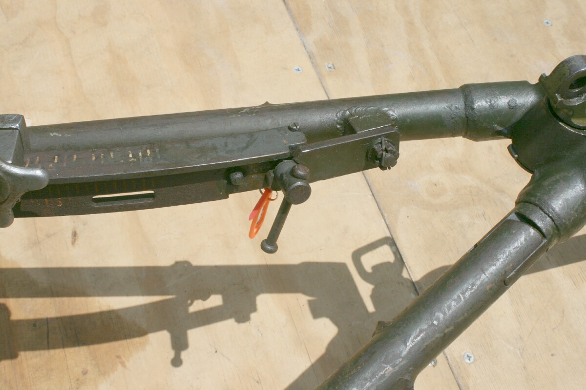

    2nd T- handle lock in area, when open.

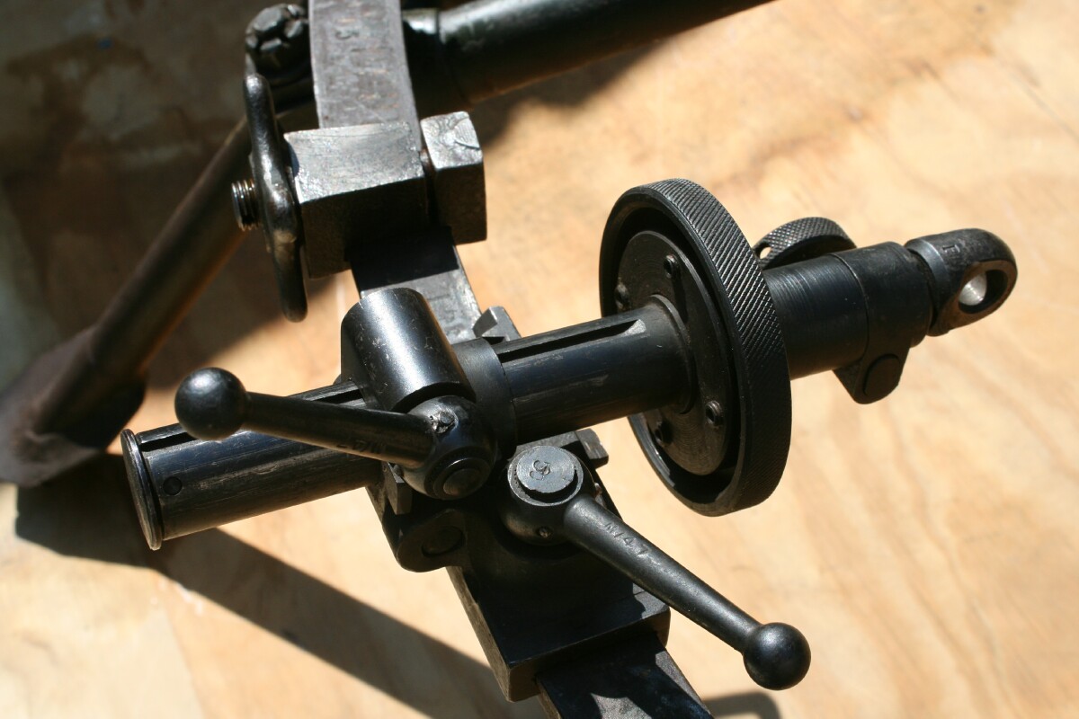

    3rd left hand pivot area for the traverse bar.

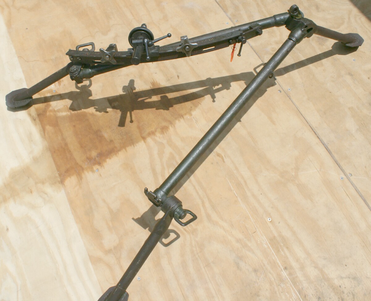

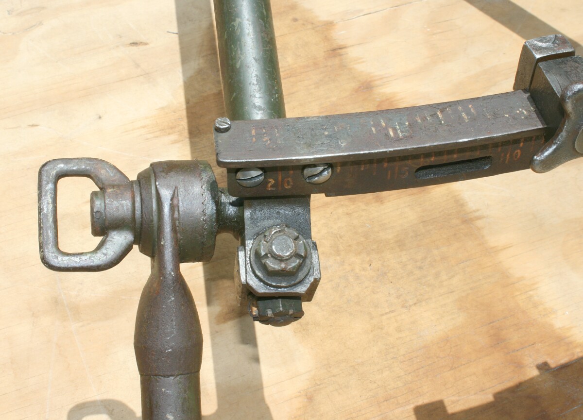

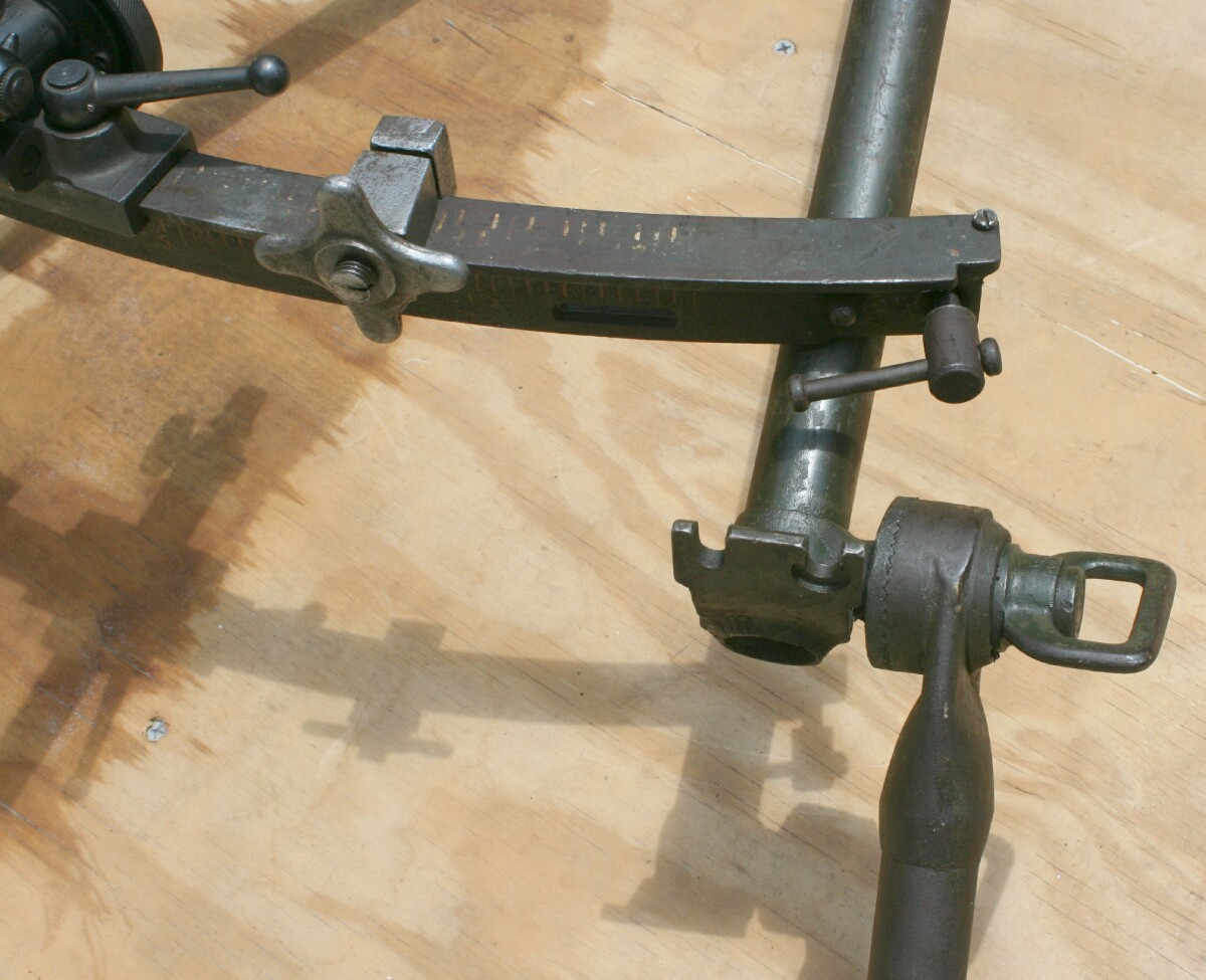

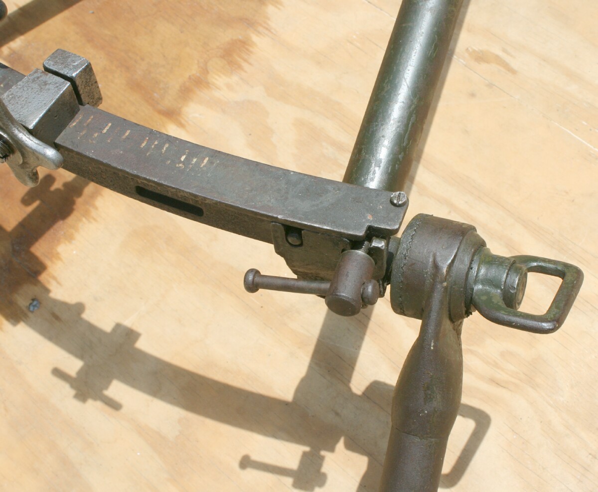

    Next 6 pics were taken showing how the Mg2* is folded up. Note I left the legs open to try to show everything clearer. Then I folded up the legs.
    1st Un-screw the T-handle screw.
    2nd move the traverse bar. Note location pin and T-handle screw in.
    3rd fold the traverse bar in and screw the T-handle to lock it into the small metal bar for the closed position.
    4th over view at this point.

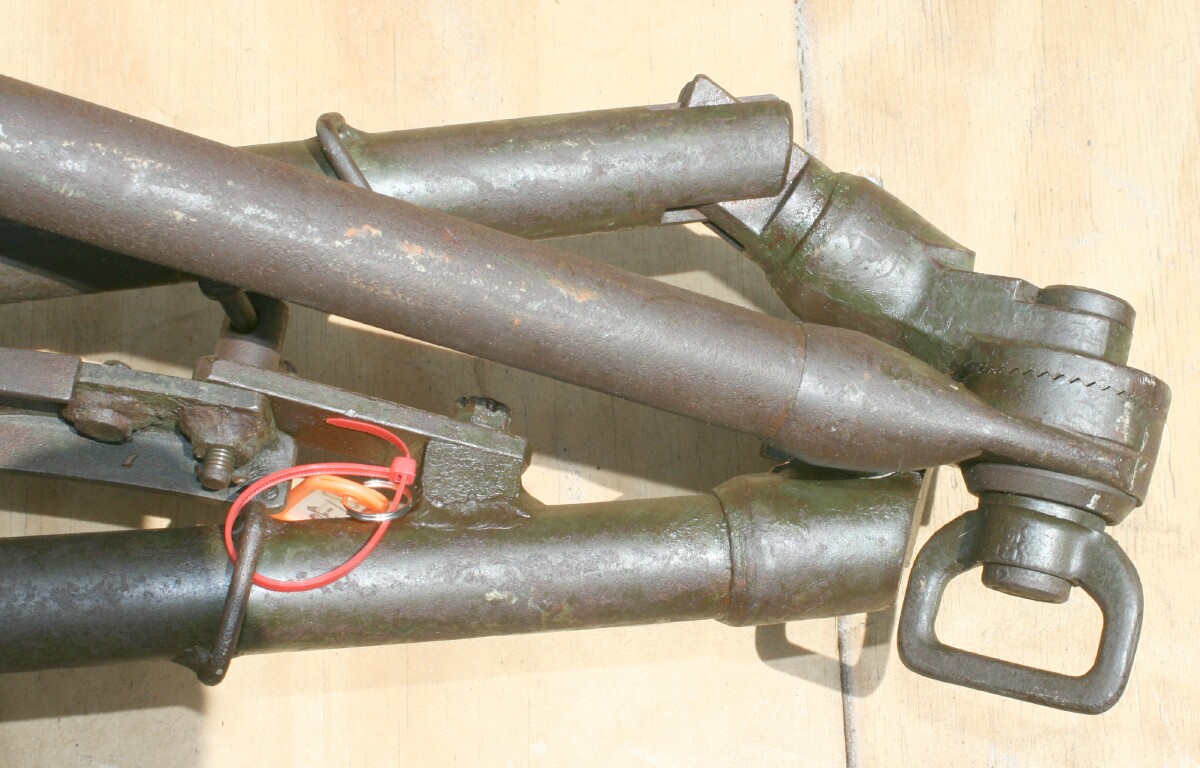

    5th fold the right body tube etc in. Look at the folding joint.
    6th bottom view of the folding area and locking position.
    Now fold the 3 legs into the body and your done.

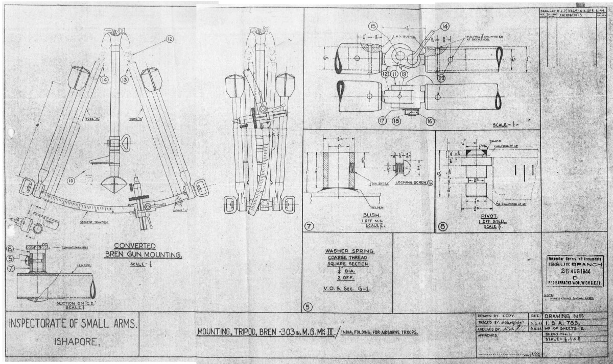

    Blueprints stamped Ishapore India 06/06/1944. Several small production runs around 50 were done and tested by Indian troops. I have not seen reports of large production runs and I have never seen a pic of a Mk3 as of this time. Major difference that I see is that both body legs fold in and there is a locking lever on both folding joints. And other items are different.
