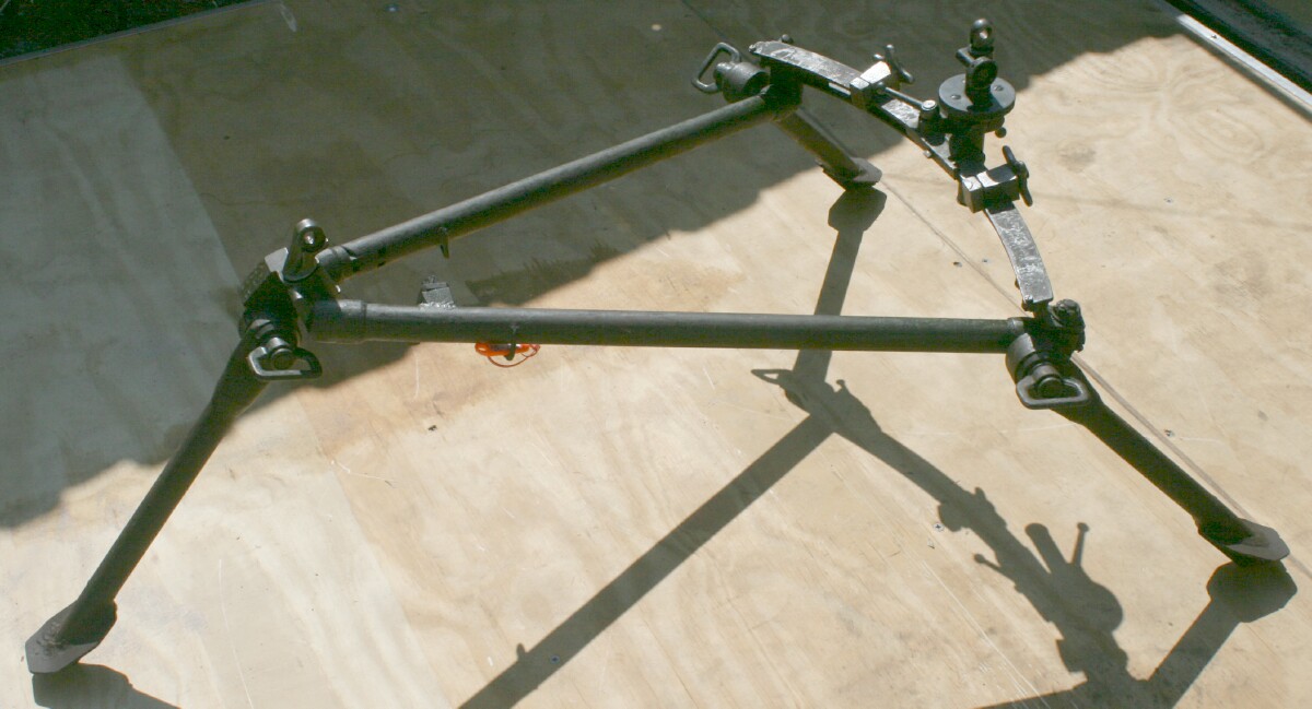

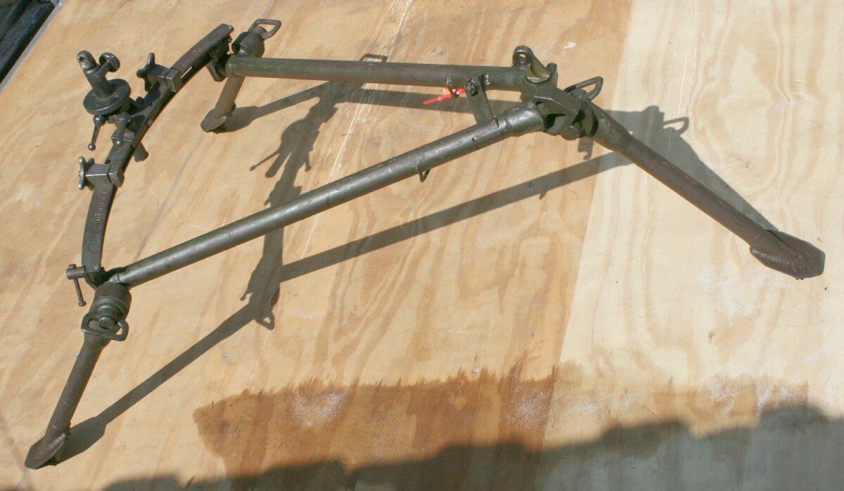

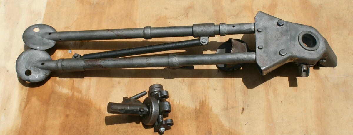

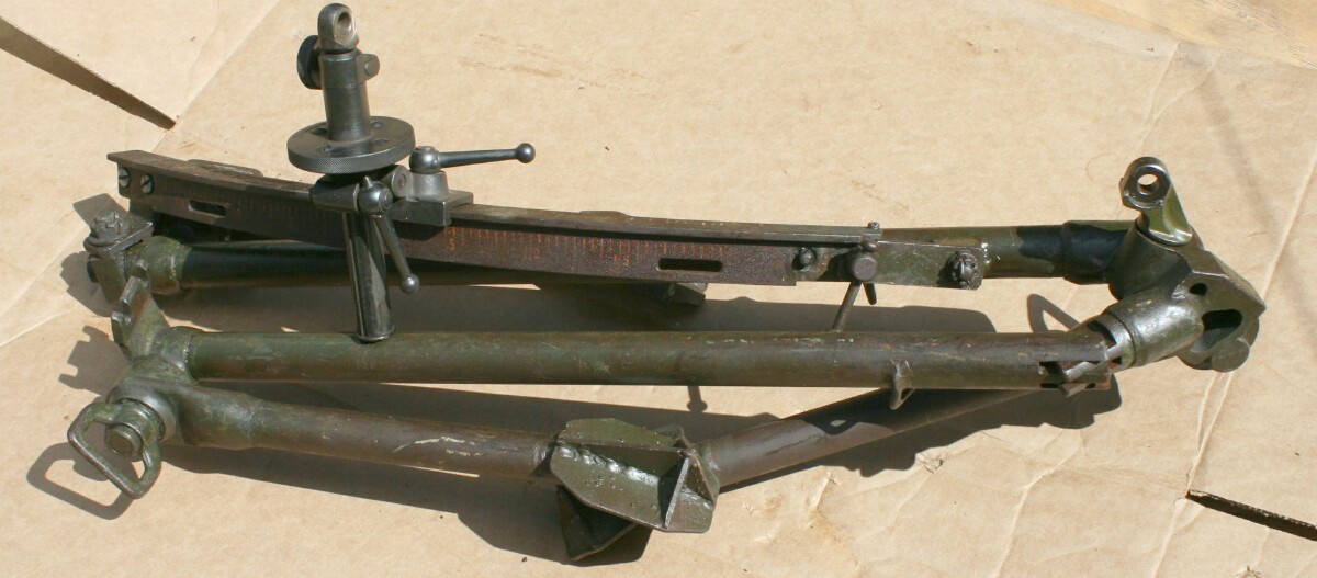

    Here are 4 pics of my L4997 44. The 4th pic is what it looked like after I got it out of the box, 05/2023. Still needs work and the T&E is from CCM and should be from BSA. Otherwise the rest is there, had to dig thru my spare parts boxes and also order in a few parts from my friend Brian at BRP and also Apex. Going to display about 5 different Bren Tripods Mid August, 2023 at a gun show in Fla.
    1st pic show right side. Note the folding joint area on the right body tube.
    2nd pic shows left side. Almost looks like a normal Mk2. Almost.
    3rd pic shows what it looks like folded up. T&E should be folded in. Opps.
    4th pic what Mk2* L4997 looked like when I got it out of the box, 05/2023.

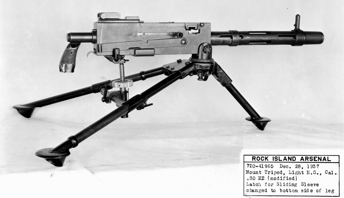

    A few pics of the M2 30cal Tripod.
    1st is a 1937 pic of a 1917 machine gun on a M2 30cal tripod. Slight minor changes as time went by.
    Thanks to Rock Island Arsenal for sharing the pic.

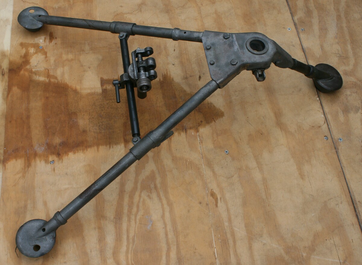

    2 pics of my cut and rewelded M2 30cal tripod. I'm still working on this one. Need to add a lock nut to the traverse bar and clean up and repaint or park.
