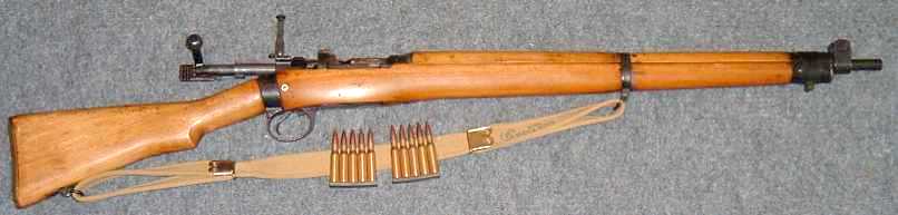

    DCRA .308 enfield conversions.
    Do we need a page on these rifles ??
    I'll take out the camera for some better photos
    http://www.telusplanet.net/public/philqgbr/dcra.html

    Since I took the picture I have found and added the middle sling swivel and a TZ4/47 rear sight.
    And yes there is a huge variation in these rifles, the "military" batch was bilt on Longbranch recievers but the "Club" rifles were as varied as the individuals who owned them. Mine is built on a Savage reciever that was converted to the Mk2 trigger (Mk1/3)
